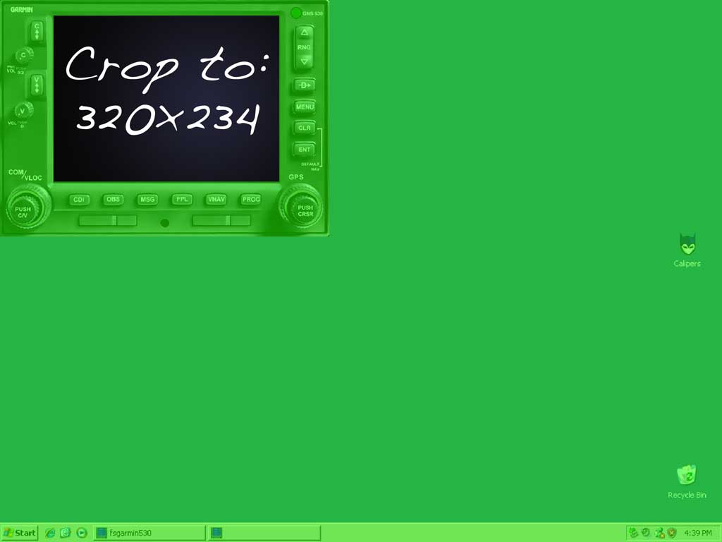

I am currently looking to build a circuit that converts vga signals to composite video; however, I would also like it to crop. All video would be cropped down to 320x234. If possible I would also like buttons to move the cropped area. Where would I start if I wanted to make something like this?
Here is a sample of what I would like it to do:
As you can see, it will be used to display the screen of a gps.
Thanks for any help!

Sure...Currently I'm planning a simulated cockpit to expand my flight simulation software. One of the first things that I want to build is a simulated GNS garmin unit. I have the software to do this and also the ability to interface buttons and rotary dials to the simulator. My question pertains to the lcd screen that will be in the simulated unit. I have found a tft monitor (5") that has the same resolution as the unit...320X234.
Hopefully this helps. A link to the GNS unit: **broken link removed**

I have the reverse problem...I need to display only a small part of the screen on the tft display. I have to see the entire software window (not just the part on the tft) on the laptop I'm using for certain commands. The commands are only accessable by mouse click. Thus, they have to be visible on one of the screens.
