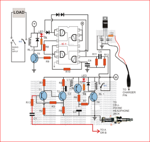

Hi. I want a circuit which can turn on a PC and shutdown it with the signal from a cell phone like giving a missed call.

One circuit I found (https://www.homemade-circuits.com/2012/01/how-to-build-gsm-based-cell-phone.html):
is relatively simple and, best I can tell, uses pretty ordinary parts, with the exception, perhaps, of IC1 (a 4093).
I note your location. What parts are you unable to acquire?
4093 is an incomplete part number. The full number is CD4093. There will be more letters after that that will denote different packages (SMT, DIP) and temperature ratings. But they will all work the same.
It is a common part, but may not be stocked in local stores. You may need to order it online.

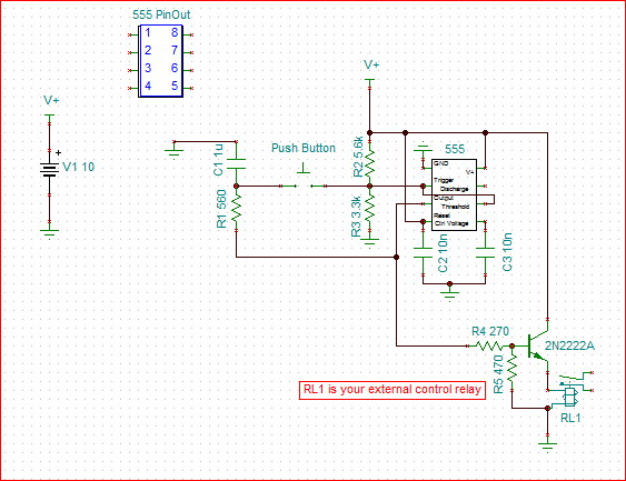

I don't know much about ics.i have done some 555 circuits, and yes 555 is available here. All I want is learn electronics with circuits as much as I can.
So can I use 555 ic, I don't get the input behaviour of the above circuit, so how to implement it 555? Would you modify the circuit with 555?
Below is a working (in SIM) of a 555 latching circuit (it takes advantage of the 555's internal Flip Flop circuit):
I suggest you bread board this to assure yourself that it works.
Pressing and releasing the "Push Button" once will toggle RL1 closed. Doing this again will open RL1.
We'll work on an external trigger after you get this circuit working.
