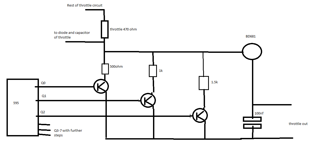

Third has been to integrate a 12v throttle. Now, I've previously done Arduinos and have played with L298s to send out voltage, even DCC. This time around I want a throttle with notches, displayed with LEDs. My thoughts initially were to use the 8 outputs of a 595 to control the resistance into a simple 12v throttle.
I've come unstuck with the collector pin and how to use the digital output of the 595 to control the transistor.
The throttle circuit I've tried to integrate with is: http://www.talkingelectronics.com/projects/ThrottleMkI/Throttle.html
My current circuit looks like: http://modelrail.otenko.com/electronics/shift-registers-for-the-parallel-port-interface
I was hoping if someone could help me bridge the gap. On the base of the transmitter I'm trying to replace the potentiometer wih a resister in series from the 595. I assume I'll also need a transistor in there too?
595 digital out pin would go to the base pin of a lesser transistor which would have specific resistor on either side, being one of the steps-of-eight on my throttle? I don't quite know which transistor to choose for this?
Please see my hideous drawing attached.

Are the eight bits to be used to generate eight throttle steps (not necessarily all equal), or are you trying to make 256 steps (2^8=256, as in a digital to analog converter)?
Can the ground of the (computer) be tied to the negative of the DC power supply that is running the train layout, or do you need some sort of isolation?
What is the full-speed track voltage?
Is it DC?
What is the full-speed locomotive motor current?
How do you ultimately control the track voltage?

Thanks for the response. The N Scale enines use around 1A peak when starting, less when running. Output voltage would be max 12v DC.
I was only hoping for 8 steps. As for equal or not, I was going to experiment with resistance values between 0 and 5k to emulate the potentiometer in the original circuit.
Ground is indeed tied through. Apologies for not drawing that in the crappy diagram.
I tried to research digital to analog converters, but didn't get very far. I need the least amount of work from the controlling CPU as I expect to be busy reading inputs instead of controlling voltage and outputs. But that was regarding having to output a pwm signal. Maybe a digital to analog requirespecially less cycles to keep running.

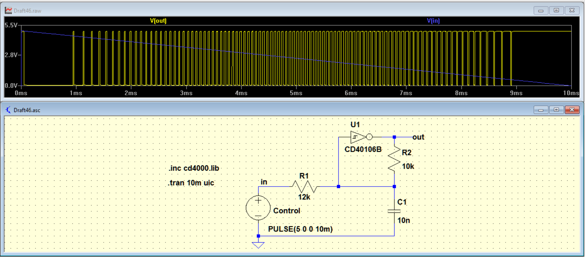

If you want to roll your own, you still have three tasks: 1. build a Digital-to-Analog converter, 2. Build a circuit that converts an analog voltage to fixed frequency Pulse Width Modulation, 3. Drive the tracks (DC brushed motor) with higher voltage/high current to make the train go.
I described how to do #1 and #2 very simply/cheaply in one little board. Your linked method of doing #1 is a Kluge. Here is what it takes to do #2 (notice the parts count). The L298 module is about the worst, most inefficient way of doing #3.

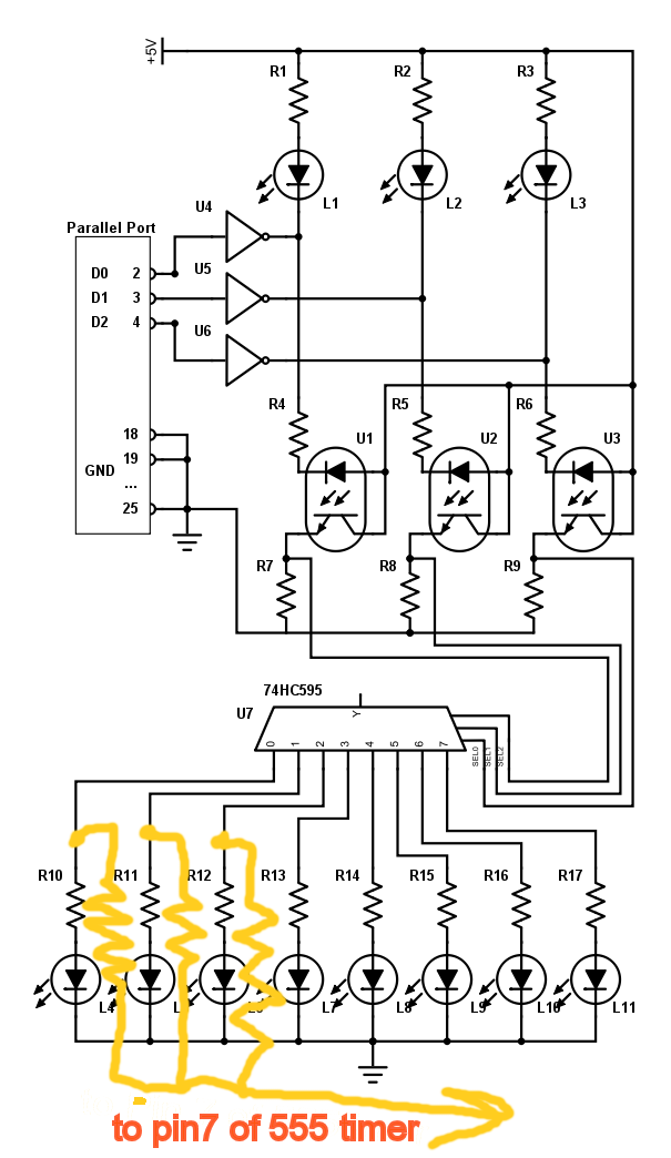

l298 has opamp in it , i may be wrong, but i think that means on or off only, no half voltages, the trick with the pwm is that ya its on at full power , but its only on for fraction of the time , therefore only fraction of that power is converted to motor energy over time
also you want flyback diodes for L298, idk if optic isolation is good replacement, see datasheet for compliment IC's, plus in that circuit the 595 is not protected
if you have the 595 circuit in place already , multiplexing it with a r2r ladder will create 256 combinations, plus your leds will display in binary coded format...

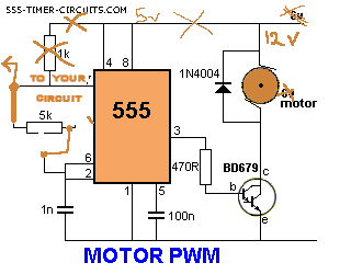

here is another simple pwm circuit:
http://www.555-timer-circuits.com/images/MotorPWM.gif
with that you can tie in resistors in parallel, not r2r, to get 8 options, and tweak each accordingly to desired pulse length,
replace the 1k resistor in "my" circuit with alll the yellow output resistors from 595 in parallel(only drew 3 of them) and dont tie to vcc
you dont really need true pwm, so dont bother with diodes in "my" circuit, at the input side only!
replace the 5k resistor of your choice, this will effect weight of each preceding resistor and overall pulse times...
here is better details & circuit about 555 timers, along with calculator:
http://www.ohmslawcalculator.com/555-astable-calculator
you are mostly interested in duty cycle and frequency vs RC values
