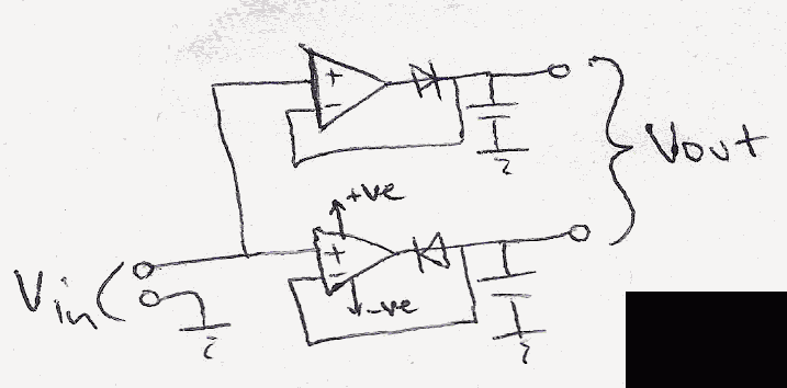

I have a very low frequency (~.5-1Hz) bumbling waveform that has positive as well as negative excursions. I want to measure the highest positive peak, then the lowest negative peak, and add their absolute values to obtain a peak to peak indication. Then I'll need to store that P-P value for at least a few minutes.
There are numerous "bi-polar" peak meters but most of them are simply a precision FW rectifier with a peak holding capacitor hanging off the tail end. These do not measure actual P-P amplitudes, they are voting systems- whichever negative or positive peak is highest "wins".
My thought was to make a negative peak meter and a positive peak meter and subtract their two outputs to get a P-P indication but this seems a tad clumsy.
Any ideas?

You can make a simple adapter to fit between your signal source and a regular voltmeter, e.g.
You didn't mention the voltage range you are measuring; if it is outside the range of the opamp voltage rails (in the above circuit), then you can place a voltage divider on the input. If you're measuring a tiny voltage, you can put gain on the opamps. If it's a large voltage and you don't care about an error of ~1.2V, then you can just use two diodes and two capacitors (no opamps or extra power supply required)
I like dougy's idea, or even just the two diodes and a little calibration if the input voltage is high enough. Schottky diodes might be good there.
If you want a voltage referenced to ground rather than a differential, then use a differential op amp on the end of dougs circuit.

Dougy's circuit as it stands has no way to discharge the output capacitors. If the peak values of the wave decrease, the circuit won't reflect that fact until the voltmeter impedance discharges the caps, which could take a long time if the caps are big and the voltmeter impedance is high.
The plan is to use MOSFETs to disch. the caps. Using the 1N914 leakage spec and a 1uf cap and a non-inverting follower after it, it should hold the peak for a relatively long time (~3 min)

I already purchased the DPM, so I sunk another $1.00 into the project and added a op=amp subtractor.
