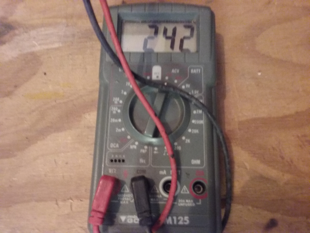

Also I did a test on my electrics as requested. The time was 2:00 am
Okay I said 220 volts AC...but that was at peak time. A good 20 volt drop would I suppose....be expected at peak consumption?

Nige, in all the places I've worked I dont think the mains has ever been 230, like you say 240 is much more common, no matter what the spec is.
I had serious intermittent machine problems ( way back when) in a Shrewsbury hotel, eventually found out the mains was peaking at over 255 vac , I asked where the substation was , "There it is" receptionist pointed to a building just yards from the back door Many of our machines were 'adapted ' from US 115v 60 Hz . but were't happy on 230vac !
It's not 230V, it's 240V in the UK (and 220V in the rest of Europe).
The 'standard' 230V is for equipment specification only - not for the supply voltage. And it includes suitable tolerances to cover the UK 240V and Europes 220V.
I think that nominal single phase supply voltage in Europe is 230V.

Depends what you mean by 'nominal' - the voltage is actually still 220V (and 240V here), no supply changes were made when the equipment specification was changed to 230V.
Although the ideal would have been to have a single voltage there were too many political, financial and technical obstacles to reduce UK voltage to European levels or to increase European voltage to UK levels, so a new standard was created to cover both. This was achieved by changing the tolerances of previously existing supply standards. UK voltage to 240VAC + 6% and - 10% and European to 220VAC +10% and -6% (thereby creating a manageable overlap) and we would call these two combined 230VAC, despite the fact that nobody was intentionally generating at 230VAC!
