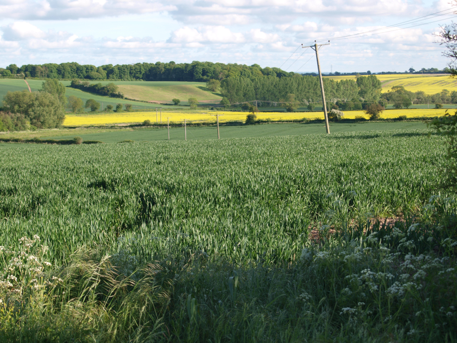

    It happens everywhere nearly. The house was built in 1985 with one acre of land in the middle of nowhere
    This is at the back of our garden
