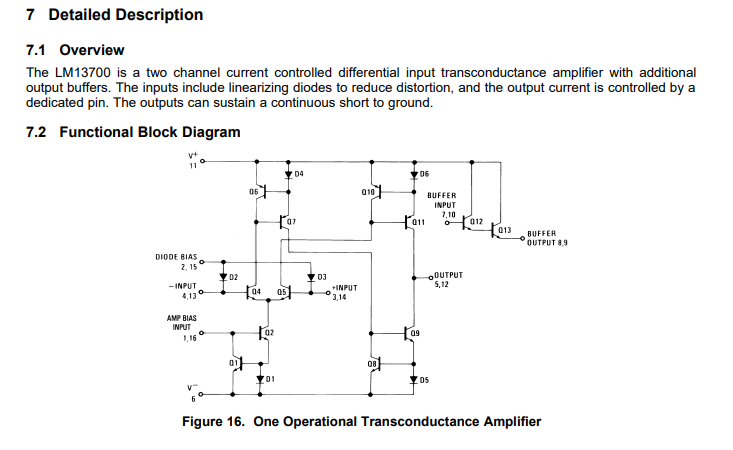

Have you included the buffer amps? The two triangle symbols, one following each OTA?
I'd guess they are supposed to be non-inverting buffers, so input signal to +in and output connected back to -in..
I think those are the darlington transistor pairs of the LM13700.

The OTA output, a current is converted back to V with a resistor.
The schematic shows a buffer, the internal Darlington connected emitter follower
output inside LM13700 used for buffering.
So yes, schematic overall looks OK. Note pin 9 is terminated thru R to -12V, But hard
to read on schematic so would have been easy to connect it to +12 where it
would not function as a emitter follower buffer. I had to mag up the pic and still
was not sure what 12V author was going for.
Regards, Dana.

No its a transconductance amp, V to I. The input diodes are linearizing diodes.
