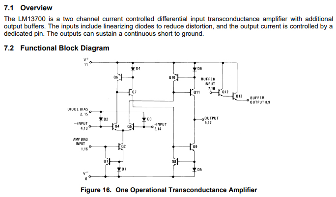

The bias current is supposed to be sourced from 0V; the IC internal bias current circuit operates at about two diode drops from negative supply.

The Q2 and OTA bias input circuits are current control, not voltage, so there should not be much voltage change at the amp control input pin over the control input range.
If it reaches even 1.5V above the negative supply, the IC may already have been damaged, or be faulty.
See the amp bias input circuit, bottom left in the diagram; two base-emitter junctions connect it to negative power. Anything more than 2mA in to that pin can damage or destroy it.

I know the LM13700 is not damaged since there is 20K resistor between Q2 and its amp bias pin and its voltage is always around -11 volts. I can change the connections of pin 1 and pin 16 to see that first VCA also works on other side and faulty one moves to first one. Also the linear mode works just fine on both of them. There is something wrong with Q2 or IC-1C connections. Since I checked Q2 like 20 times I can't say what is the problem with it. Will check it again.
