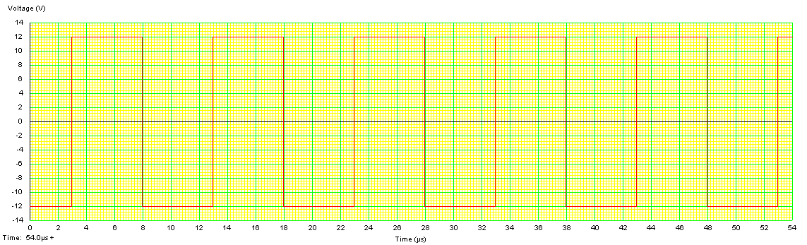

I want the Oscillator to reaches to positive MAX then to zero and then to Negative MIN.
You mean like this?
Same with the sine wave?
How much current do you need?
The trouble is there will be some voltage loss, especially with the sinewave so if you need 12V peak then it might be a good idea to bump up the supply voltage to 15V.

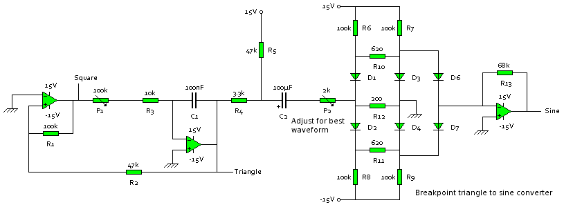

Here's a function generator I was talking about earlier. It gives a sine, triangle and square wave outputs and only needs one resistor to alter the frequency.
You obviously, need to select components which will work at the desired frequency and have another amplifier on the sinewave output to give 12V peak to peak. You could get the whole thing done with one quad op-amp IC.
EDIT:
Another amplifier isn't required except for the square wave, if you're worried about loading. The output voltage can be increased to nearly 12V by increasing the value of R13 to 82k.
R6 to R12 need to have a tolerance of at 1% maximum.
I've tried simulating it and it gives pules.
Simulators can be wrong of course, what values did you use? I guessed.
