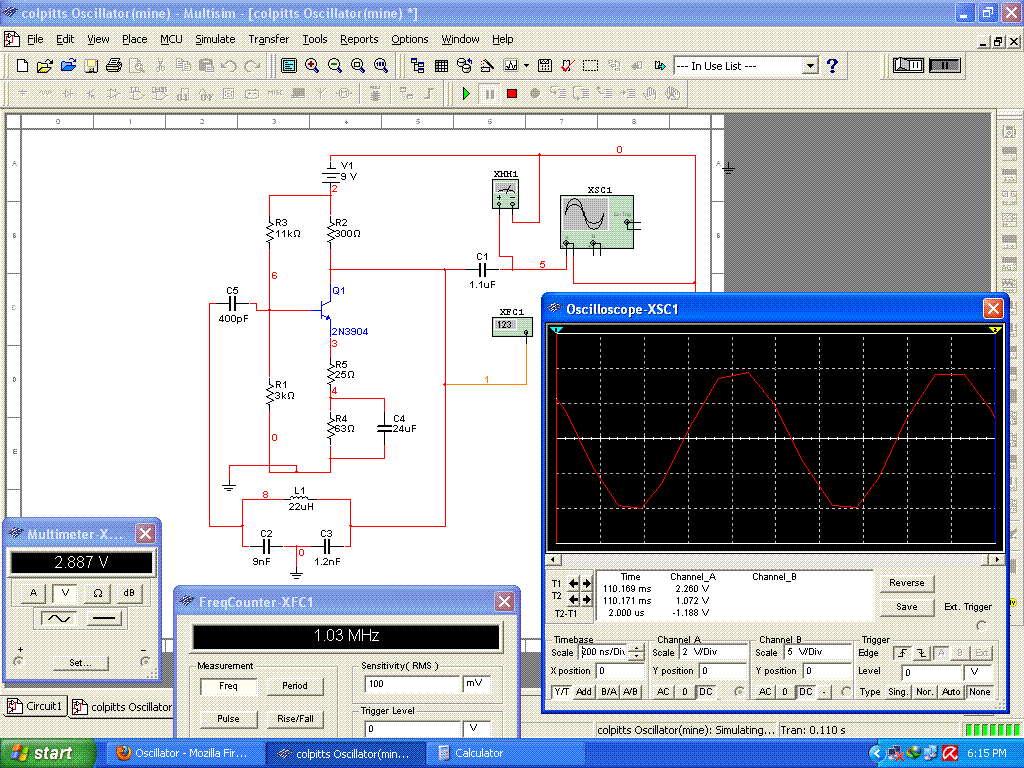

Hey! Guys I have designed my own colpitts Oscillator. please have a look at it. i have 2 Questions that:
1- How can i improve its sine wave? (like it's clipping from the edges).should i decrease the gain of the Amplifier? if change the gain, then condition for Oscillation goes false and whole Oscillation stops.i have tried changing the value of C3. first i increase it and then decrease it but the only effect was on amplitude, the wave as it is shown(no effect on wave).What should i do now.?
2- Is it possible to increase its Amplitude still more?(what i think is that, we cannot increase the amplitude, but I'm just confirming).

1) Reduce the gain. It looks like the number of samples needs increasing on the simulator.
2) No, if anything the gain reeds reducing which will reduce the amplitude. A class C amplifier can be used to increase the ampliude.
Remvoing C4 would reduce the gain and clean things up a little. What is the scale on the scope? The signal should swing pretty close to the rail before flattening out. What are the maximun and minimum swings? I can't tell from the picture.

hey! removing C4, reducing the gain so much causing the oscillation to stop that's why instead o f removing the c4 i increased the value of R5 a bit got somewhat more stable sine wave.
And i have show the scale and every thing in pic.
i am using channel A, which is shown 2V/Div.
Ah! I see the scale now. In that case, it looks like a sampling problem, as Hero suggested. You can get more output by making R1 bigger and R3 smaller. That raises the base voltage of your transistor, and allow for larger swings. Go to far, however, and you'll cause your transistor to go into saturation at the top of the signal, and you don't want that.
