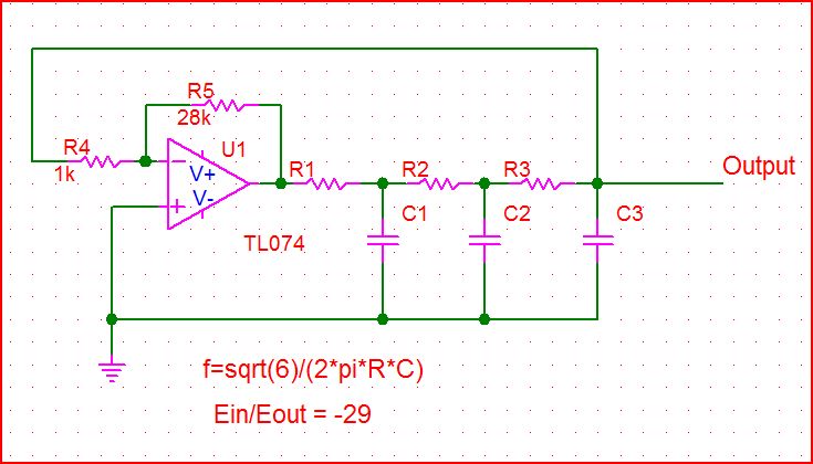

Hi there Ratch,
I think you need to look at your circuit again and go over the equation for the frequency and required gain. I think it is an interesting circuit in addition to the circuit we are looking at so it's worth looking at.
Looking at your result it appears that to calculate the frequency and gain you simply broke the feedback from the output to the resistor R4, which is not the correct way of doing it. That's normally the correct way to do it but only when the output is isolated from the input with respect to current. In other words, if there is input impedance then that must be reflected onto the output before doing any open loop frequency or gain analysis. Another way of looking at it is that it would be correct to simply break the feedback if there happened to be a voltage follower gain stage (gain=1) between the output and R4. Since that is not the case, we must reflect R4 to the output after we break the feedback connection.
After breaking the feedback and adding R4 in parallel to the output terminal, we get an entirely different result for both frequency and gain. For example, with all R's except R5 equal to 10k and all C's equal to 0.1uf, we require that R5=560k which is 56 times higher than R4. In fact, for any R where all four R's except R5 are equal, the required value of R5 is very simple:
R5=56*R4
and again that is when the other R's are also equal to R4.
So take another look and see what you find. Keep in mind that the frequency equation will be different also.

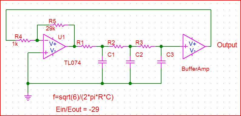

MrAl,
I guess I did not emphasize that the phase shift network should not be loaded. Adding a buffer such as a noninverting unity-gain op amp should take care of that problem. High input impedance, low output impedance is what we want. I also did not mention that there should be some nonlinear control for the op amp amplification regulation. Otherwise, I stand by that circuit as shown below. Anyway, thanks for pointing out that problem.
Ratch
Hi Ratch,
Well it's just that your original circuit was so nice in that it only required the one op amp, and now you're adding another amplifier stage which kinda messes it up a little. All we have to do is add the output resistance and come up with the new formula for frequency, and that new formula is not that much more complicated.
The output can then be taken from the output of the first stage op amp.
It's common to omit the non linearity worries when dealing with pure theory, but we cant omit the loading of the output by the first stage. All we have to do is change the formulas a little and we're good to go with only one op amp.
MrAl,
The frequency formula for one amp is sqrt(2)*(sqrt(R4*(3*R4+2R))/(R4*R*C)). Notice that when R4>>R, then it reduces to the formula given in the schemat. The amplification required for one op amp is (-5*R^2*omega^2*C^2*R4-R^3*omega^2*C^2+3*R+R4)/R4 . As you can see, it is much more complicated to manipulate the components to get what is desired. Besides, running the load and the frequency determining network on just one op amp might not be a good idea.
Ratch
H again Ratch,
I think you have the frequency calculation right for the original circuit now, once simplified a little, however you can see from my diagram that it's not very much more difficult to work with especially if we make R1=R2=R3=R (an assumption all along) and also R4=R. It's just as simple as before just that we now have a slightly more complicated frequency calculation if we dont make R4=R also. With R4=R it's just a different constant in the frequency calculation.
Also, your 'new' circuit requires a resistor value of R5=29k not R5=28k. I think that was just a slight oversight though.
I have included a diagram with all the necessary corrections for both circuits.
As usual we assume that C1=C2=C3=C.
We always have to keep in mind that although these are theoretically sound circuits they need some sort of gain stabilization in the real world.

Hello again,
That's good that you changed the resistor to 29k. There are no nonliniarities in this circuit because it is a theoretical one with an exact gain that keeps the circuit perfectly stable.
Yes, you mentioned that you "dont think it's a good idea to use the first op amp as the output". But it's still a circuit and it's a matter of application or theory in the real world, not a matter of pure opinion. In other words, one circuit is created with one op amp, another circuit is created when there is an additional gain of 1 buffer at the output.
If we were going to collect opinions, then i would offer mine that the 'old' circuit op amp stage requires too much gain, period, and the 'new' circuit still requires too much gain in the op amp stage, period. Instead put some of the gain in the first stage and some of the gain in the last stage, or go back to the original circuit.
I originally mentioned that your original calculation was not correct for the given circuit but was really for a circuit with a non inverting buffer with gain of 1 that isolates the output from the input current wise, but i did not mean we have to use an op amp with gain of 1 just so that we get away with being able to calculate it that way, that was just to illustrate what happens when the input is not reflected to the output (an equivalent network). If you really wish to add that last stage you dont do it just so you can calculate it easier and not just so you also get a buffer for the output stage, you add the stage to the entire design procedure which then means it can fit in to meet other requirements and/or fit without any limitations we might naturally have. That means the gain should be divided up between the two stages now so we can meet the gain requirement and also get a decent output level. So scratch the gain of 1 and go to a gain that makes more sense for the entire design if you must insist on using another op amp.

Hello again,
The point is not if an op amp *can* have a gain of 29, the point is *should* the op amp stage have a gain of 29.
We sure well know that we can set an op amp stage gain to 29 for the purpose of amplification, but with that gain comes the gain bandwidth limitation of GBW/29. Why would we want to do that when we could get away with an op amp stage gain of GBW/5.4 instead. Doesnt make sense.
Redraw the circuit such that the gain of 1 op amp buffer appears at the far left of the drawing instead of the far right. You'll see what happens.
Remember that i told you the main reason i told you about the gain of 1 buffer was because your original equations appeared *as if* there was a gain of 1 buffer in between the output and input. I didnt really mean that you should do that. Also think about what op amp output requirements it takes to get a 1vrms output with a passive network that attenuates by 1/29. If you want to address any practical issues then why just address one and not as many as you can think of.
After we look at it redrawn that way we'll find that it is still not as practical as another topology that uses similar components.

Hi Ratch,
This gets interesting when we consider the practical aspects of the circuit.
It seems you want to use the gain of 29 amp to saturate in both directions, and use that as a gain limiter. That might not be a bad idea in theory, but we'd also have to look into the recovery time of the op amp to make sure it can recover in a reasonable time as not all op amps can do that very well and that would severely limit the upper frequency limit of the circuit. But let's assume that it can for now.
Then it's not too bad of an idea to use the op amp as a limiter as well as the gain stage. It will work as a limiter by pinning the output in either direction and that of course limits the gain. But that is true of any gain the op amp stage might have. It does not take a gain of 29 or any other constant gain to force the output to saturate in either direction, it takes a combination of gain plus the input level has to be high enough to force the output stage all the way up (or down) to one of the rails. Thus a gain of around 5.4 in both stages would still saturate the output and we'd still get the limiting action in the second stage.
We'd then also get a more useful output, although it might not be good enough anyway. For example, for a 1vrms output signal out of the gain of 1 stage we'd have to have the second stage output around 40 volts peak (80 volts peak to peak). Still with the dual gain of 5.4 setup the output of the second stage being plus and minus around 12v (saturated) the output of the first stage gain amp (5.4 gain) would be around 1.6 volts rms. That might be useful. To get a higher more useful output voltage we might change the gains to higher for the first and lower for the second, but then we're back to the unbalanced GBW utilization issue of the op amps.
Im sure you already know some of this stuff i've just included more things that seem pertinent to the design for completeness.
We still have other things to consider though that will have an impact.
