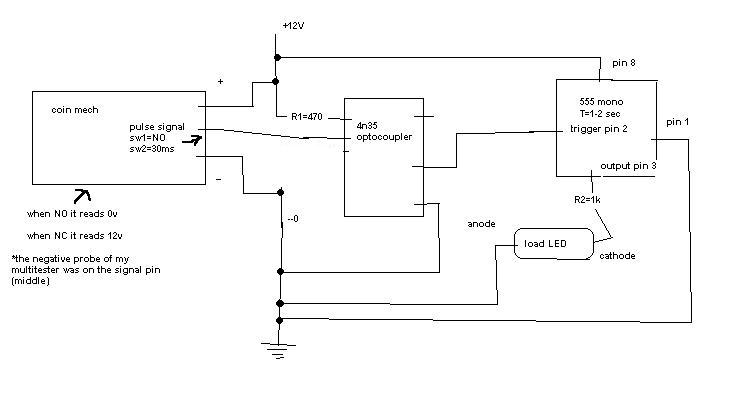

hello guys it's me again and more 20-questions forgive me.
dear eric, i realised that the signal coming from the mech was not positive, instead negative, sorry about the confusion, this thing is really way over my head obviously but i'll keep trying. i failed miserably to make your resistor-divider solution work, i'll keep the code tho thank you.
i made a drawing, hope it'd answer few questions to be asked or had already been asked about what i'm trying to accomplish here.
the LED will be replaced by a PIC with RBO waiting for the pin to go high.

maybe 30ms pulse is very fast, it happens so quick that the optocoupler does not have enough time to saturate the transistor, i don't know.
i found this 6N139, High Speed Optocoupler, 100 kBd, Low Input Current, Photodiode Darlington Output, you think it will help, trigger the 555?
i tried connecting the signal wire directly to RBO with pull up resistor as to what kpatz and eric had taught me in recent posts, but to no avail.
whats next? i seem like i have ran into some wall lol

attached pic above is wrong heres the right one
Looking at your circuit the 0V lines of the coin mech and the rest of the circuit are on a common 0V and the fact the coin mech switch is powered from only +12V, where is the negative pulse coming from.??
I think you are misunderstanding coin switch mech output.
If it goes from +12V to 0V, its not a negative pulse, its a low going pulse which can be connected to the PIC PORTB.0 using the resistor divider discussed earlier.
The opto and 555 are not required if the coin switch is switching the +12V high or low [n/c or n/o]
Please measure the actual pulse levels from the coin switch and tell me what you find.:)
BTW: a 30mSec pulse is not fast.

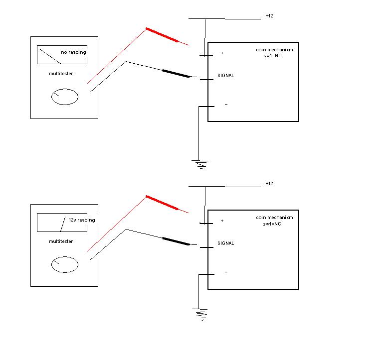

the color red line sir is the wire where the pulse was sent.
why i know it should be connected to the cathode part of the opto, because when i measured the coin mech for voltage, it read no volt if positive probe of my multitester was used with it, but when negative probe was i will get a reading of 12v provided sw1 was NC, but when sw1 was set to NO however i get zero volt reading. this is whats going on when the coin mech was plugged but coins were not inserted yet.
i don't know if the pulse was rising edge or falling edge. if this helps, i can see my LED blink once and very fast after coin was inserted and when sw1 was NC (LED was lit already since there's 12v), using the opto and 555 circuit. when sw1 was NO (LED was off state and signal wire was 0v), no blinking going on after coin was inserted, again with the opto and 555 approach. I guess this says the pulse here was falling edge? and i should use BCF rather than BSF in my code? or this is something else?
how about i will eliminate the 555 circuit but leave the opto to send positive voltage to the resistor divider using NC? and change the code from rising edge to falling edge instead?
about directly wiring the signal wire to the RB0 with matching resistor divider, the signal wire is negative? is this still plausible since i gave wrong info earlier about the polarity of the signal wire.

i also noticed that the pulse was going downwards e.g. when 12v N/C, the multitester needle moved toward zero volts. when N/O, the needle did not move.
hi wejos,
Like we said its a low going pulse,[not negative] switching from +12V to 0V for about 30mSec.
Use the 3.3K and 2.2K resistor divider as before, connect the junction of the divider to PORTB.0 and set the program to Interrupt on a low going edge.
Thats all you need do..
No opto's or 555, the PIC will easily interrupt on a 30mS pulse..:)

Your code detects the PORTB.0 interrupt OK.
Make sure you select PORTB.0 falling [low going] edge.
guys eric, its working now thank you appreciate all your help
i found out my breadboard was causing all the problems, the holes are not any more virgin lol, the wires become lost in space lol
