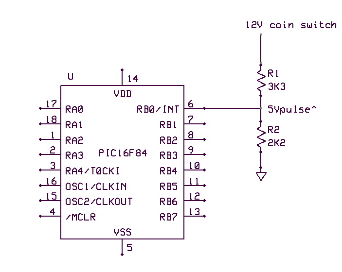

Looking at the application, why dont you use the PORTB.0 interrupt pin to detect the 'fast' pulse from the opto output, that way you dont need a 555 mono.
Looking at the opto isolator, unless you need isolation from the coin machine, you could just use a resistor potential divider from the 12V coin signal and connect the +5V output of the divider to pin PORTB.0.??
EDIT: something like this circuit.

Look at my previous post, thats the way I would do it, keeps the component count to a minimum [ and the cost].
Connect the 0V of the coin machine and PIC togther, power them from their own supplies of 12V and 5V. Have some decoupling caps on the PIC's +5V , say 47uF and 100nF and it should work ok.
If you are not sure about the coin machine decoupling add say 100uF and 100nF across its 12V supply.

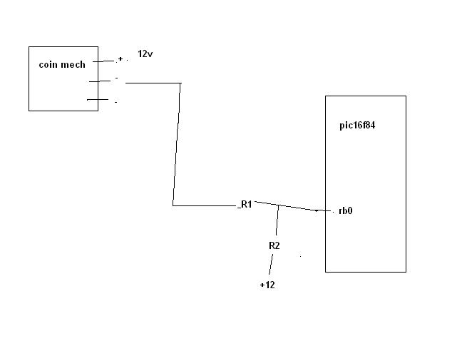

will this work?
i forgot the signal pin of the coin mech is 0v when NO and +12 when NC

will this work?
I dont think so.:)
What you are saying its not a negative pulse, which makes things easier.
Use the +12V signal to the R1/R2 divider as I posted in the drawing.
The program can be set to detect either a low or high going edge on the PORTB.0.
OK.?
Do you have any diagrams of the coin circuits.?
