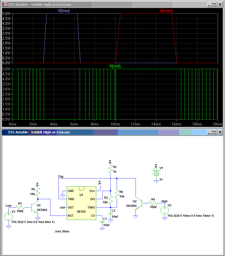

Three states requires two inputs for static signals, but you could encode 3 detected states into a single input using some sort of digital encoding. For example a 1 could be positive voltage, a 0 could be a negative voltage, and an alternating square-wave or pulses could be zero voltage. But, of course, that would require some logic and an oscillator at the source end to generate the three signals. It could be done with a 555 timer and a couple of transistors along with a few resistors and capacitors. (See simulation below. There is a Low input to keep the 555 output low and High input to keep the 555 output high. No inputs allows the 555 to oscillate. V2 and V3 are for simulation only and represent the input signals from your detection circuit.)

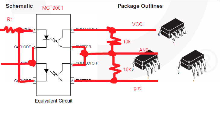

Actually, as I mentioned, just outputting levels for the A/D would accomplish the three states easily. Since I have a no-cost A/D on the input pin to the PIC, that's not an issue. I don't want to add another chip, since I already need total isolation, and I can do that with a two channel opto-coupler. A simple resistor divider on one of the output transistors gives me one direction, pulling the input low with the other one gives me the other direction, and when both opto transistors are open, the input is pulled up to 5V, indicating the motor is not running.
I'm just trying to see if that's the best solution here. Best is the lowest component count in this case. :)
Dual opto and some resistors.
Output will be 1/2 supply with no input voltage.
Output will be near gnd or near supply.
You might need a capacitor to remove noise. AN0 to gnd.
Ron, I like your "no frills" schematic!
Certainly if you have a spare ADC available in the PIC then a 3 level output, such as generated by Ron's circuit, would likely be the simplest way to generate the three signals.
Thanks folks, I guess my original inclination was as good as it's going to get. I like Ron's circuit, he used one less resistor than I had in mind. :)
