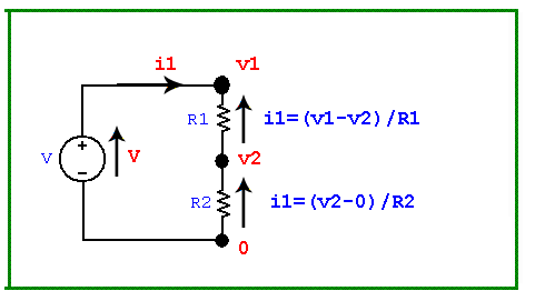

Hi again,
Oh yes that's very good. I see you got the arrows correct for the voltage source, which looks opposite to the resistor arrows. That's a good way to think of it.
Next all we want to do is label each node so we can start writing equations. I'll assume you can do this because im sure you can, so we'll start with the top node and work our way down. Before we do that though, it helps to identify a common node which we can call zero volts. This is usually known as 'ground'. The negative side of the source looks good, so we'll call that 0. That makes the lowest node (dot) become the zero (0) node.
Ok back to the top, we'll all that upper most node v1, and the center node v2. We also label the current (the arrow inside the wire) as i1.
Thus so far we have voltage nodes v1, v2, and 0, and we have current i1.
Next all we do is use Ohm's Law for each voltage arrow. When we 'know' the voltage at each side of a resistor we know the voltage difference and since we 'know' the current is i1 we can write equations that relate all of this together.
The arrow to the left is obviously equal to V so that's labeled V, but for the other two arrows we equate the current though the element to the voltage across the element.
Using Ohm's Law I=V/R we get different equations for each resistor as shown in the first attachment.
Does this make sense so far?

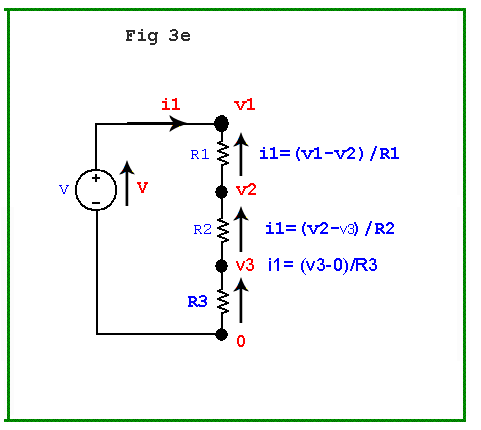

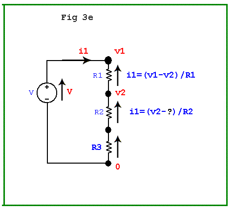

If it does, take a look at fig 3e in the second attachment. As you can see, i've added a resistor R3. This brought in a new node too.
What you should do now is take that drawing and label the new node in the same way the other nodes are labeled, then write the equation for that voltage arrow in the same way the others are done.
The voltage arrow equation is written by dividing the voltage difference across the resistor by it's resistance and since that equals the current fllowing through it we simply equate that to the assumed current i1.
Notice you'll also have to fix the second equation because that other voltage changed (it's no longer 0).

I think I understood what you wrote ;-). I modified the image, I hope it's correct.
Hello again,
Oh yes, very good. You seem to be catching on quick.

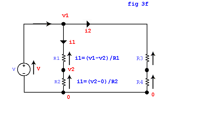

Now we jump back to the 2 resistor circuit, but now i've added two more resistors in the circuit, R3 and R4. This introduces another node so we have to label that, plus the connection is in parallel to the other two resistors so the current now splits into two currents which we are calling i1 and i2.
Can you figure out how to label the new node and the two new voltage arrows?
(Note that the second 'ground' 0v node is not really a new node, it's drawn for reference. The two nodes form was is sometimes called a "super node" but it's no big deal really, we didnt have to draw that node over again to the right).

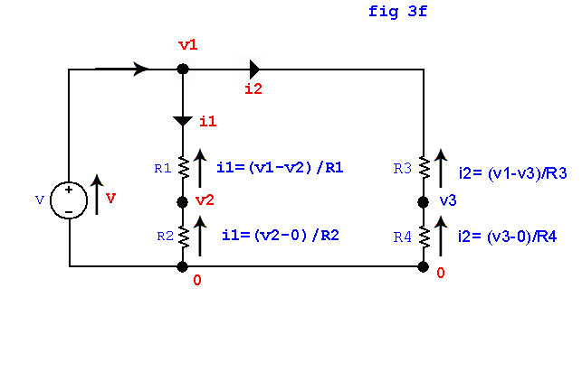

Ok, I tried to do what you asked. Is it correct what I wrote?

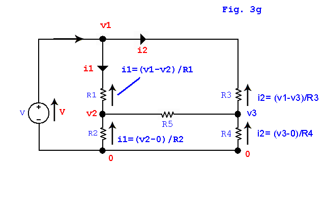

Hi again,
Oh yes, that's right, very good really. Now one more and then we take off :) What we are doing here is basic to all the circuits we will do so it's good to get this out of the way.
This next one might seem a little stranger but all we have to remember is that when the current flows into one end of a passive element (resisitor) it induces a voltage that is most positive at that end of the element. There are two ways to show this though when we dont know the polarity of the voltages yet. Thus we assume on direction and then that shows us the way to draw the voltage arrow too. So we assume a current direction (and draw the current arrow), then draw the voltage arrow, then write the equation (as we have done with the other resistors already) noting which voltage is at the head of the arrow and which is at the tail of the arrow. Put another way, sometimes we will have two choices for the current arrow and in that case we simply pick one and go with that. We just keep in mind that once we decide which way we will indicate the current flow, the voltage arrow (polarity) must follow suite.
So given the above do you want to try this next one? If you have any problem with this one that's ok because once you see how this is done you'll then know how this is done for any circuit. After this we will be ready to write the equations for the entire circuit and then of course we can solve the circuit.
(One little note, i moved one of the equations up a little to make room for the new equation so i drew a line from that equation to it's associated voltage arrow as you can see in the diagram).

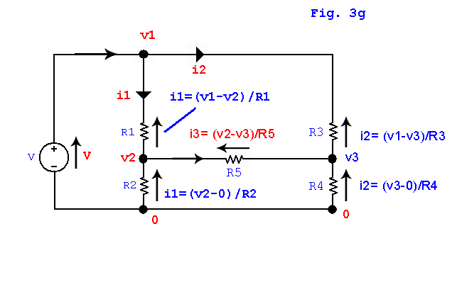

Hello again,
Oh yes, that's absolutely correct. The new resistor introduces a new current and a new voltage so another equation too. You got that perfect.
What *i* neglected to do however was to indicate that when i added another resistor that the two currents in R2 and R4 had to be labeled as new currents too. Not too much of a problem however, as i simply took your new diagram and corrected my own error by labeling the two resistors R2 and R4 with the new currents i4 and i5. You see how the current splits with the new resistor? That means we have different currents through those two resistors now. No big deal though, as i have attached the new diagram which includes your recent work with the new resistor R5.
Ok, now it's time to write the equations for the circuit. Up till now we've written equations for each circuit element. Now it's time to combine all those results.
First we compile a list of all the equations we already wrote for each element. We get this list:
i1=(v1-v2)/R1
i2=(v1-v3)/R3
i3=(v2-v3)/R5
i4=(v2-0)/R2
i5=(v3-0)/R4
Note that this is just the list of what we already found for each element, and some of these may simplify immediately (such as i5=v3/R4).
Next we need to write equations for each node (nodal analysis), and to accomplish this we use KCL (Kirchhoff's Current Law) which states that the algebraic sum of currents entering a node equals the sum of currents leaving a node. What this means in simple terms is that if we have a current entering a node of say 1 amp, then we have to have one or more currents that are leaving the node who's sum totals 1 amp too. Alternately, if we have two currents entering the node that sum to 1 amp then we have to have at least one node that has 1 amp leaving. There are many possibilities here, but all we have to do is simply add all the currents entering the node and subtract all of the currents leaving the node and equate that to zero. We do this for all of the nodes we dont yet know the voltage of.
(see new diagram)
Starting with the node labeled v1, we really already know that this node equals the source voltage, so we dont have to equate that one. We do have to do v2 and v3, so lets do that now.
Starting at node v2, there are three currents associated with that node, i1, i3, and i4. The current arrow for i1 points toward the node, so we add i1. The current arrow for i3 points away from the node, so we subtract i3. The current arrow for i4 also points away from the node, so we subtract i4 also. We equate these currents to zero like this:
+i1-i3-i4=0
and as you can see the ones we added got plus signs and the ones we subtracted got negative signs, and they all were equated to zero.
What you see here is the magic of nodal analysis. By simply equating the node currents like this we can solve the circuit.
We still have another node to do, the node v3. We do that one the same way. Since i2 points toward the node and i3 points toward the node and i5 points away from the node we end up with:
+i2+i3-i5=0
Now we are done with most of the work. Everything else is just substitution and then we solve the system of equations to get the answers.
The two simultaneous equations look like this so far:
i1-i3-i4=0
i2+i3-i5=0
but to solve them we need to do a few substitutions. We have to go back to our list of element equations and replace every instance of every current with it's element equation.

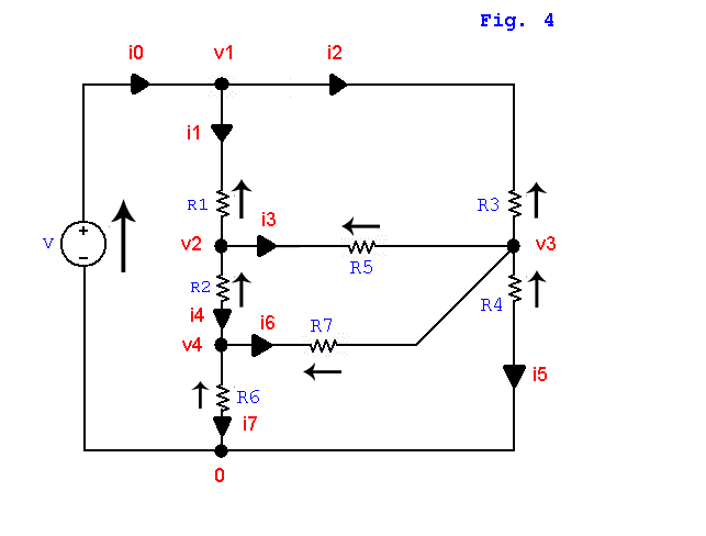

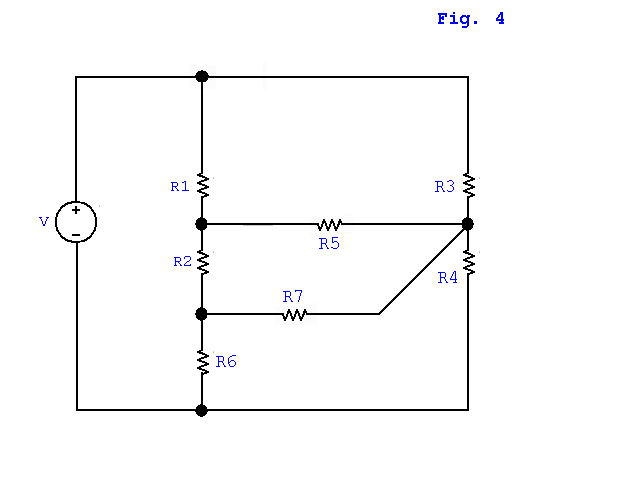

Ok, we now move to another circuit which is just slightly more complicated. In the new diagram i have added two more resistors, so the current splits again at the two nodes it is connected to.
We are given the voltage source voltage and the value of all the resistors again. The voltage will again be 2v and the resistors will again have values the same as their enumerations (R1=1 ohm, R2=2 ohms, R3=3 ohms, etc., as before). You are asked to solve for the unknown node voltages.

I solved the last proposed exercise. The nodes have been already marked by you. I drew the current and voltage arrows as I did in the previous exercise. Then I labelled the nodes and the arrows. After that I wrote the current equations, then I wrote the equations at the nodes. I solved the system of three equations in three variables. Then I calculated the currents flowing through all the components. At the end I verified my results with SPICE.
Equations at the nodes:
i1 = (v1-v2)/R1
i2 = (v1-v3)/R3
i3 = (v2-v3)/R5
i4 = (v2-v4)/R2
i5 = (v3- 0)/R4
i6 = (v4-v3)/R7
i7 = (v4- 0)/R6
System:
+i1-i3-i4 = 0
+i2+i3+i6-i5 = 0
+i4-i6-i7 = 0
System with substitutions:
+(v1-v2)/R1-(v2-v3)/R5-(v2-v4)/R2 = 0
+(v1-v3)/R3+(v2-v3)/R5+(v4-v3)/R7-(v3- 0)/R4 = 0
+(v2-v4)/R2-(v4-v3)/R7-(v4- 0)/R6 = 0
System results:
v2 = 1.7039V
v3 = 1.2850V
v4 = 1.2792V
Currents flowing through the components:
i1 = 0.2961A
i2 = 0.2383A
i3 = 0.0838A
i4 = 0.2123A
i5 = 0.3212A
i6 = -0.0008A
i7 = 0.2132A
Now, look at i6 current. It is negative. However I think that it has to be positive. I verified with SPICE and the correct value seems to be 837,696 uA (micro Ampere) ... a positive value. The equation for i6 current is:
i6 = (v4-v3)/R7
so, substituting the correct values, I have:
i6 = (1.2792 - 1.2850)/7 = -0.0008A
that is a negative current. Could you explain me where is the error? Is this current so small that has not to be considered? I was thinking: if I round off my voltage values to 2 decimal places, I find that there is no current flowing through R7.

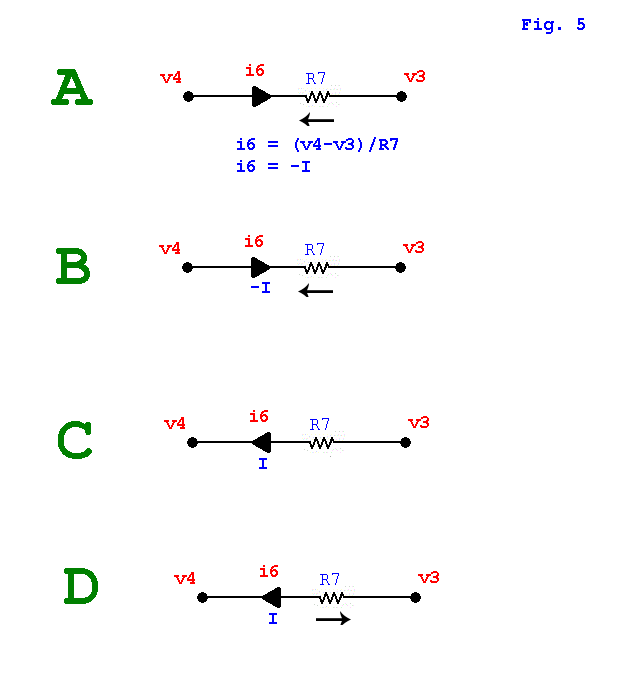

Hello again,
Oh yes, very good! You've gotten all the right results and you see you verified this yourself so you have a way to check your answers when you do a circuit. And about i6 being negative and small, that is something we should talk about.
If you look at this next diagram (Fig. 5) you'll see that [A] shows the current i6, and that it worked to to be a negative current equal to -I. In , i've labeled it as a negative current as you can see, and that would mean the voltage arrow would be indicating a negative voltage. In [C], i turned the current arrow around so it now points to the left, and that allows us to change the polarity of the current I to positive. Since the current is now positive that means we should turn the arrow around if we want it to indicate a positive voltage (as shown in [D] ).
So you see our original assumed direction for the current was wrong so the current came out negative, and since the current arrow shows direction that means that we have the following equivalency:
"A positive current flowing in the positive direction is the same as a negative current flowing in the negative direction".
Remember that the arrow shows direction and the polarity of the current can be plus or minus, but it can all be shown as positive current in the positive direction. When we do end up with a negative current like this all we have to do is flip the arrow and change the polarity and then flip the voltage arrow too. This then also means that a negative current flowing in the positive direction creates a negative voltage drop across a resistor, but we can always adjust to our liking.

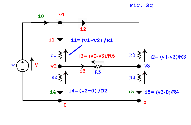

Back to figure 3g, where we have the 5 resistors in the circuit and one voltage source...
When we talk about the 'total' current from the source we talk not about the sum of all the currents, but only that current flowing through the source itself. If you look at the top node of the circuit you will see three currents associated with that node. We have i0 from the source, and i1 and i2 flowing through resistors. Since i0 is entering the node and i1 and i2 are leaving the node we end up with:
i0-i1-i2=0
and if we rearrange that just a bit we get:
i0=i1+i2
Thus, the i0 current is equal to simply the sum of i1 and i2. When we solve the circuit we can solve for i1 and i2 and then we can simply add them and get the value of i0. This would be called the total current, but i should have told you that this is really i0 as the phrase "total current" can be misleading.
Ok, so with that in mind, you should next calculate i0 for that five resistor circuit, and also i0 for the new seven resistor circuit. This current is often of great importance because we often have to know the power that the source is delivering to the circuit. This brings us to the subject of power while we are at it...
Knowing this current i0 for both circuits and the source voltage (as given as 2v for both) can you calculate the power that the source delivers to all the resistors for each circuit?

For the five resistors circuit the total current is (keeping in mind i1=(v1-v2)/R1 and i2=(v1-v3)/R3):
i0 = i1+i2 = 0.68A + 0.27A = 0.95A (SPICE tells me that this current should be negative ... Do I have to change any polarity?)

Hello again,
Yes that is very good indeed. That's both currents accurate enough for many purposes. I think you have grasped the equation writing very very well so you wont find it very difficult to do the more complicated circuits we will look at because we just follow those basic rules.
Yes, some spice will show a negative current because the software assumes electron current flow, which is the flow of electrons from the negative battery terminal, though the circuit, and back to the positive terminal of the battery.
We are using conventional current flow which is from the positive battery terminal through the circuit and back to the negative terminal.
If we draw a current arrow pointing to the right we draw the voltage arrow pointing to the left. If the current is positive then the voltage arrow indicates a positive voltage. Without changing the current arrow if we still draw it pointing to the right but it is a negative current, then the voltage arrow indicates a negative voltage. So the voltage arrow always takes on the polarity of the current.
Because of this it is sometimes best to flip the voltage arrow if you flip the current arrow and that keeps everything the same. For the negative current pointing to the right we end up with the negative voltage pointing to the left, but when we flip the current arrow the current is then positive, so we flip the voltage arrow too so it keeps the same polarity as that of the current.
