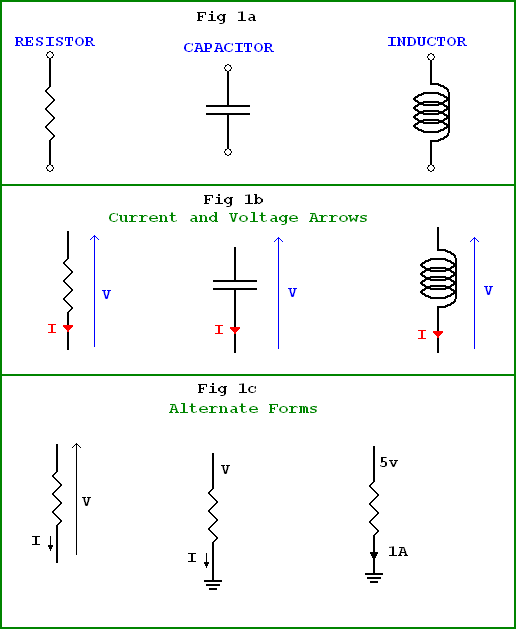

Ok so nodal analysis is up next. I'll get a pic or two up here later (possibly tomorrow morning though) with some circuits we can look at.
In the mean time you can take a look at this pic. You can ignore the inductor for now if you wish.
Note how the voltage and current arrows are drawn. The voltage arrows are drawn ACROSS the element, while the current arrows are drawn showing the direction of conventional current flow THROUGH the element. Also notice that when the current flows in the direction shown the voltage appears across the element as shown by the arrow, with the arrow head being positive and the arrow tail being negative.
Does this make sense to you?

Yes, I can understand the picture you kindly posted. The current flows from a "zone" with more potential to a "zone" with less potential.

Yes you may find it easier to label the components of a circuit with those arrows to make the writing of the equations simpler. That's the approach we will take.

FIRST CIRCUIT: How many nodes in this circuit? Identify each node with a large black dot.
Yes, I know Ohm's Law. I also know Kirchoff equations, but I can't always write the correct ones for a node ... I mean, I understand the concept, but in real situations I often don't know how to correctly apply them.
I'd like to use SPICE only to check my calculations ;-). However I can't figure out how to make a new model ... when I select one of the presets, the program let me edit only vds, rds and qgate ... I instead need to set Vth (I can't find this parameter in any of the presets ... but it could be my fault) and k (that is, you know, calculated from W, L etc). I also need to leave empty all the other parameters provided by the SPICE model because I don't know them: I'm not using real transistors. If you can't help me on this specific topic, could you please redirect me to a place (site, forum, other section of this forum, user) where someone could know this specific thing?
However, let's start with the circuit. There are 3 nodes, am I right?
Hello again,
Yes that is right. Where we have two components meeting forms a node.
Next, as per one of my previous diagrams, you should draw a current arrow in the diagram. Since we are using conventional current flow theory, the current goes from the most positive to the most negative. Since this is a series circuit there will only be one current arrow. Can you draw the current arrow and make sure the direction is correct?
