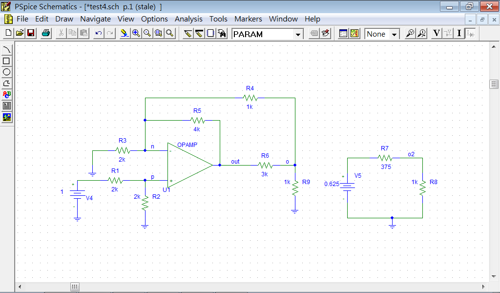

BTW, in the following circuits, how do we vary the values of V4 and V5 at the same time contineously, with the relationship, say, V5=0.625*V4 in PSpice or LTspice?
