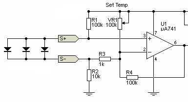

Hello everyone.
This circuit is used to detect a certain temperature level.
Honestyl I don't fully understand it. I know how it works, and how to use it, but I'd like to go deeper.
It is not a Schmitt trigger comparator (no positive feedback), nor a regular comparator ( why R3 / R2? ), nor a regular amplifier, but it seems a mixture of them.
I suppose it is based on the diodes' forward voltage decreasing with temperature (~2 mV per degree or so, I think).
As soon as the inverting input goes below non-inverting input, the output goes low, and triggers and external transistor driven circuitry.
In simulation, I tried removing the feedback, and it works, and also if attaching diode cathodes to ground (omitting the effect of R3). Of course, the response varies, but the basic function of voltage level detection/comparator is still there.
How should I face the analisys of this op amp topology?
Thanks!

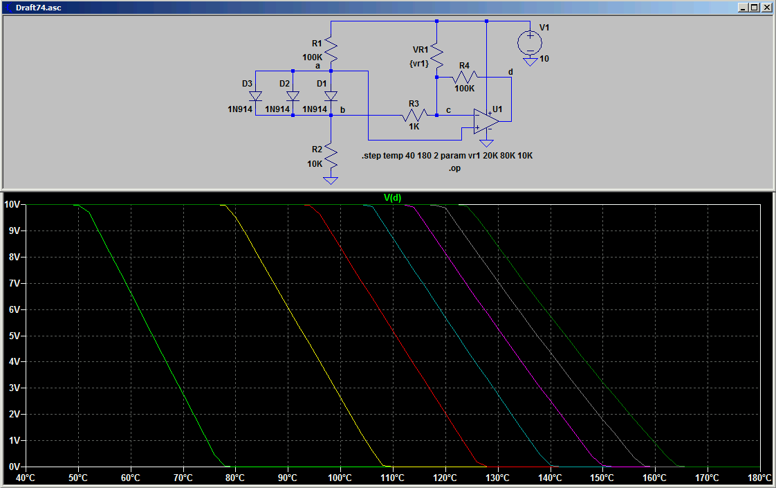

Using a modern rail-to-rail opamp instead of the piece-of-crap 741, here is a plot of V(d) as a function of temperature for various values of VR1. Trying to do the analysis with a '741 is much harder, because its output pin cannot pull very close 0V or 10V.
Note that the gain is fixed. All adjusting VR1 does is to offset the temperature at which V(d) begins moving downward. Green is VR1=20K, Yellow is VR1=30K, and so on.
Yes. What I'm having some trouble is to understand the design process thought, and how to face the analisys of this circuit, not just by simulating, which very soon shows what's happening.
For example, the feedback resistor. What is doing is to slow down the transition (requires a larger temp variation). If removed, the transition is abrupt.
Also, why R3 and R4 ?
R4 places both inputs at a higher voltage, from ground.
Making R4 lower, slows the transition further.
R3 seems add some voltage gap between inputs. If made 2k, VR has to be increased to achive a similar thrigger temperature, and again the transition is much slower.
Ok, this seem to be facts, and I see that all those components and values play very well together. But I honestly wouldn't have known how to design it from scratch. And I think that fully understand how a circuit works (without simulations) is a very good way to reach there.
Any help or advice in this regard?
Start with opamp theory.
Anything that has negative feedback, will operate in linear fashion.
Rf is R3, and Ri is the theavenin equivalent of VR1, R2 and R3.
R1 is only there to set up the diode bias.
The circuit is lacking way to limit VR1 going to zero ohms. The simplest would be a 1K (or similar) resistor in series.
Isn't R4 the feedback resistor (output to non-inverting input) ?
For the Ri I get R2 || (R3+VR). Is it? But R4 also affects input impedance. Lowering its value, should decrease the input impedance.

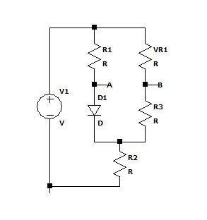

For analysis, perhaps it helps to think of the circuit as a Wheatstone bridge which is kept balanced by the op-amp?

Hello,
Do you know how to do Nodal Analysis?
If you do that you get (R9 here is the pot, E1 the diode voltage, E2 the positive power supply voltage):
Vo=(E1*R2*R4*R9+E1*R1*R4*R9+E2*R2*R3*R9+E1*R1*R3*R9+E1*R1*R2*R9-E2*R1*R3*R4+E1*R1*R3*R4+E1*R1*R2*R4)/((R2+R1)*R3*R9)
So start with that:
Substitute known values (for a ua741 E2 should be at least 10v and that is the positive power supply):
R1=100e3,R2=10e3,R3=1e3,R4=100e3,E2=10
we get:
Vo=(1000000.0*E1)/R9-909090.9090909091/R9+110.0*E1+0.90909090909091
Set the nominal diode voltage E1=0.6:
Vo=66.90909090909091-309090.9090909091/R9
Set Vo=0 and solve for R9:
R9=106250/23
insert that back into
and get:
Vo=326.4705882352941*E1-195.8823529411765
Now if you want you can set E1=0.6+dt where dt is the change in voltage for each change in degree C temperature.
The result for Vo is approximately -0.72v per degree C.
Note the typical positive power supply for a ua741 was either 10v or 15v but if you use a different op amp you can lower that if the op amp is known to work at the lower voltage.
Oh BTW the ua741 is not a good choice at all here since the minus power lead connects to ground. Look for a better op amp like at least the LM358.

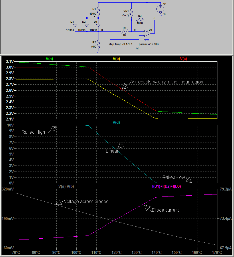

I repeat the simulation with VR1 set to a mid-range at 50K, and plot all of the relevent nodes.
Look at the lowest plot pane. This is where the analysis has to start. Note that for a forward biased Si diode used as a temperature sensor, the voltage across the diodes is quite independent of the current through the diodes (Voltage is dependent only on the temperature) so the circuit responds to the forward diode voltage.
Analysis of this circuit has to account for its three regions of operation; where the opamp is railed high, where it is in its linear range, and where it is railed low. Only in the linear region can the opamp enforce the condition that the two inputs of the opamp V(a) and V(c) are equal. The opamp is railed high for temperatures less than 106degC, is railed low for temperatures greater than 140degC, and acts as a linear thermometer between those temperatures. You can see how difficult the analysis of this circuit if using a non-rail-to-rail opamp. The amplifier used in the sim is rail-to-rail in and rail-to-rail out.
The top plot pane clearly shows that the plots of V(a) and V(c) are equal only in the linear range. V(a) is connected to the non-inverting input of the opamp; V(c) to the inverting...
