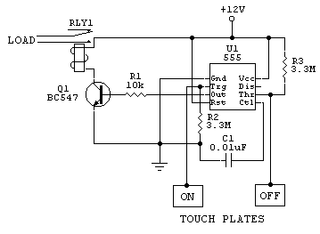

Hi, I wanted to know if anyone has made a on/off switch that is triggred by touch. I have seen some schematics out there but they contradict each other. Basically I have an electronic device which as 4 dip switches on there and they are annoying and I see some people who have just installed toggle switches instead but that looks ugly. So want I wanted to do is take the dip switches out and replace them with an "electronic on/off switch" either push button or touch activated. Does anyone here have schematics for this ? Thanks a million in advance.

This is what I had built quite long back. Works awsome!

Wow, thanks for all the reply's guys. You guys ROCK !!! =)....
Kinja, I like that design but I prefer something with 1 electrode which I can use to turn this device on or off.

Phasor, Looking at kinjal's schematic (now I could be wrong) one electrode turns on it on and the other electrode turns the device off. So if I were to do what you say wouldn't I confuse it by pressing both electrodes and the same time. Because I was thinking about doing something like that but then I thought to myself that won't work.

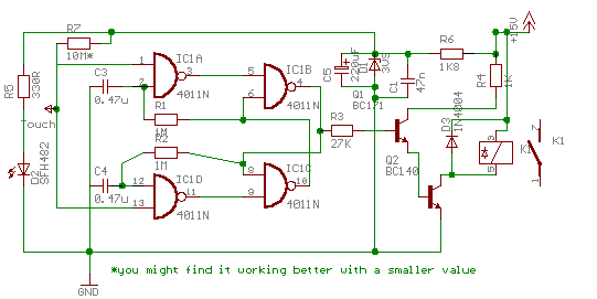

well i said i have a touch swtich, so here is the schematic.
i'll explain a bit. the circuit works fine with 5-15V, it all depends on what voltage you use for the relay.
the second thing is the led, why i put it here. the way i made the touch switch is:
i took the led and put some turns of uninsulated wire around it and connected it to the sensor. then i covered the led's leads with a plastic tube. it looks very nice and if you touch the led the circuit turns on or off the lamp.
another thing is the 10M resistor. you might find that the circuit will be working better with a smaller value like 4M7 or 3M5. it depends on wht type of ic you use. i used one from philips, it works fine, and i have the circuit for quite some time functioning full time.
well i have the schematic. if you need more explications tell me.
the circuit operates from 5 to 15V

bogdanfirst, I like that idea with the wires around the led. Did you have to cover the whole led with wire. In other words in order for the device to switch on or off your fingers would have to make direct contact with the sensor correct ? And where did you get your parts from ? Can I pick them up at RatShack or do I need to go through digikey or jameco or something.

well, i did not cover all the led...i used a 5mm led and covered it abut 2/3 of it leaving the end of it free. the thing is that when you put your hand on the led you got to touch the wire too.
another thing...i put a wrong value to R6(origlnally 1K8) if you put the led put a smaller value like 1K or 800R.
about the parts, i dont know, here there are not all the shops that you say.
the ic, the 4011, i used a HEF401BP, from philips. it works fine, i have a small light like that by the bed and i always turn it on at night when i am not carefull(i moove a lot when i sleep) and wake up to turn it off :lol:
about the other components, i used 2 bc171 thats what i had then. for the bc171 you can use a general purpose thansistor, low power, but in place of the bc 140, you can put a transistor that can handle the current of the led. bc140 can hold 1A wich i thing is enough.

What does the "R" stand for in a resistor. For example 330R. Does that mean Ohms. And also 1k8 <---- What's the 8 for?. You think you know almost everything just to find out you know nothing. lol
bogdanfirst, what type of relay switch is that SPST ? And what type did you use (part #)

330R means 330 Ohms
1k8 means 1.8k . The character in the middle acts as decimal point in all cases like 2M7 means 2.7M.
SPST relay is SINGLE POLE SINGLE THROW type of relay having only one on/off contact.
Sorry, I didn't pay enough attention :oops:
