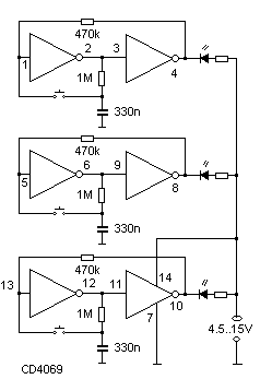

O.K. se this circuit.

Question: Are the values of the capacitors really 330 nano Farads(nF) or did you mean 330 micro Farads (uF)?
Thanks again,
Patrick
the caps as i marked: 330nanofarad. The serialresistor of LEDs depend from supply voltage and LED type. Use a regulated supply for proper work.(the wall adaptor contain only filter cap.)

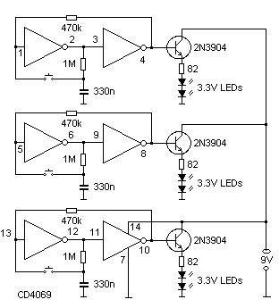

The CD4069 can't provide enough current to light LEDs very brightly, and the LEDs would load down the outputs so much that the logic won't flip.
Therefore add emitter-followers to the logic outputs to drive the LEDs.
You have enough voltage to wire the LEDs as two in series and reduce the number of current-limiting resistors.
The link to your LEDs didn't work so I assume their "typical" voltage is 3.3V (3.5V is probably their rare max).

Although the circuit will work as is, it would be better to replace the values of all the 470K resistors with 4K7, i.e. 4.7K
This helps the circuit to change state faster and performs better at no extra cost.
470k has a response time of about 150ms. 4.7k's time of only 1.5ms would be triggered many times by switch contact bounce. 150k might be a good compromise or use 0.1uF caps with the existing 470k resistors. :lol:
The switch contact will bounces but the circuit would not if 4K7 is being use.
Incidentally this is actually the main reason for using a small value resistor in this case.
