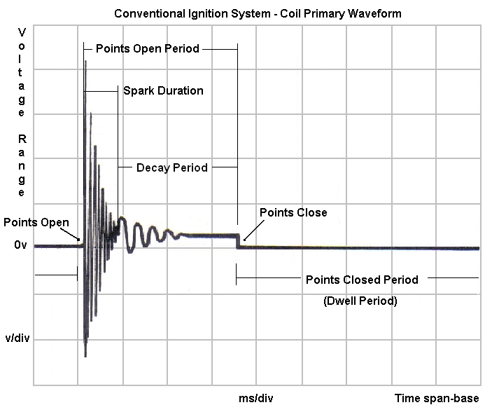

The coil is just a high-ratio transformer. When the primary current is interrupted, the magnetic field collapses and produces a high "flyback" voltage across the primary winding - and a proportional very, very, very high voltage across the secondary winding.
Polarity should not make all that much difference, if any.
(Connecting the wrong way changes the circuit configuration & may change the output slightly, as the secondary winding is usually commoned to one of the primary terminals - which should be the power one, not the points side).
When the points open, the coil is still connected with the capacitor (condenser) and it will "ring" briefly, producing several sparks of alternating polarity.

The magnetic flux (field) carries or shares energy between the windings in a transformer, not current.
Most transformers have no electrical connection between primary and secondary, but each winding has two (or more) connections to give an electrical circuit.
With the ignition coil, both ends of the secondary winding must connect somehow, for there to be any useful current flow.
As far as I am aware, on "traditional" round can coils, the primary and secondary windings share the battery feed terminal.
I have seen some drawings that show the secondary connected to the case for grounding, but that seems unlikely unless there is a specific terminal to ensure a proper electrical connection. Newer encapsulated "coil pack" types may have different configurations.

Yes, in many but maybe not all coils the primary and secondary are connected internally, but this is so that they can share a common ground connection. The internal connection doesn't have anything directly to do with the spark except it lets the spark return to the other end of the secondary.
