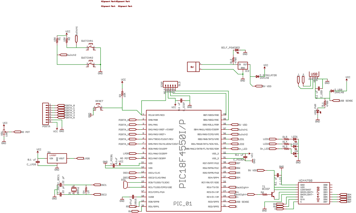

The schematic posted here is for your programmer, lets see if we can make it function.

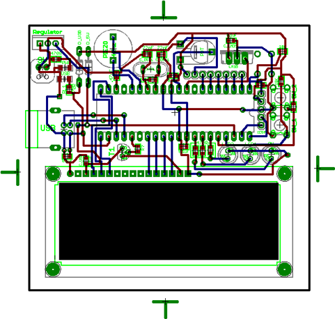

I have access to only an analogue scope, but unfortunately Im doing the wrong course at uni: Computer science. Havent even had a whiff of electronics yet.
Whats better about the junebug? Can you still debug targets?
I have ruled out the boards involment in the problem. I have checked many differenent boards, they all will no longer go into debug mode, and they all program only about 30% of the time.
I have included my most recent board anyway.

Edit: just noticed Chris's board is similar to my Unicorn board.
thanks for the input everyone.
I havent changed the dips yet. I dont have replacement ones. Im just in the business of checking the connections. I have seen a few dull joints, that need a bit of heating.
That unicorn LCD looks exactly like the ones I got from china.
cheers.
blueroomelectronics said:
Good eye mvs_sarma, the DG411 is probably not on the version in the photo. Seems that one may use transistors for VPP switching.
