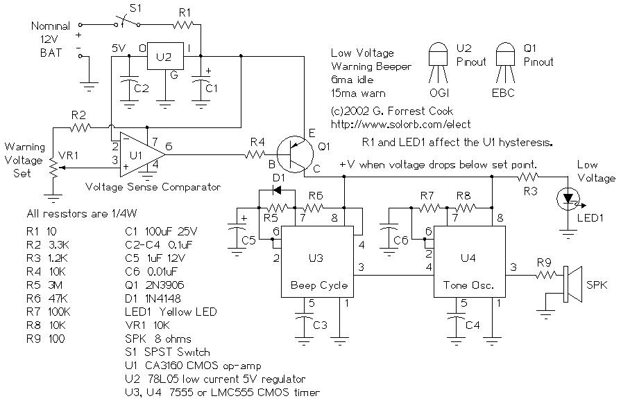

Probably the best bet here is to use a comparator circuit where you set it up to detect the resistance of the thermistor, while at the same time biasing the thermistor with enough current to allow self heating as the old bulb did.

The only question i have with that transistor and zener circuit is will it provide enough self heating for the thermistor. The thermistor change in resistance depends a lot on the change in temperature when the thermistor looses it's main heat sinking (the fluid in the tank) and it will not heat up much without the proper current flow.

We know in the original circuit a NTC thermistor was used to illuminate a light bulb for a low fuel status. We also know how it did that, as the fuel level went down there was no liquid to remove the self generated heat of the thermistor. The resistance decreased and the overall current in the loop increased lighting an incandescent bulb. If the bulb is replaced with a resistor we know the current flow through the resistor will change on a low fuel status. Since the current through a fixed value resistor changes so will the subsequent voltage drop (the voltage developed across the resistor) will change. That voltage developed across the resistor could in turn be fed to an input of a comparator.
Something to consider using a comparator would be to add hysteresis (mentioned in the link) for stability on a low fuel indication.

I have this schematic which has worked very well in the past for this use, so I thought I'd post it here. I've used it for a low voltage warning lamp system so far, but it should also work as a switch for a thermistor to an LED. I'll just put a 12V regulator at the input to insure a steady voltage supply (barring a charging system malfunction).
