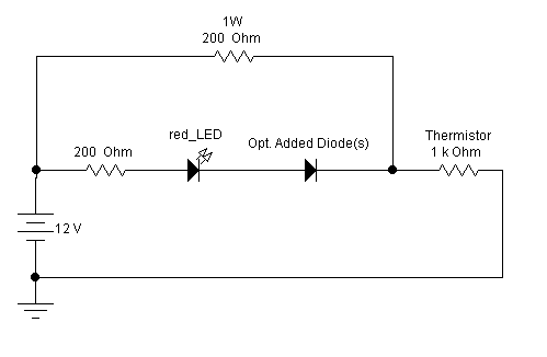

Try connecting about a 200 ohm, 1W resistor in parallel with the diode and a 200 ohm resistor in series with the diode. The resistor in parallel will shunt the current around the diode when the thermistor value is high. The series resistor is the normal current limiting resistor for the LED.
You may have to play with the values some to get the correct operation since I don't know the exact characteristics of the thermistor when it's hot, I'm assuming around 100 ohms.
You can also connect 1 or more regular diodes in series with the LED to increase it's threshold voltage so it's off when the themistor is cold.
Attached is the schematic for this circuit.
CAUTION: Don't go below 100 ohms for the parallel resistor value or it may burn out the thermistor (and cause an explosion if it's near gasoline) It's probably best to experiment with the themistor far removed from any gasoline. Use water to test its operation.

In looking at the schematic, I'm not sure of what size diode to use?
Just about any diode that will carry 100mA or more will do (such as a 1N4148). Since it's never reverse biased the voltage rating is not important.

I tried the 1W with 220 ohm and that sort of work with allowing the LED (including diode) to turn off while the thermistor is cold (full).
However, when the thermistor is hot (empty) the LED lights up but not to its full abilities.
So, i tried a few more resistors with lower ohms. The work in the sense when the thermistor is hot, the whole things gets HOT!! That being a 22 ohm, yea, I Know you said not to go below 100 but the LED won't go to full light. I bought a bunch of resistors to at least experiment.
I have noticed that that the 1 watt resister seems to be key here.
The thermistor I am using is bare, so I can't use water to cool it. Gas isn't conductive so, its a bare thermistor in gas. seems scary but that's the way these things where built. Thats also why these thermistors are on the "negative" side of the power.

Did you try reducing the 100 ohm resistor in series with the LED? That will increase the current through the LED.
In general, reducing the parallel resistor value will reduce the LED current (shut it off) when the thermistor is cool (in liquid). Reducing the resistor is series with the LED will increase the ON current in the LED when the thermistor is hot (out of liquid).
As I said reducing the parallel resistor below 100 ohms may fry the thermistor.
It would be better to use oil rather than gasoline for experimenting. A light motor oil such as a 10W should work fine.
