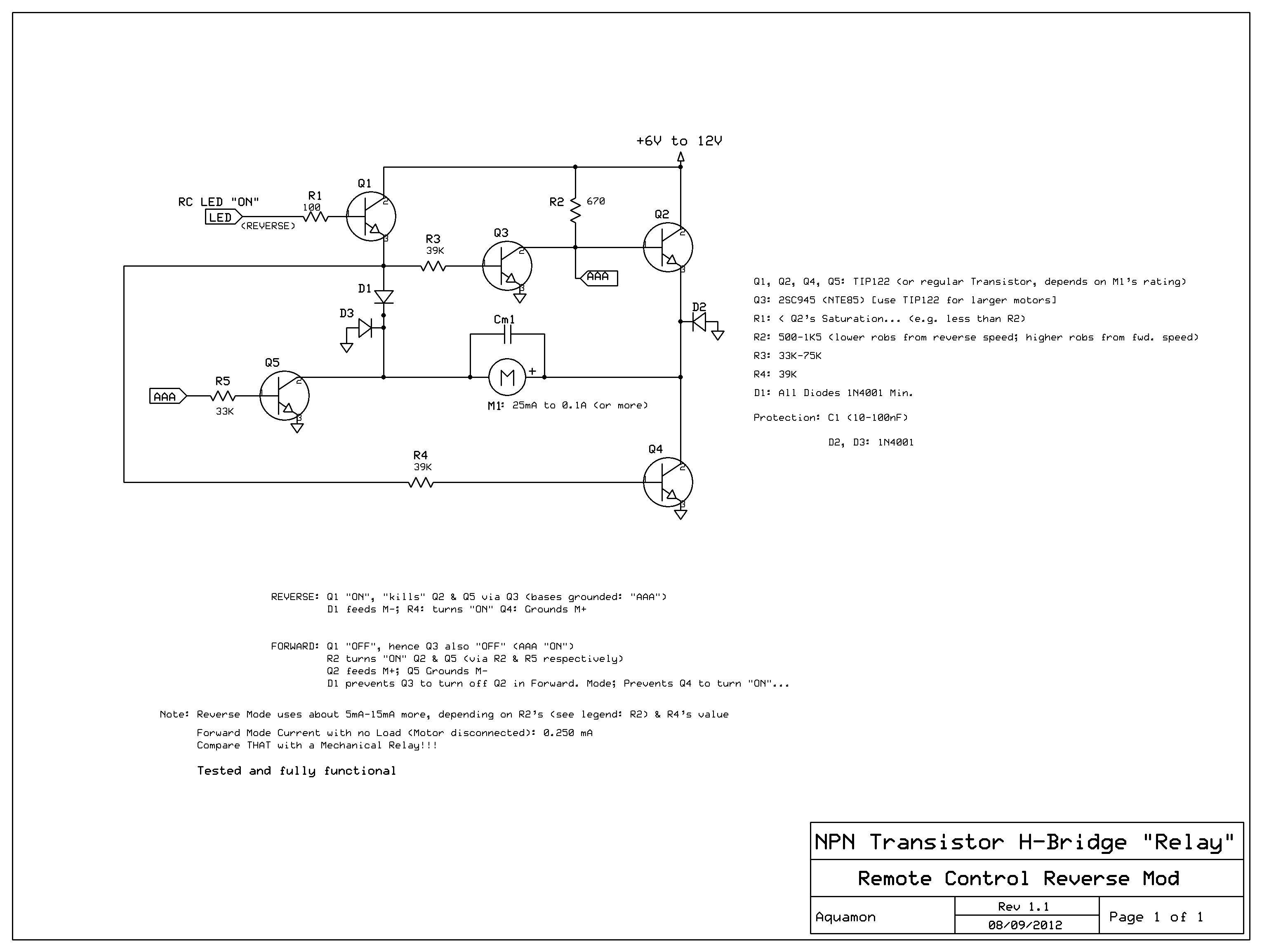

NPN Transistors as sole H-Bridge (no PWM), just "old-school" brute-force!
aquamon
Want to connect the emitter of Q3 back to circuit efficiently instead of dumping to ground (thru M-).
Ideas please (moved)

Emitter followers have too much voltage loss to be used as switches. They should be PNP transistors.
Darlington transistors have even more voltage loss. They should be P-channel and N-channel Mosfets.

Second thread, no: That wasn´t my thread to start with.
I did testing as you implied and I only get an additional 0.01 voltage difference between the two configurations; base resistor of 1K2, might change R2 to that (higher and motor speed drops) to save in reverse; then again, maybe not as this is only ¨1/2-a-circuit¨.
Maybe you think tip122 is J-fet? (NOT an amplifier).
However, total current does increase by 2mA (for a motor drawing 35mA straight, insignificant for a redesign).
Please, do you own tests before posting ¨theories¨; also, doesn´t matter if I use C945, C2120 or TIP122: reacts same, thank you!
At this point, please prove your ¨theory¨.
Please, do you own tests before posting ¨theories¨;...At this point, please prove your ¨theory¨.

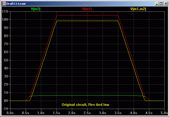

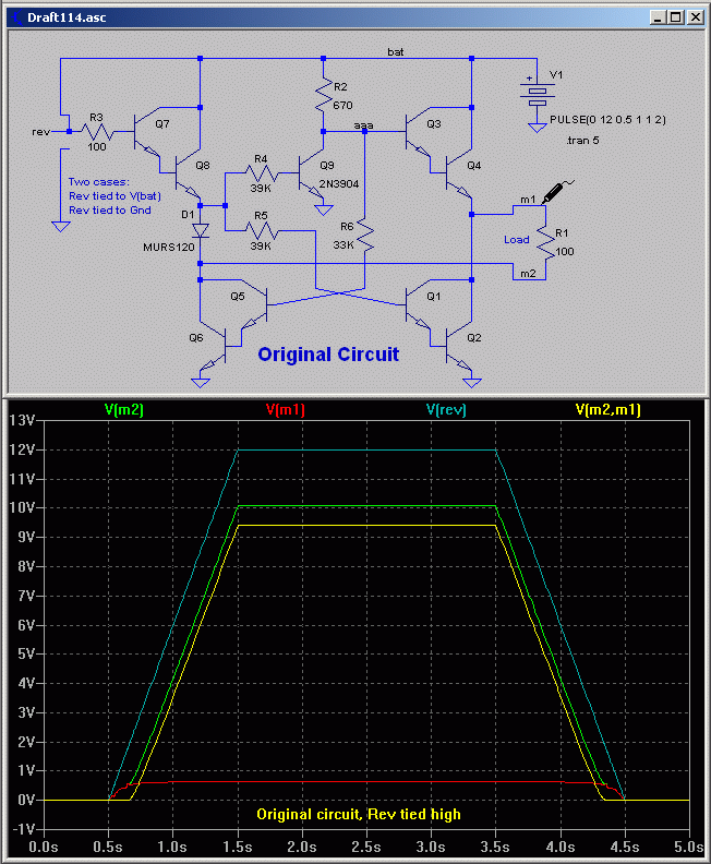

Second, a quick simulation shows how inefficient your circuit is.
With Rev tied low, with a 100Ω load, the voltage drop across the upper Darlington is 1.5V and the drop across the bottom one is 0.7V, leaving only 9.8V across the load (motor). With a battery voltage of 12V, that means you wasted 2.2V.
With Rev tied high, with a 100Ω load, the voltage drop across the upper Darlington is 1.9V and the drop across the bottom one is 0.7V, leaving only 9.4V across the load (motor). With a battery voltage of 12V, that means you wasted 2.6V. The difference is due to the additional drop across D1; why is it even there?

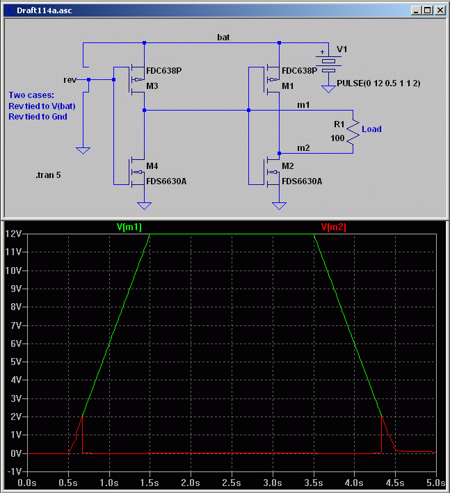

As suggested by Audioguru, contrast your motor reversing circuit to the simplicity and performance of what modern PFETS and NFETs can do:
Note that with such a light load (100mA), the voltage drop across the both top and bottom devices is a few mV. This circuit could switch several Amps and not break a sweat. Try that with yours...

Third, my circuit is always ¨FORWARD ON¨, when the remote´s LED switch is activated, then REVERSE: ONE SWITCH controlled.
Fourth, this was done with what I have lying around, basic COMMON parts, no special orders.
Fifth: the intention is to go for more power; hence, TIP122 (manufactured by ST) was planned from day 1.
Sixth: I have done my research long before they ever had a ¨chip¨: limited current.
Seventh: Battery Voltage measured 7.28 - Motor Vdrop 5.95 = Circuit loss 1.33V
Which would be a lot more efficient (FUN) using 12V.
Eighth: DRAW your suggestion, can´t figure out how to do it, eh?
View attachment 90096 View attachment 90097
