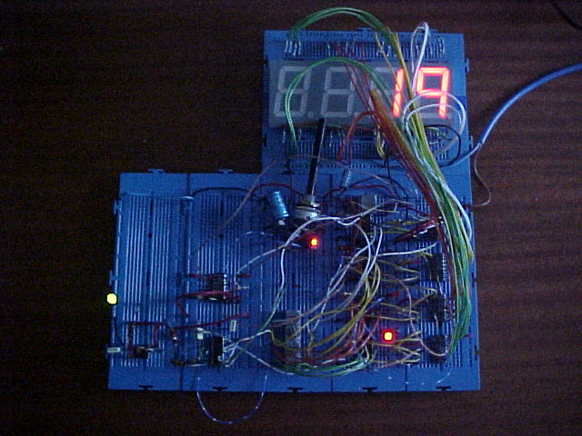

Hi all,
I've had a small amount of exposure to electronics, but have stumbled upon a really great idea for an electronics project.
I am an instructor in the air training corps, and was hoping to build a fake bomb, which the cadets can diffuse By cutting the correct wire.
What I'm trying to do is have 4* 7 segment display's as a countdown timer, with either switches or a numpad to set up the countdown time. The "bomb" should have about 6 wires that can be cut (they will be replaceable). 1 wire should result in instant detonation, 1 should stop the timer/detonation (and if possible change the timer to green - There is a link to a store that carries red/green 7 segment displays). The 4 other wires should speed up the countdown.
I know it's a lot to follow, but I have some of the circuit diagram already. See Link https://www.acrim.co.uk/_images/circuits/circuit-det4.jpg
I need to change the 7 segment displays in the link above to the ones here and for them to go green when the timer is stopped, and red when it is counting down. Also if someone could incoporate a numpad that would be cool !
Can anyone shed some light on a parts list / PCB design etc.

To use the displays you suggest you will either have to have 28 transistors to convert the 4511 for common anodes or replace the 4511 with 7447 driver (I can't find a CMOS common-anode driver - mixing TTL with CMOS seems to be the only option!).
:idea: How about making a bi-colour 7-seg display from lots of LEDs so the common cathode driver can be kept?
Adding some BCD-encoded thumbwheel switches for pre-setting a start time would be easy and making the display change colour when 'diffused' would be easy, a few more logic gates and two transistors would achieve it.
I wouldn't bother with a pcb design for this, a ready-made matrix board would be OK. **broken link removed**

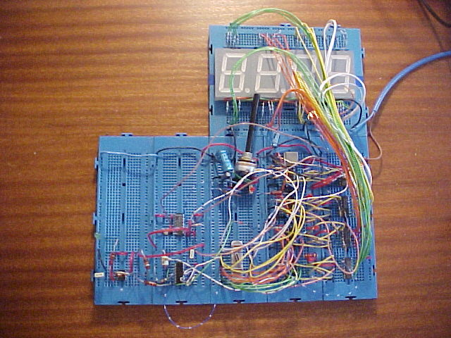

First stab ...
Just thought you people would like to see this...
As we often discuss 'breadboards', here's my prototyping board close to full :wink:
The circuit is based on craigey's posted circuit (above) with a few alterations for
leading zero suppression (saves power and looks better)
better (more sensible) ripple-carry
counts in minutes and seconds rather than just seconds
display changes colour from red (counting) to green (stopped before zero)
all running on a 9v supply
We (cragey and I) are still discussing this and working on it together :wink:
The single red LEDs are just indicating what the ripple carry outputs are doing, the green is the clock pulse.
Yes, those 7 segment displays are HUGE - look at the 16-pin ICs at the bottom of the breadboard :shock:

Hey mechie, where'd you get the breadboard modules ?
Been looking for something like that so I can size the breadboard to what I need.

That prototype board
Nostrafus,
The prototype boards are called BimBoards,
made by BOSS Industrial Mouldings, Mildenhall, Suffolk, IP28 7DE, UK. Tel (01638) 716101.
HERE.
I have bought them at various places in the past, so this is not a unique supplier :)
Notice the use of an 'extender board' in my photo - under the LEDs - to correct the hole spacing to 0.1" across two boards.
Most of the components are easily obtained from anywhere, Radiospares (http://rswww.com) or Maplin (http://www.maplin.co.uk). Radiospares sells everything including the large 7 seg displays and the little BCD rotary switches (bottom centre of my photos) but insists on opening an account with them.
