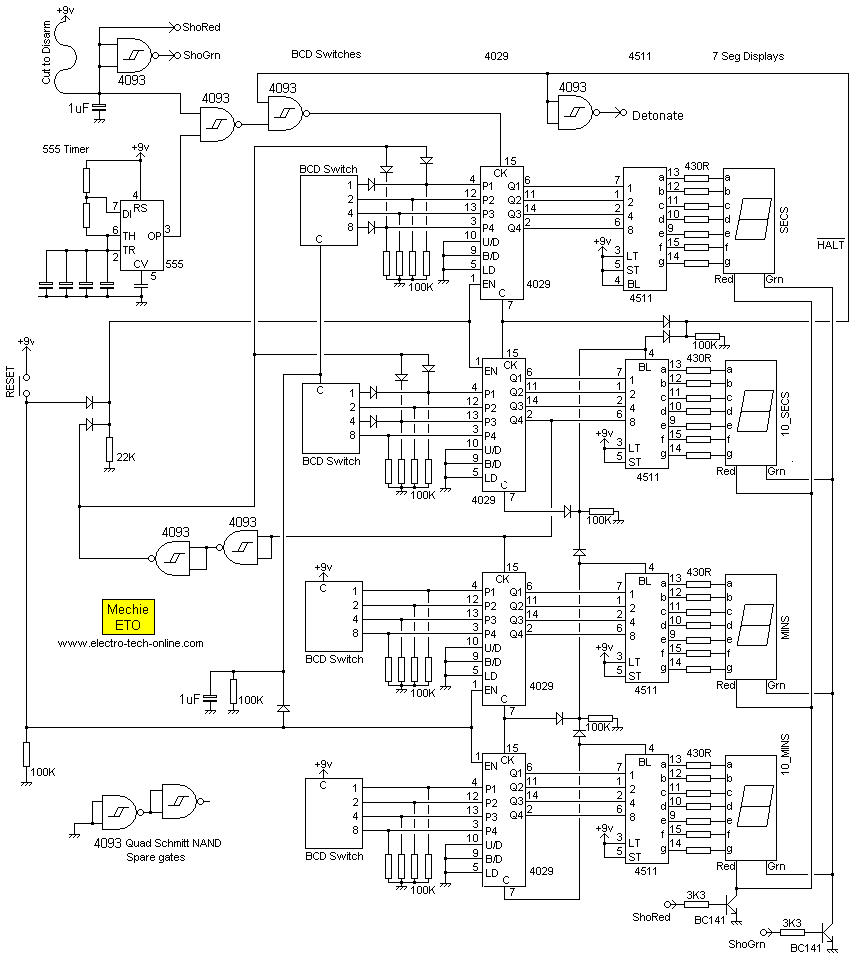

Ongoing Saga - Update
Just finishe scribbling the latest version of the circuit,
Everything works as we wanted but the reset pushbutton is less than perfect -
- sometimes presets to zero or random high value,
- should preset to value set on BCD switches :(
- I'm sure this is just a simple timing issue with the reset logic but no time to sort it just yet :?
For the circuit operation-
Counts down from any value set on BCD switches via the RESET pushbutton,
Counts in minutes and seconds (seconds resetting to 59 when it decrements minutes)
Freezes at zero count (detonate bomb)
Changes LED colour if disarmed before detonating
All the above features use the same lump of logic which is currently just 2 4093 quad Schmitt NANDs, a handfull of diodes and three transistors.
Mostly as in photographs posted above - too similar to be worth more piccys :wink:

Here are a few thoughts for future designs:
Mount the whole lot in a clear perspex box with a hinged lid.
then use an ultrasonic or reflective infra red circuit to speed up timer when the lid is opened.Augment with recorded manical laughing and a further increase of speed if lid is then closed.
Metal and capacitive sensors can also be used to great effect, give the "contestant" a choice of tools to work with, arm and disarm different applications dependant on the type of tool detected.
Finally add a silly disarm circuit, that requires the use of an equipment item common to all the cadets.
Or if it is to be used at a fund raising event a coin operated switch must be activated to prevent a soaking.
You say that you want to use the circuit for training, one serious improvement I can suggest that the circuit itself randomly select a single wire to cut for disarm from a choice of paths in plain sight . This stops any , previous experiance shall we say , of being any use to the next attempt.

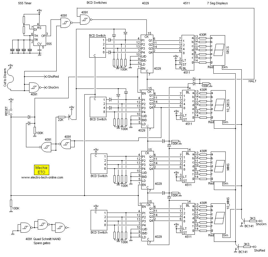

Ok, guys just a bit of eye-candy for you....
This is the timer circuit design. I've still got to make the PCB yet. I think it should work, but will be waiting for mechie to check it first, before I start building it. We're almost there with the rest of the design, just got a few bugs to iron out.
The Final Countdown ?
OK, try this ---
The circuit works a treat, I have varied the supply from 4.5v to 12v and it still works OK (the LEDs are dim at 4.5v but still readable).
Any valid time can be set on the BCD switches, from 1 second (!) to 99 minutes and 59 seconds.
You can set 79 seconds and it will work perfectly but is it sensible ?
Trying to set 80 or more seconds results in unpredictable start values, I have made no attempt to prevent this,
relying on common sense, the BCD rotary switch could be mechanically prevented from going too far ?
The circuit around the 555 timer can be exactly the same as the original zapwizard posting with the exception of the 'DISARM' wire,
which now also changes the display colour to green.
All wires that may be cut have some limited static protection in the pull-down resistors
which also maintain a known logic state when cut.
FAULTS FIXED-
Mainly the method of clocking the minutes counter from the 10-secs counter --
when the seconds got to zero (assuming there are minutes still to go) the logic reloaded the seconds counter with the value '59'
and relied on the carry out of the 10-secs counter to decrement the minutes.
This carry output was noisy during the load operation and caused random operation of the mins section - racing?
By using the Q4 output (count is greater than decimal 7) the problem is avoided.
Other bits of logic are tidied up and a few unneccesary components deleted.
Typo error - I had the NAND gates labelled as 4091 - :roll: now correctly shown as 4093.
