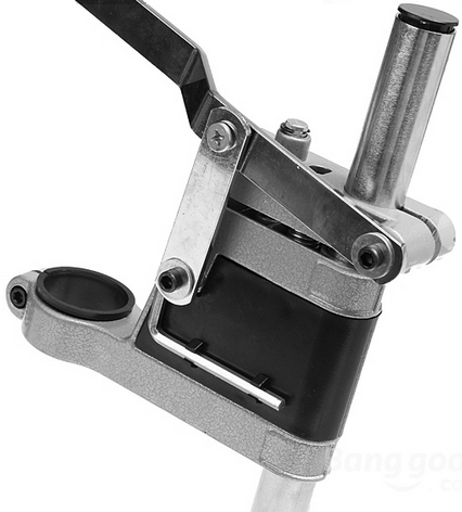

Do NOT buy this piece of junk!
https://www.banggood.com/Bench-Drill-StandPress-For-Electric-Drill-With-3543mm-Collet-p-925616.html
It is sold by many on-line stores at a VERY wide range of prices.
It's design is overly simple. Metal grinds against metal and the longer you use it the less control over it's movement you have. No amount of polishing or lubricating can improve this thing. Even the locking bolt is so cheap that the threads are stripped and I am looking for a replacement.
That looks incredibly similar to the one I got from Lidl, which I have not had any problems with apart from a little sideways play. Theirs is made by either Powerfix or Parkside - I don't think you can get those brands anywhere else though.
Maybe yours just needs taking apart and having a liberal application of grease. I love grease, it makes allsorts of things start working again...

throbscottle, I have taken it apart (it comes as a kit) and have polished and oiled, not greased.
If your's is working well then you have not run it up and down 20 times.
Mine is model TS-6109 Drill Stand. No company has put their name on it or the box or pamphlet.
It is from China.
The lateral movement instead of clean up & down grinds the part holding the drill against the pole in two places. (at the top & bottom on opposite sides, front & back)
A simple design but terribly flawed.

That's a shame. The running surfaces mustn't be smooth then, since even that design shouldn't wear out that quickly. I think mine must have done over 100 holes by now, no noticeable wear. Pretty sure it's made in Ireland.
Why does Blarney Stone come to mind? That stuff is invincible.
It's cast aluminum. I have tried polishing it.
Aluminum on aluminum or even other metals does not slide well and galls easily; some alloys are particularly bad. I once made an aluminium bolt and nut using a standard fit. Got them screwed together OK, but never got them apart. Graphite in glycerin(?) is made to lubricate threads for aircraft spark plugs. That is steel against aluminum. You might try graphite in an oil, like is used for locks. Not sure how molybdenum would work. I would stay away from it, unless you can find some reliable source that recommends it.
