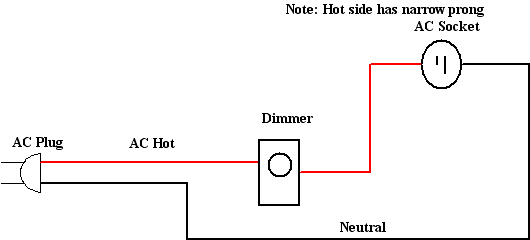

Ok.. this is going to get really crazy now.. this was what I was really thinking of doing but I was going to bring up part 2 later. But probably best to mention it now because it might bring up different issues.
This is what I really wanted to do..
I wanted to run this off one plug and then run the crock pot off the other plug or a wax pen. And have a dimmer for each.
http://www.myheap.com/book/chapter-02/heatgun/heatgun/HotAirSetupLarge.jpg
This is easily done, the question is how you want to add dimmer controls. Adding controls to an existing outlet would be the most pain because you would have to add the dimmer into the wall. I would suggest you make a dimmer control extension cord. So you would have something like.

This is easily built. I can draw up something for you if you like.

If I recall, there is a Home Depot near Johnson Ave. Your one stop store for such a project. I will make you up a drawing, but not tonight. Okiday?
Here is a basic electrical drawing of what you could make.
Disclaimer: Use of this drawing is for educational purposes. Any other use is at users own risk as use of this circuit exposes user of such circuit to high potentially lethal voltages.
Also note: Ground wire not shown.
