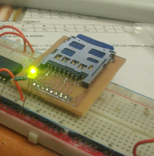

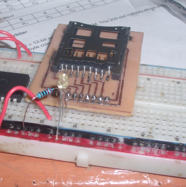

It took me 10 min to make this custom eagle part for SD then 20 Min to make this bored and i am so happy it works so far :D heh
Card Partially in:
sdout-jpg.35064
Card Fully in:
sdin-jpg.35065

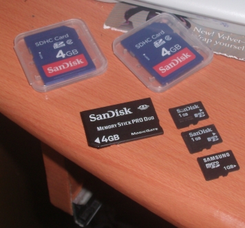

Some things to play with:
cards-jpg.35066
I bought a SD card from DipMicro and I thought it came with a holder. Will have to check.

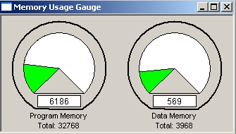

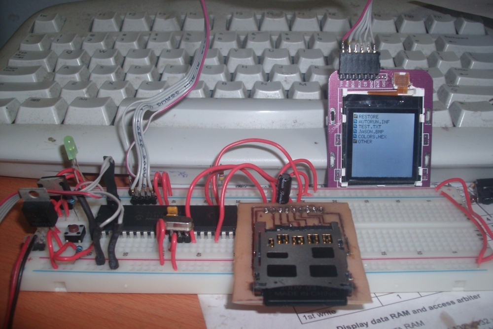

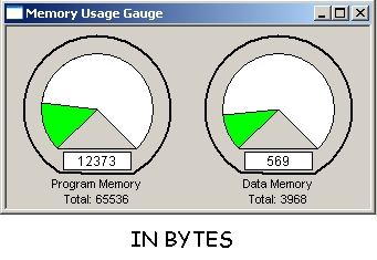

Hey guys just wanted to let you know i got the SD card with FAT working on a 18F4620 and with lots of space to spare. But its a read only solution using Petit FAT File System from chans site:
bguage-jpg.35166

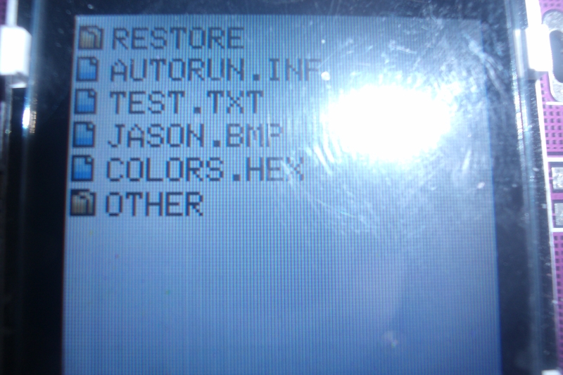

Ok good news i can open text file on SD card and view it on my lcd.
Now i altered my vb app to create hex file images for my lcd. now i will create code to buffer the data in 100byte parts and load to lcd. heh wish me luck
