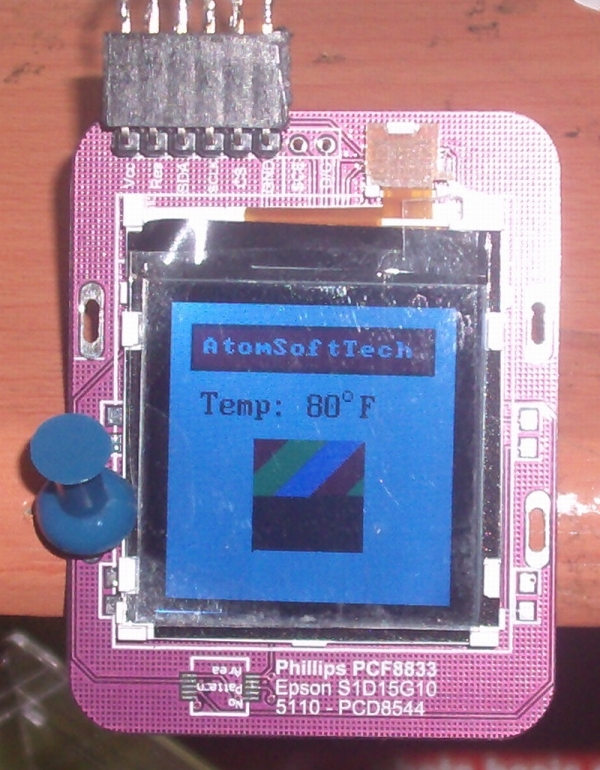

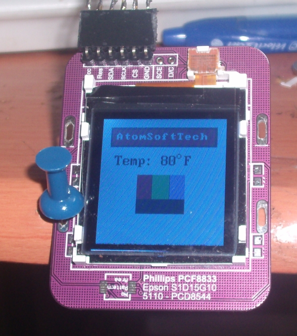

this is very frustrating heh .. in my mind it should be working but in reality it isnt..
My screen is setup to write from
LEFT to Right then top to bottom like:
wrap-jpg.34920
So in VB im reading from left to right and top to bottom .. placing the data into a listbox and looping through the listbox (visual array)
I divide each pixel RGB by 17 so 255 == 15 (aka 0x0F) which is the max for each RGB (0xFFF)
Now i get black pretty good but i get sukish results with the rest... here is my 50x50 image i want to convert: (i had to convert to jpg to place here)
colors-jpg.34922
To convert the pixel properly from 0-255 range down to 0-15 range, use this;
unsigned char newpixel;   // 8bit var is ok
unsigned int temp;    // must be 16bit var!
  temp = (pixel + 8);
  newpixel = (temp / 16);
The operation of adding half the divisor then dividing will give you the best colour match (ie least possible error).
Top line looks ok, then you get a 45 degree angle so you have a 1 pixel error on each line.
Check your line length values, and for loops etc. Could be a -1 in the wrong spot... ;)

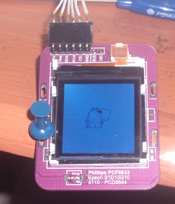

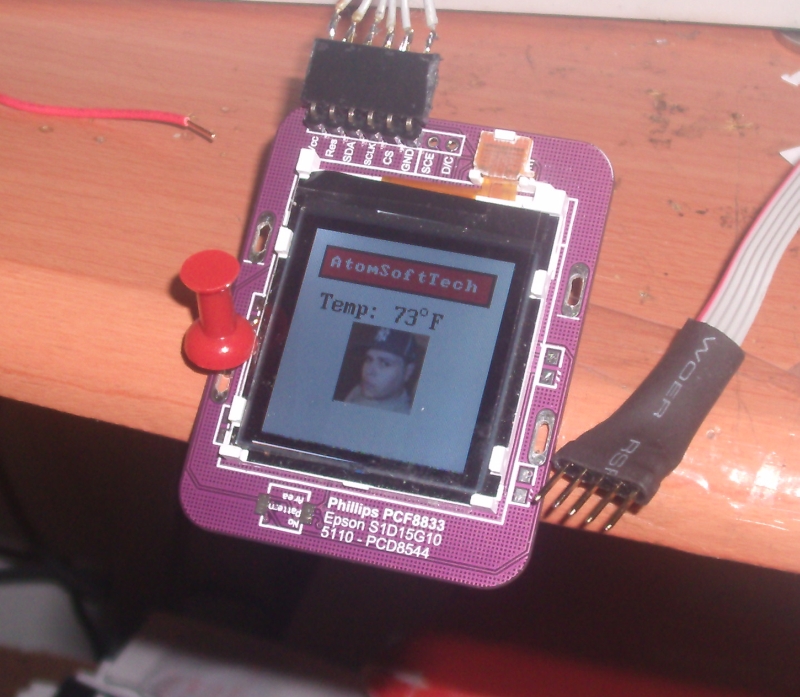

heh was bored....
yay-jpg.34929
Looks way better live

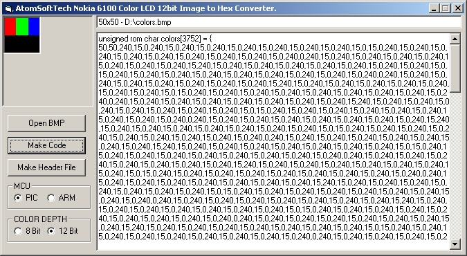

Here is a pic of the new version of the VB6 program.
6100conv-jpg.34982
working on adding the 8 bit stuff to pic code. Should be easy
for now i will leave this as is 12bit and PIC only. I have no need to make it otherwise...
I will be working on storage needs now. SD+FAT... New idea and stuff comes to mind.
Hey guys this is eating up quite a bit of my time so i am omitting the 16bit part but the 8 and 12 bit works 100% and i also made a Color conversion part to this so you can convert colors from RGB to 8, 12 and 16 bit version based on this LCD of course
