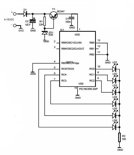

I wouldn't mind using this because it uses much fewer parts, but i know next to nothing about this PIC, much less on how to program one it and with what...
You could follow the schematic and program (blinky) in the back of the Junebug manual. It uses only 3 I/O pins to run 6 LEDs charlieplexed

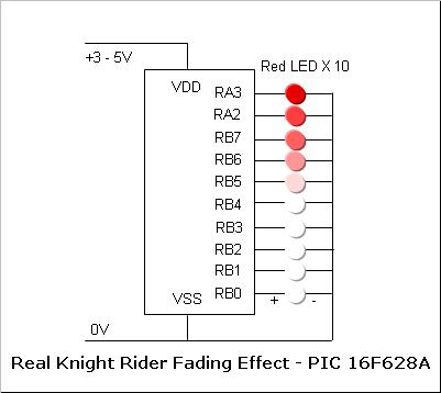

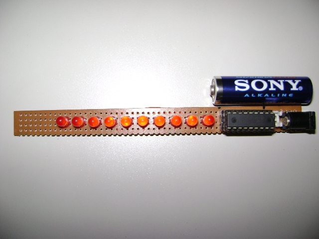

Audioguru that information really usefull I was thinking how the original Knight Rider fades the bulbs.Now I got the point they were using incandescent light bulbs.
Anyway I like to share my designs done with cheapy LED's.
Click here to see a small video
https://www.youtube.com/watch?v=zgpFC91MSVU
I'd also replace that transistor and zener regulator with a real regulator like the LM78L05.

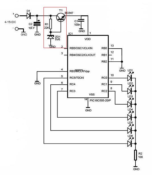

I guess what i can do is get rid of these components(outlined in red) and replace it with an LM7805 for proper +5v regulation.
