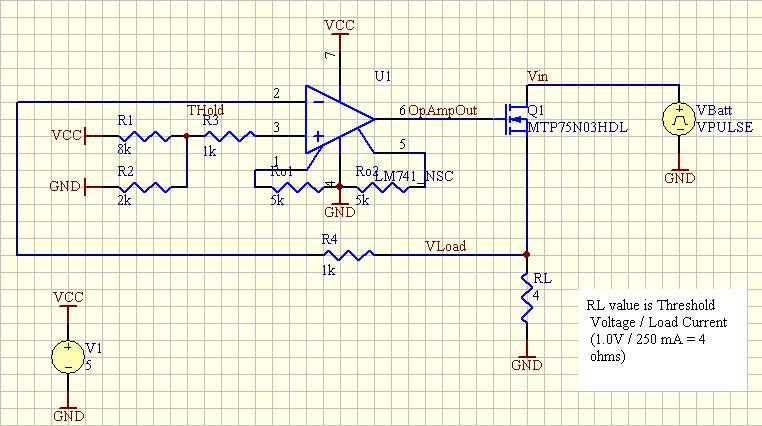

As I previously posted, I'm interested in building a circuit to test NiCad batteries. The testing will be focused cell by cell to weed out or combine like power cells, and junk the bad ones. From the information that I have been able to find (especially since I was able to find several battery tester threads when I didn't search for NiCad), the battery should be discharge at 1/10 mAHr Capacity to 1.0 and never below 0.8. This applies to a single cell. Can this be directly extrpolated to the multi-cell packs, such that one should discharge a 9.6V 8cell pack to 8.0V and never below 6.4V, etc.?
From this thread, https://www.electro-tech-online.com/threads/battery-tester-help-needed-thanks.7232/ I have come up with this circuit and appears to simulate quite well.

Finally I am moving to actually prototype the above circuit. I have come across two items that I was wondering if the experts here could validate and/or expand upon.
For clarity, off I'm not using the opamp and fet as pictured, but instead I'm using a MC17332 opamp and a BUZ101S fet.
First, the OP amp output seems to operate in three regions ~2.4V, 2.5-4V and 5V (rail).
As the battery voltage changes from 1.2 to 1.05 volts, I don't see any change in the opamp output. Once the voltage starts to get below 1.05 then the opamp output starts to climb, reaching 4V at around battaery voltage 0.99, then jumps to 4V.
If you have followed me so far, the change in the opamp output once the battery gets close 1V I understand. What I don't understand is why the opamp output stays at 2.4V while the battery voltage is dropping from 1.20 to 1.05. I expected there to be more change in the opamp output during the battery voltage change from 1.20 to 1.05.
What am I missing here?
A couple of quick comments,
I cannot find a datasheet for MC17332, is that number correct, or, is my google-foo failing?
The BUZ101S does not seem to start to turn on until the Vgs is of the order of 4 volts.
This may be rather high if your supply is only 5 volts as implied by the schematic in post#1
My bad. That should be MC33172. I was told it was one of the "next gen" 741 opamp. Good general purpose opamp, without the nasties found in the '741s.
The Vgs(th) is 2.1-4. If I understand correctly, the one in my circuit must start around 2.4V and is fully on by 4V.
...The Vgs(th) is 2.1-4. If I understand correctly, the one in my circuit must start around 2.4V and is fully on by 4V.
To be fully on at 4V, an NFet will have to have a Vgs threshold of <1.5V

I have used them. The MC33172 is nothing like an old 741 opamp, instead it is an improved LM358 opamp because it has the same low supply voltage and current but it has no crossover distortion and instead of poor performance above 2kHz it works well to 35kHz. It has the same inputs that do not work if they are within 1.8V from the positive supply and the same output problem that does not go higher than 1.2V less than the positive supply.

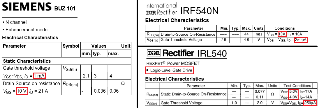

You need to look at the datasheet for the BUZ101 Mosfet and almost all other Mosfets. The input threshold voltage is when it barely begins to conduct, only 1mA. With an input as high as 4V then some of them conduct only 1mA. With an input of 2.1V then some of them conduct 1mA. The datasheet shows that all of them are fully turned on when the input voltage is 10V.
I have to admit I have not worked with FETs much, mostly BJTs. I understood the max Vgs(th) was the point where the FET was guaranteed to be fully on. Not correct? Where does the 10V come from, on the datasheet?
This also partly leads into my other question of understanding. The circuit drawn hows one cell with a control setpoint of 1 volt (R1-R2 resistor divider). To test an 8 cell battery pack, the setpoint would be raised to 8V and the load raised from 4 to 32 ohms.
If Vload is now 8V, then Vg would need to be 10.1-12 V to achieve a Vgs(th) of 2.1-4V, is that correct? And possibly, based on audioguru's post above, 18V to fully turn on the fet?
The datasheet says that with a 2V to 4V gate-source voltage then the Mosfet current is a minimum of only 1mA. Duh, is that fully turned on?? No, it is the threshold where it is barely on or almost off.
The datasheet also shows the very low on-resistance and high current when the gate-source voltage is 10V.

Do not even think about Vth (when the Mosfet is almost turned off). For the Mosfet to be fully turned on its gate must be 10V higher than its source. Some Mosfets might be turned on enough when the gate is 7V more than the source.
Not that I'm disagreeing with the 7-10V Vgs, but where is the 7V and 10V coming from on the datasheet? Is there any fets that are lower?
It is clearly shown on the datasheets. "Logic level" Mosfets designed to be driven by 5V-powered logic circuits work well when the gate-source is only 5V.
Here are some snips from datasheets:

Why am I getting the feeling this only works for 1 or 2 cells, and I'm not going to be able to test multi-cell battery packs? For a 2 cell battery pack, I would need a gate voltage of 12.8V (10Vgs+2*1.4V/per cell charged) and for an 8 cell battery pack, I would need a gate voltage close to 22V (10Vgs + 8*1.4V/cell charged).
That is how Mosfets work. If you use bipolar transistors then the supply voltage can be 10V less.

Are you referring to the circuit you posted back in post #1 of this thread. If so, it is a constant-current sink circuit which will work with any number of cells (within reason). Since the NFET is always used as a linear amplifier, none of the comments about NFETs driven as a saturated switch posted by Audio and me apply. We all need to read the TS's post more carefully....
