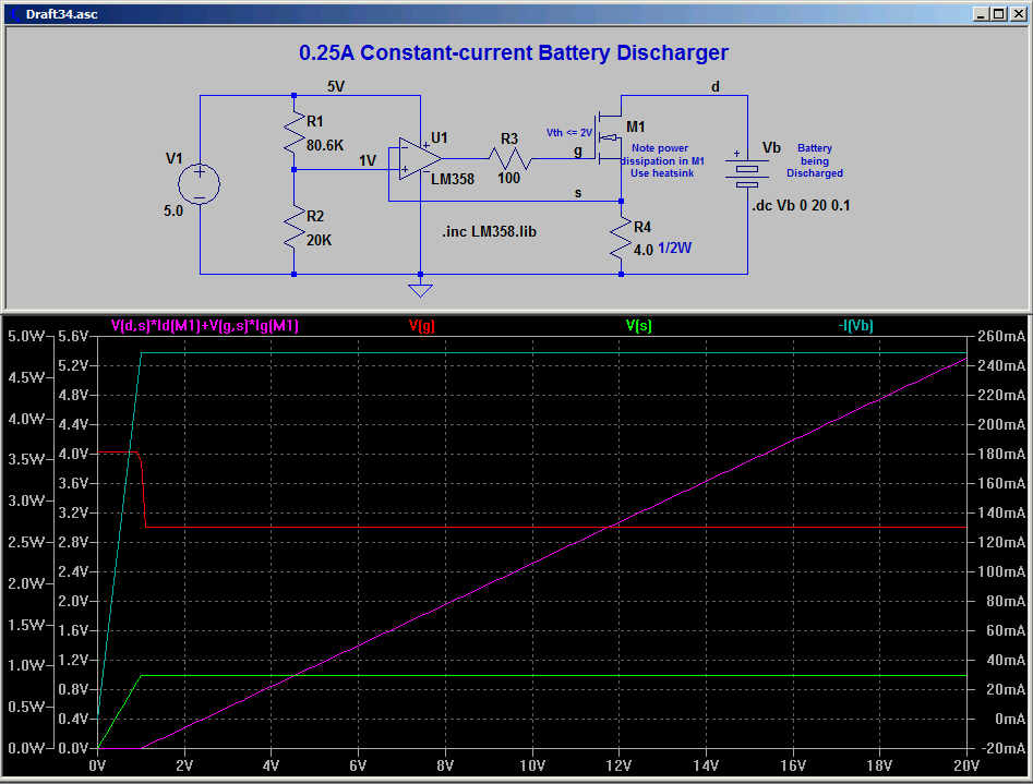

No, but per the original circuit posted in #1, the circuit is set up to maintain a constant voltage of 1V across the 4Ω source resistor. That implies that the drain current of the NFET is 0.25A and the gate of the NFET only needs to be Vth plus a small deltaV to make that happen.
As long as the Vth of the NFET is 2V or less, then even a LM358 type opamp has enough positive drive to turn-on the NFET sufficiently. Here is a simulation using a power NFET with a Vth of 2V. The LM358 compares the voltage at the source V(s) to a 1V reference voltage. The output of the opamp makes V(g) whatever it needs to be in order to force 0.25A through R4, so that the voltage at the non-inverting input just matches the one at the inverting input.
I plot V(s) [green], V(g) [red], -I(V2) [the battery current, blue] and the dissipation in M1 [violet] as a function of V(Vb), which shows that the circuit can be used with any battery voltage from 1V to ~20V, provided you pay attention to heatsinking M1. This means that the circuit is usable with a single NiCd cell, although it will only discharge it down to 1V.
When discharging a multiple-cell NiCd pack, I would stop the test when the battery voltage drops to less than 1.05*n, where n is the number of cells. As a multiple cell pack ages, it is no better than the weakest cell, because as the first cell craters, the load current causes the voltage across that bad cell to reverse, rapidly reducing the pack total voltage.

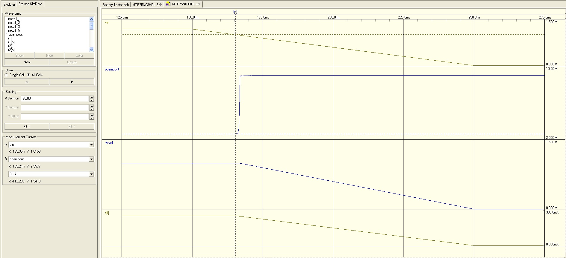

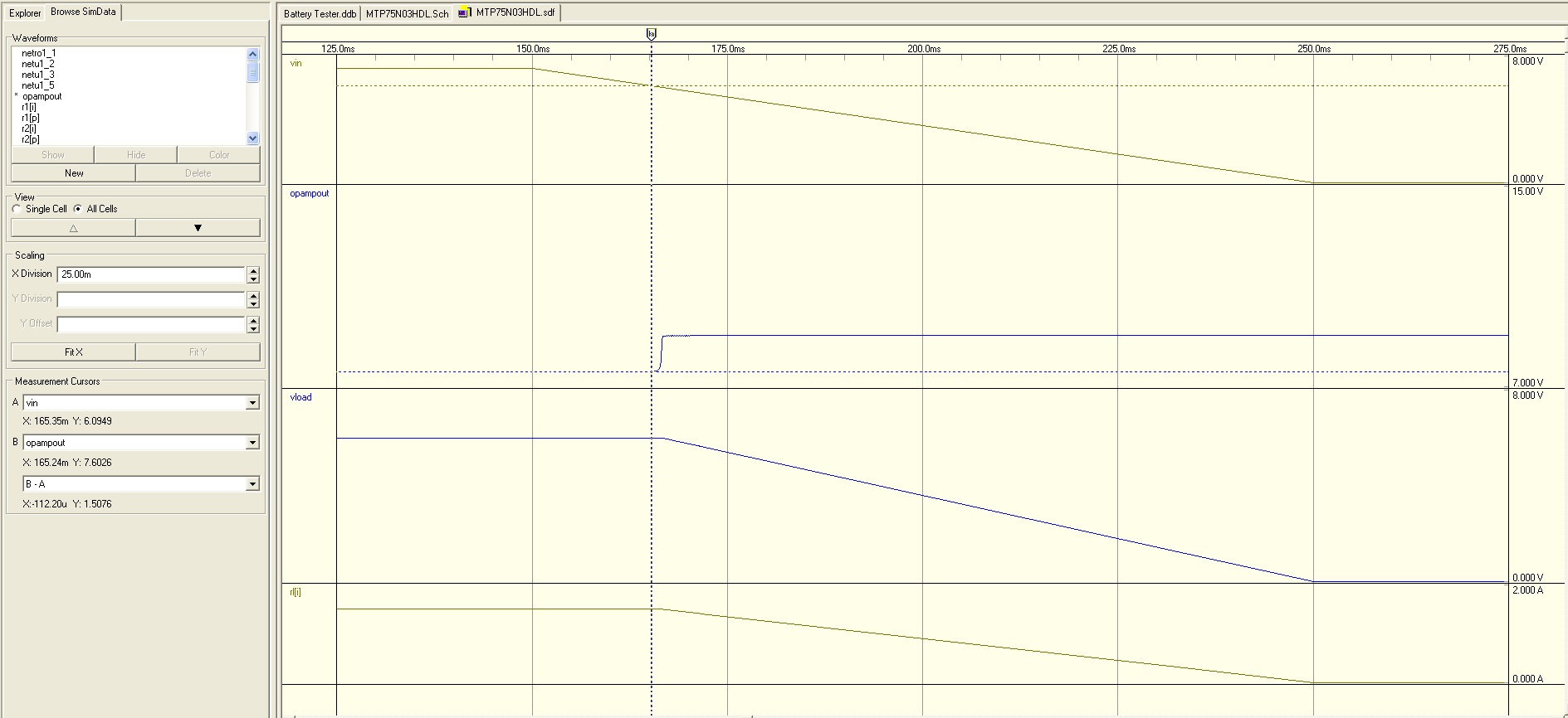

I was working from a breadboard circuit. I have returned to simulation to understand what is going on. Unfortunately, Mike, I am not following your post. Probably because I can't reconcile your simulation method with mine.
For 1v here is my simulation.
The Opamp output is 2.55V for a single cell (threshold =1v).
For two cells the output jumps to 3.55V
For 6 cells, the opamp output jumps to 7.6V.
Each of these datapoints is just to maintain the threshold of 1.0V*n cells (1, 2, or 6 as shown).
This is where I restarted the post. Trying to understand why the opamp output was increasing as the number of cells increase. Based on some of the points prior to the simulation, as the number of cells increase, the setpoint increases and thus Vsource increases, thereby increasing Vgate.
I think these simulations show what I mean, which doesn't seem to me to correlate with

In the event of trying to test my 9.6V, 10.8V and 12.0 V tool battery packs, I can't get the opamp output to go high enough.
P.S. I increased Vcc to 10V to get the 6 cell simulation.
In your simulation, the current from the battery is about 250mA for a single cell but the current (and the voltage to the gate of the opamp) are wrongly increased for a wrong battery current of about 1500mA for more battery cells. The battery current has increased because you wrongly increased the input voltage to about 7.6V that was supposed to stay at 1V. The battery cells are supposed to be in series, but do you have them in parallel instead? Do you understand the difference between series and parallel?
The independent variable in my simulation is the simulated battery voltage Vb (the horizontal plot X-Axis). The dependent variables I plotted are gate voltage V(g), source voltage V(s), Battery current -I(Vb) (which is flat regardless of Vb) , and Power dissipated (big expression) in the NFET (which increases linearly as the battery voltage increases..
I did a .DC analysis with a swept battery voltage Vb for all voltages from zero to 20V in steps of 0.1V. Yours looks like a .TRAN transient simulation which is not relevant.

With the NFET I used in my simulation, the output pin of the opamp doesn't ever have to go above about 3.5V, regardless of how many cells are in the pack. The output pin of the opamp only has to get to V(s) + Vth + Δ, where Δ is a few hundred mV. V(s) is 1V, because 0.25A*4Ω = 1V.
What is the Vth of the NFET you are using? If it is >3V, then you cannot power the opamp with only 5V; it should be powered with a 8V or 10V supply. If the Vth of the NFET is about 2V, like I used in my sim, then a 5V opamp supply is sufficient. If you change the opamp supply voltage, you will have to recalculate the voltage divider that provides the 1V reference voltage to the opamp.

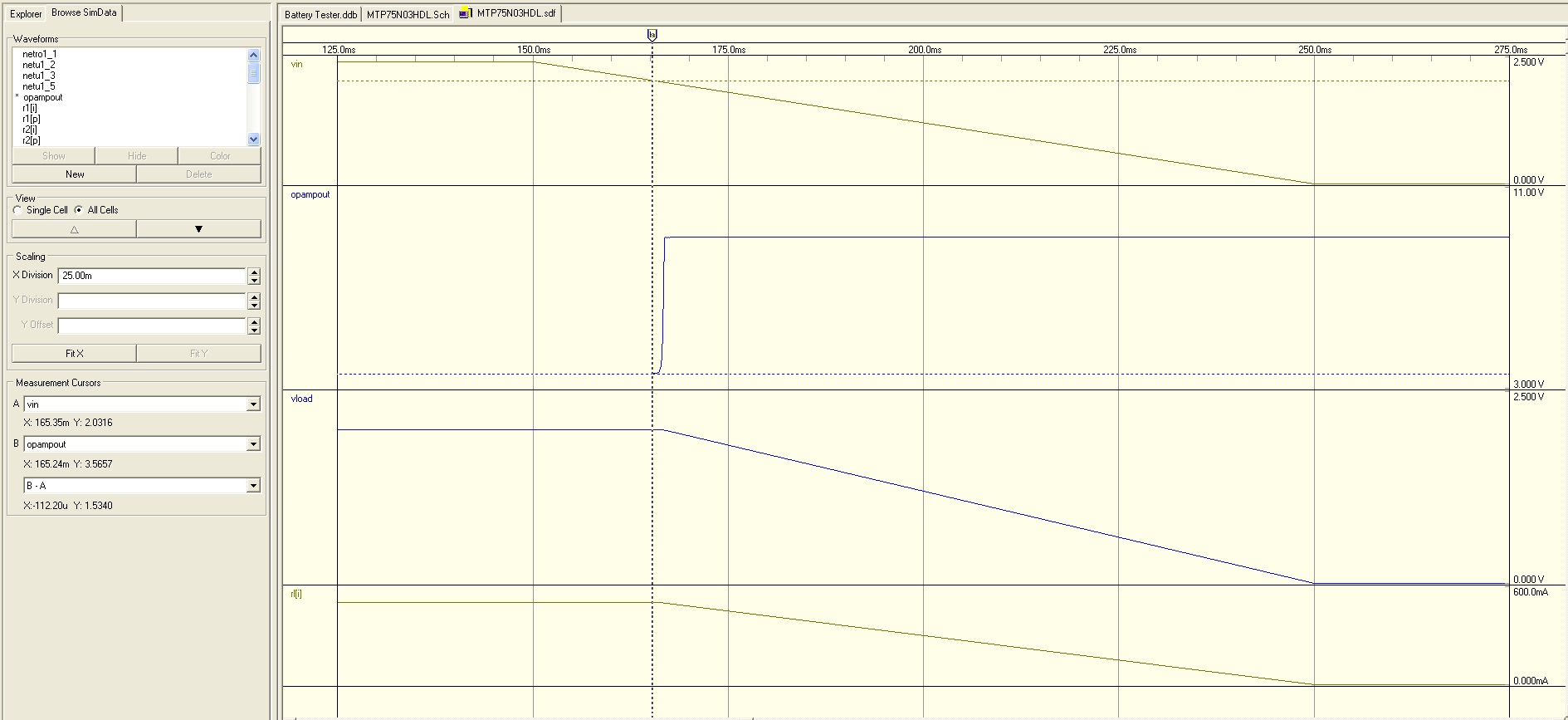

Yes, thank you very much. I just made a mistake. I forgot to increase the load resistor. But updating the load resistor is not going to lessen the fet source voltage.
Updated simulation for 2V and 8 ohm load.
6V and 24 ohm load.
As you can see there was only the smallest change in the opamp output.

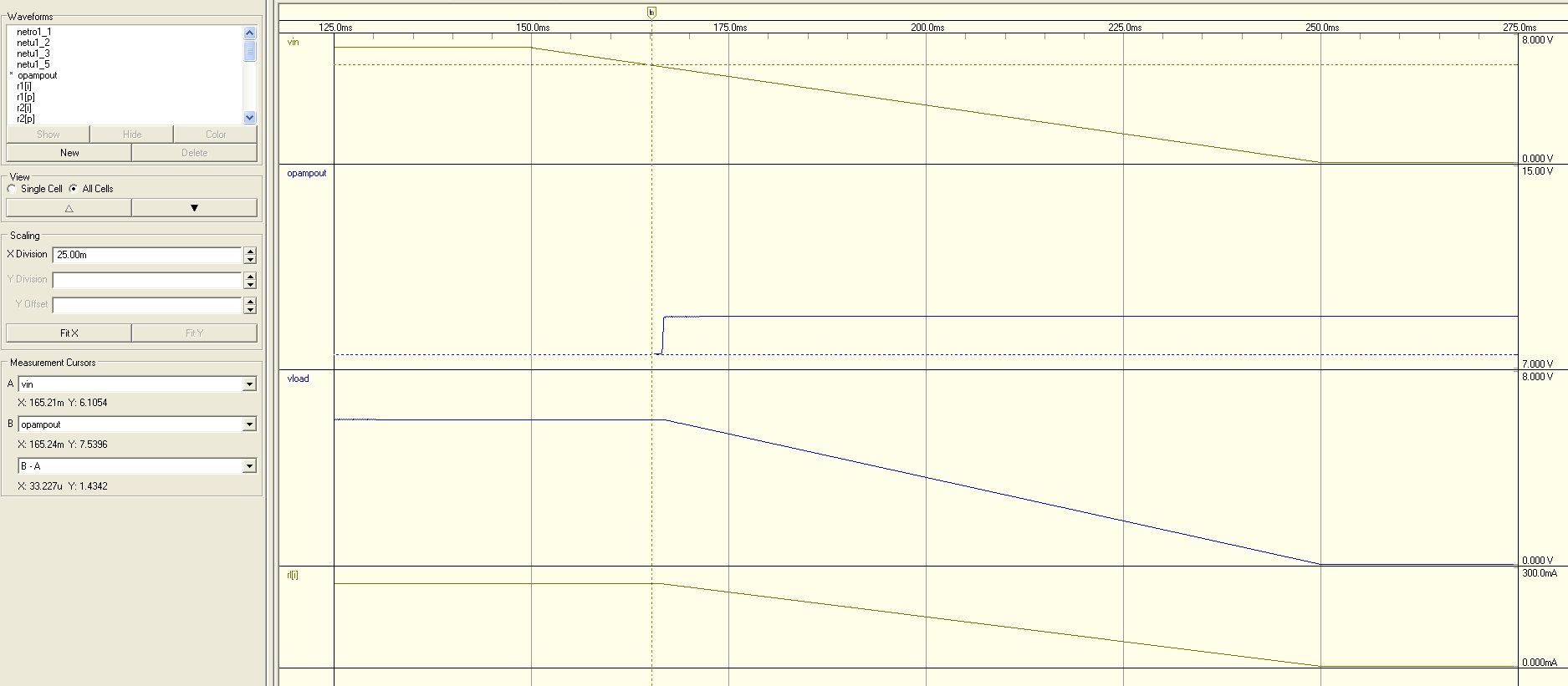

It has been too long since I used protel and a dc analysis. I took the short way out and did several transient analysis. I don't see how a transient analysis is not relevant. I just have to do a lot more simulations. I can see the EXACT same information in your simulation of a single cell using DC analysis as I can in my single cell transient. When I look at your graph, I just read it right to left starting at Vb=1.2V.
I am simulating a MTP75N03HDL fet with has a Vgs(th) of 1-2V. I have also increase the opamp power from 5V to 10V (which makes calculating the opamp setpoint resistors easier and gives the headroom for simulating a 6 cell discharge).

Ah ha! I see wheat is missing from the DC analysis, and the comment of my bad simulations by Audioguru was the key. As Audioguru pointed out, I neglected to increase the load as I increased the setpoint and cell count. The DC analysis increases the cell count (Vb), but neither increases the setpoint (Vs=n) nor increases the load resistance (which compensates for the increase in setpoint voltage to maintain the 250mA current).

Please post the actual circuit you are simulating, because without seeing your circuit, I cannot see what you are varying to get the results you posted.

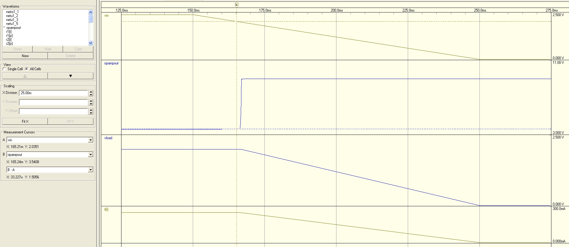

The layout of the circuit I'm simulating is exactly the same at post #1, only I'm updating the input to the opamp (Vs) to be 1.0*n cells, the load resistor (RL) to be 4*n cells, and Vbatt to be 1.2*ncells (to start and then decaying to simulate battery drain).
1 cell Vs=1.0V, RL=4 ohms, Vbatt=1.2V
2 cells Vs=2.0V, RL=8 ohms, Vbatt=2.4V
6 cells Vs=6.0V, RL=24 ohms, Vbatt=7.2V
All of these number are shown in or can be derived from the transient analysis trends.

Do you agree that in this method (Rl=4*n, Vs=1*n), Vs is going to rise to the point where the opamp will not be able to provide Vgs to turn on the fet?

Now that I think we are all on the same page and have the first item I didn't understand under control. I have something else that I don't understand in the same circuit. It also appears in both Mike DC and my transient analysis.
Using Mike's DC analysis, at any point when Vb >~1.2V, Vg = 3.0V. The FET should be off, but -Ib still shows 250mA of current flow. (the same thing is seen in the transient analysis while Vb>1.0*n) So either what am I missing, or why???
