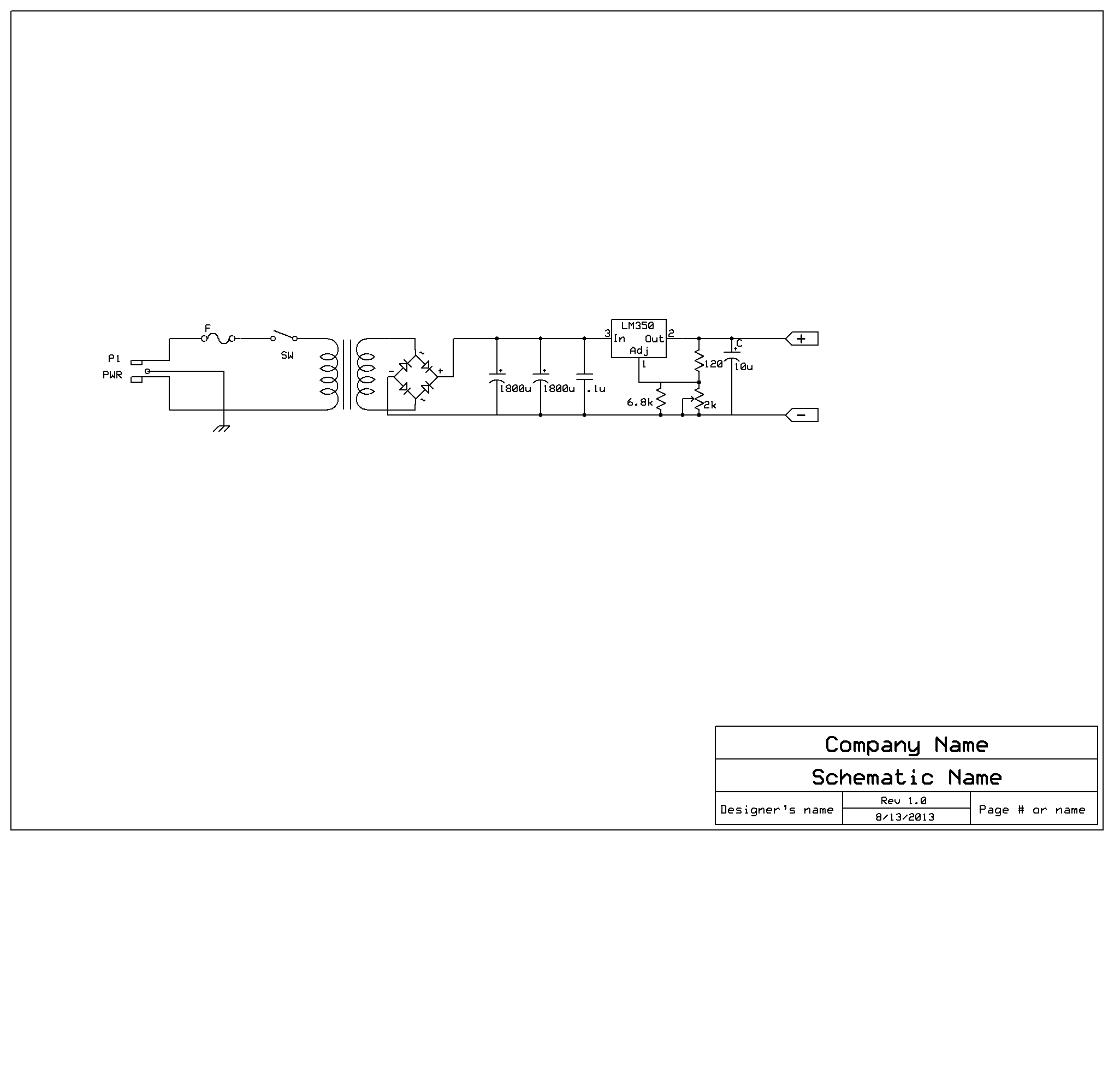

I sent the link for the Mouser order. I'll make a schematic of the whole thing in a bit.
Just click on the part and you can see the data sheet. Check the switch and the 10 turn dial to make sure they are what you have in mind.
Here is the schematic that I think matches the parts. Keep me honest. :rolleyes:

Thanks for all the help on this Ron, and KISS. It is greatly appreciated indeed.
I do have a few more questions regarding this project before I order the parts though.
For the heatsink, Im looking at Mouser, and the majority of the TO-220 heatsinks seem really small. Being that I will be ordering the rest of the parts from Mouser, if I can get the heatsink there as well that would be great.
My question is, if I run a fan, possibly 2, and have ventilation holes in the box, can I use a smaller heatsink? This may be completely off the wall as well, but what if I used an extruded aluminum case? If I mounted the IC to the case, would it work as a heat sink as well? I've just never done much with heat sinks, so Im not too sure what will work and what wont.
@ronv
Can you throw in a few surge supressors and put the protection diodes in?

Ok, so I've been doing some reading about heatsinks and size needed and all the math and what not. Im going to kind of think out loud here that way if Im totally wrong, I can be corrected.
The LM350T has a thermal resistance, junction to case, typically of 1.2C/W. So that means that, if mounted to a heatsink, and let say that Im running the power supply at 8V, then 10V*2A would be 20W dissipated as heat and the IC would heat 24C above ambient? If ambient temperature is 27C, then the IC would reach 51C under those conditions?
Im still not super clear on where the thermal resistance of the heat sink comes in, but the one I posted from Mouser has a resistance of like 1.3C/W. From what I understand thats how you base what temperature the heatsink will rise above ambient based on watts to the IC. So basically the heatsink would mirror the IC in terms of heat at that specific condition.
If operating temperature on the LM350 is 0~125C, then it sitting at 51C would seem to be fine? At least in my mind. Coupled with a fan and ventilation, I would think that I would be capable of staying well within the operating range of the IC?
This is true if you could keep the case at 27C. But alas the heatsink heats up. So the temperature junction to case is one part.
Not quite. Remember back a ways we talked about the cap charging up to the peak voltage? What that means is when (if) your line voltage coming in is 10% higher than nominal the input voltage to the regulator could be around 28 volts. So it would drop 20 volts X 2 amps or 40 watts. So we would have junction to case of 1.2X40 = 48 + the heat sink 1.3X40=52, + ambient = 27 for 127. There is a little more lost in the interface between the transistor and the heat sink but not much in this case because it needs no insulation from the heat sink. This is kind of a worst case number as your line voltage would have to be high while your voltage setting was low and you were drawing maximum current. My bet is you would be ok, but for sure you would be ok with the one from amazon that I posted. That one would make it without the fan if it was outside the box.
This is the other major part of the equation and needs to be added to the first part. Please also note that the heat sink manufactures are kind of sneaky - the 1.3C/Watt is with air. Without air that heat sink is 2.85C/watt.
