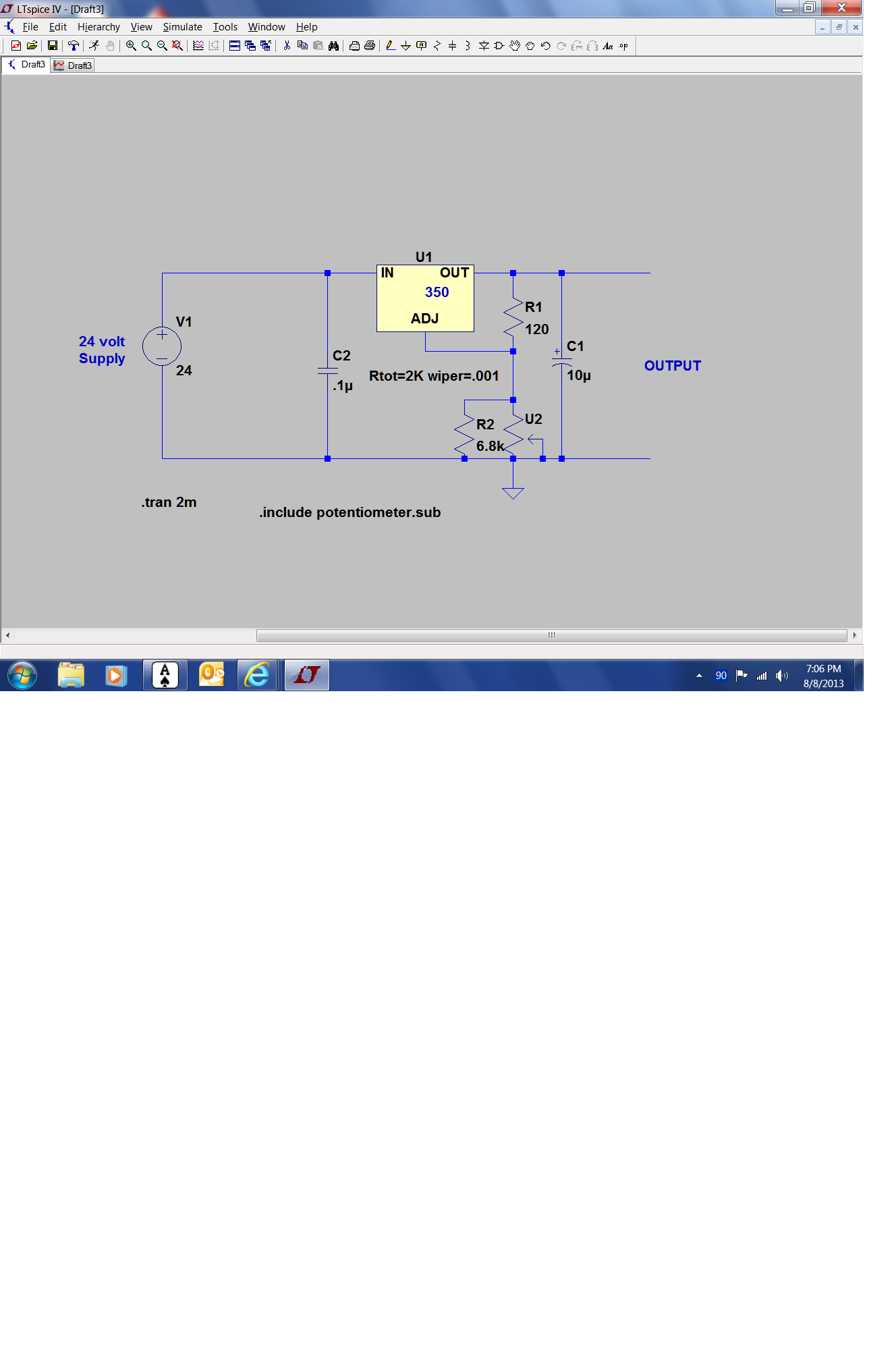

I am looking at making a 0-18VDC regulated variable power supply with a current of around 1.5-2A. I have been scouring the internet for the last 2 days and am having quite a bit of trouble finding something that I think would be suitable that's diagrammed in a way that I can readily understand and comprehend. (I'm not real good with knowing how to replace components or add potentiometers/rheostats and the like.)

There are a lot of regulators around that a pretty simple and inexpensive but don't go all the way down to zero volts - only to about 1.25. I suspect this might work. Do you?
Yeah, 1.25V would work. I was thinking about using the LM317 regulator which I think has the 1.25 minimum rating. One concern I do have though is the current rating. I know that it is recommended to have close to 2A on a tattoo power supply, but I think the LM317 is rated at 1.5A. I think that would work but is the amperage current listed on a product the max amperage under max voltage? If that makes any sense?
Would the 350 be a direct replacement to the 317? That would work alot better than the 317. As for the chassis, I was thinking of making my own out of sheet metal, similar to a guitar amp chassis, and then mounting the components, insulating using rubber washers or something.

Yes just like the 317 - works the same way just higher power.
I'm thinking something like this to get from line voltage down 24 volts then just use the 350 for the adjustment. Let me check around for a heat sink so you can get an idea of how big it will be. There are better ways to do this but they are also more complex, so lets go a little further. Maybe someone has a ready made one they have seen. Most I have seen are pretty expensive.

could I then just go in and run the VR circuit that RonV posted?

So lets say that I am using RonV's VR circuit, I would just cut off the schematic I posted after the filter caps and then add in his circuit?
One problem no one has mentioned is the power dissipation in the regulator. An LM350 may be able to supply 2 amps under some conditions but not as you're thinking about it.
Say you supply the regulator with 20 volts which will give you about 18 volts maximum. If you adjust the voltage down to 2 volts and you're drawing 2 amps from the circuit, the power dissipated by the regulator would be
(Voltage drop across regulator) x (current) = 16 x 2 = 32 watts. Ever burned your hand on a 60 watt bulb? This is a lot of heat to get rid of!

The regulator has to dissipate (Vin-Vout)*Iout Watts of heat since it's a linear regulator.
So lets just say (22-2)*2 or 40 Watts as an example just picking numbers. That's a lot of power. The point is, the thing is going to get HOT!
So, wide-range becomes a problem.

The LM350 is the 3A big brother. In both cases it takes two resistors to set the output voltage, one can be variable.
