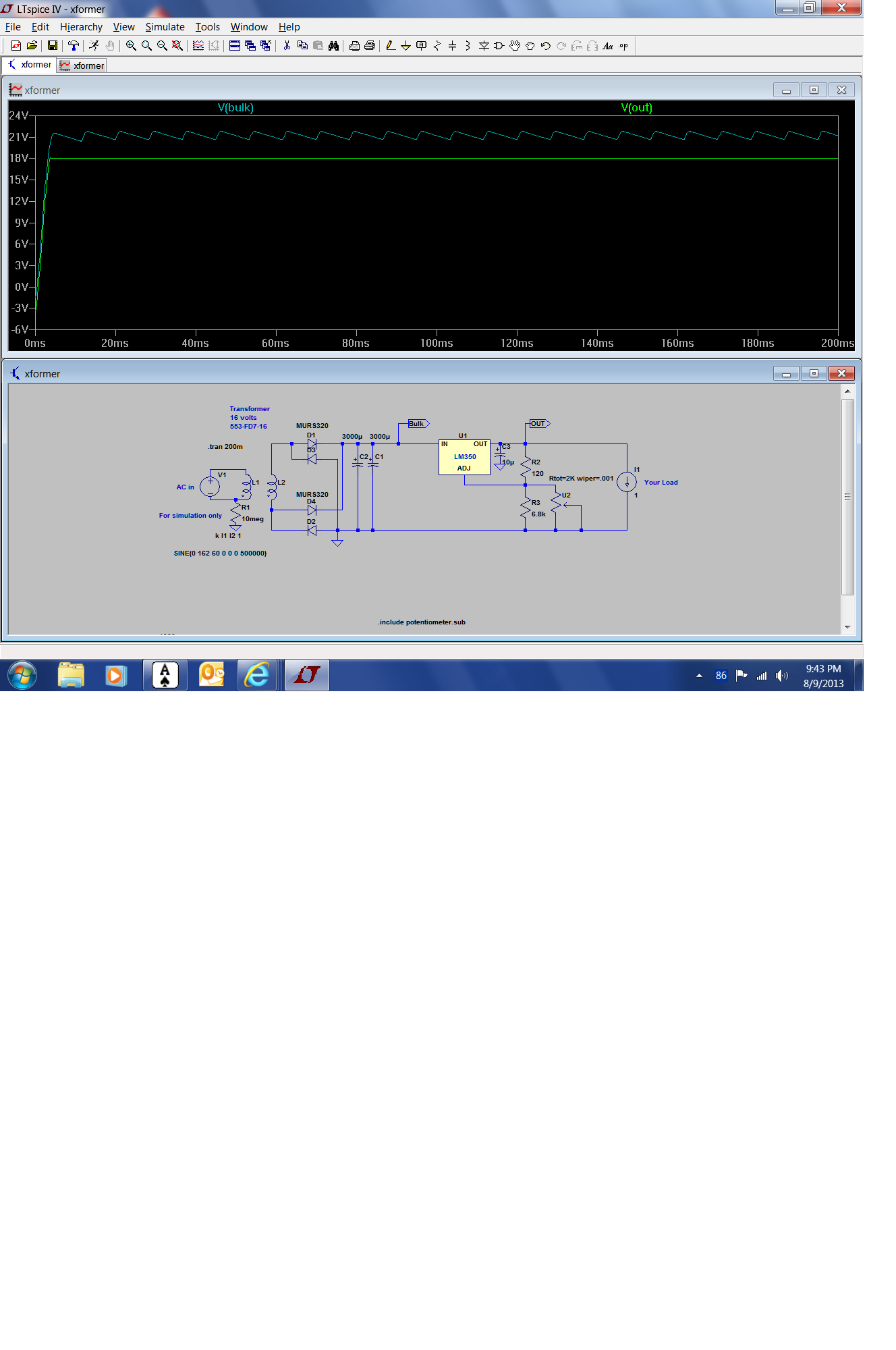

I made up a schematic that seemed to make sense to me, using the power source from the old "toaster" power supply and then adding on RonV's circuit on the end. Im going to post it up and see what yall think.
Pardon the fact that there are no real values for components, Im still trying to figure those outs.
That's kinda funny. use a rectangle for the regulator, In, Out, adj.
I'd remove the parallel combo of R3 and the pot and replace with a resistor A + pot + resistor B + ground
We can then figure out the aprox values to give you a min/max range.

Lets also change to the 16 volt transformer (PN in schematic). This will drop the power dissipation a bit which will cool thing down. There may be a little ripple get thru the regulator with this one when the voltage and current are at maximum.
Kiss, the regulator we were looking at is in the TO-220 package so it doesn't need all the TO-3 stuff.
The values for the adjustment resistors in the schematic should give a range of 1.25 to 18 volts. The parallel resistor keeps you from setting the voltage higher than 18 volts with a 2K pot.
The simulation shows the "ripple" and the DC output from the regulator at a nominal load.

OK, the 2A makes the TO220 package OK in my book. I was also looking at the other way of doing a range. 6 in one and a half dozen in the other.
