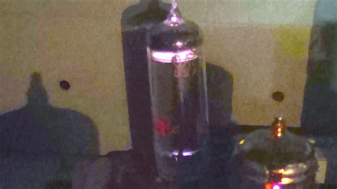

Im working on making a homemade high speed (around 500hz) trigger tube/neon bulb oscillator and am wondering if my circuit idea would actually work. My idea is to have a capacitor charging through a resistor that reaches a certain voltage and a trigger tube fires. I was wondering how to make it oscillate? My initial thought was to run a relay coil in series with the tube so when it fires it would cause the relay contacts to short the cap starting the process all over again. Does anyone know if this will actually work in practice?
Horribly drawn schematic below lol.
Thanks in advance -Ray

A neon in series with the trigger coil, across a capacitor charged by a resistor, will inherently oscillate as the neon switches to a low resistance when it fires and discharges the cap, until the voltage is so low it extinguishes.
You may also be able to get it working using a small thyristor triggered by a diac, in place of the neon.
A relay will not work consistently at that type of speed, but a simple neon trigger will work fine.
The cap does not have to be discharged all the way down to 0 V for the circuit to be reliable. As long as it discharges down to a repeatable point, the output frequency will be stable. So, what would cause the cap to stop discharging at a voltage greater than 0 V ... ?

I'm aware I could just make a neon oscillator without the relay but I was hoping to use a dual switch relay to switch a slightly bigger load than what the neon circuit alone could handle
I think fully discharging the capacitor is more reliable
There is no reason to discharge the capacitor below the point where the neon bulb extinguishes.
Why do you think fully discharging the capacitor is "more reliable"?
Reliable how?
That's a pretty important detail to leave out of the original question.
The issue is the relay coil current, because a neon bulb is not a power-handling device. With what used to be called a "plate relay", a relay with a very high resistance coil, the relay coil could be the current limiter for a standard neon bulb oscillator.
If you can't find the right coil resistance for this to work, you can add a small MOSFET to the standard oscillator circuit as a relay coil driver.
How much current do you want the relay contacts to switch? This is a major factor in determining the relay coil power.
And as above, 500 Hz is very fast for a standard relay.

If you want to switch a load, drive a transistor from the neon osc or use a transistor or IC oscillator controlling a power device. Mechanical relays the operate at accurately at high speeds are very rare and expensive!
An old Carpenter relay may work consistently up to possibly about 100Hz with a bit of luck, tuning and appropriate drive circuits... They were the "go to" relay for passing serial data - about 60 - 70 years ago.
With electronics and optocoupler alternatives, they are long obsolete.

How is my entire premise wrong exactly? I have a bunch of old parts and I like to build stuff the old fashioned way even if it isn't the most efficient way of doing things. I also wanted to use a neon bulb because I have a bunch of them and I think it kinda looks cool.

I didn't even think of driving the transistor off of the neon bulb. I guess that will work and be easier than messing around with relays.

Note you could sub a OB2 or OA2 regulator tube for the Neon as that is capable of
a lot more current, still fairly available. Or the RCA 991 bulb.
