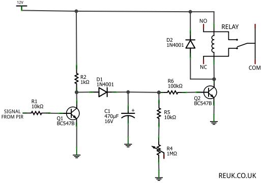

So I found this circuit and thought it would be perfect for what I need. I put it together on a breadboard and it always has a high output. So it's not inverting. In other words the relay is always on. The only difference is that I am using 2n3094 transistors, but I thought they should still work in this instance. Can anyone see what the problem is? Help!
I should add that this is supposed to go high when there is a signal from the PIR and stay there from 5-75 seconds based on the setting of R4. But when I connect it it goes without a signal and stays there.
With nothing connected to the input (Left hand end of R1) transistor Q1 will not be conducting so its collector will be at near +12 volts. As a result of this Q2 will turn on (As it's base is connected to about +12V via D1 ans R6.) As Q2 is conducting the relay is energised. If you connect your PIR (Remember that it's contacts are normally closed.) between the left hand end of R1 and +12 volts then Q1 will be turned on which will cause Q2 to be turned off. In all of the methods already suggested the transistor base (Or gate in the case of a mosfet.) was being pulled towards + 12 volts by a resistor but the PIR contact would be connected between the base and 0 volts shorting out the base emitter junction (gate and source in the case of a mosfet.) thus preventing the transistor from conducting until the PIR was activated causing it's contacts to open.

Thanks Les, but if I connect +12 to the left side of R1, then it should then cause (ultimately) the relay on the schematic to open (after any delay caused by (R4)), and it doesn't. If you are positive the schematic is correct then I guess I'll try again.
What is the coil resistance of your relay? 700 ohms?
The value of R6 is so high that the relay coil resistance must be 4700 or 10000 ohms which is not possible. For the relay to turn on then Q2 must be a darlington transistor or a Fet.

The relay is turning on. It won't turn off. And yes it is a normally open relay so it's on because it's being pulled on.
The 100k resistor R6 has a voltage across it of 12V - 0.7V - 0.7V= 10.6V then it provides a base current to transistor Q2 of 10.6V/100k ohms= 106uA.
The datasheet for the 2N3904 transistor and almost all little transistors say that for it to saturate properly then the base current should be 1/10th the collector current. Then the relay coil must use only 106uA x 10= 1.1mA and have a resistance of 12V/1.1mA= 11k ohms.
Your transistor turns on and stays on because it is shorted or has its pins mixed up.

I think you are right. I have a bunch of other 3904's so I'll try again with new ones.

R4/5/6 have such a high combined resistance that transistor base leakage current might be enough to prevent the relay dropping out.

But I don't have any 2n7000 so I'm using the 3904. Otherwise I'd do the one you recommended.
I think that would be by design. R4 and C1 are to delay the relay from turning off for 5-75 seconds. I think it's right because I think it's working for me now the way it's supposed to. I haven't had much time to test it though to make sure.
