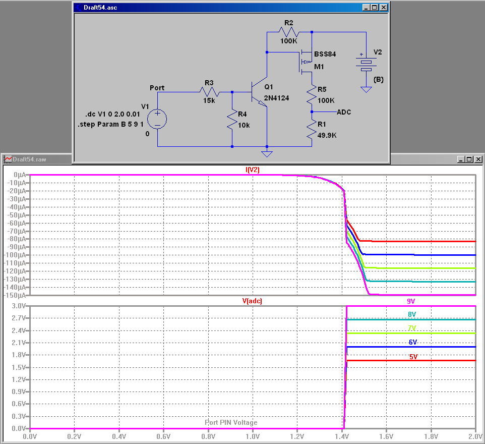

I am working on a microcontroller (this post is not microcontroller specific) project, part of what has me stuck is controlling a voltage divider to check the battery level. What I have done is this:
The gate of T2 goes to a microcontroller pin, which is either 0 or 3.3 volts. The battery voltage is read between R1 and R2. I use the voltage divider to make sure the voltage is not too high for the ADC on the microcontroller. The battery is a 9 volt battery. R2 and R3 are 10K and R1 is 100K. Both of the MOSFETs are "logic level". The p-channel is a FDV304P and the n-channel is a BSS138LT1.
The circuit works OK, but still has 10-15 microamps of current flowing when the gate of T2 is zero. Since I haven't used MOSFETs before, I don't know if this is good or not. Ideally, I'd like to do better since this part of the circuit is before the regulator (which can be shutdown) so it is always "on".
I don't need high accuracy here, it's just a battery indicator.

Yes, in fact the "logic level" ones are more speacialized. Only the Nfet needs to turn on with a Vgs of ~1.5V, and since its pullup is ~100k, who cares what its on resistance is... The PFet in your circuit gets 5+V, so it doesn't need to have a low Vgs, and as long as it has an on resistance that is small compared to 100K (<=1K), then it will not degrade the accuracy of the ADC reading. I would dump T2, and replace it with an NPN transistor. It has a Vbe "threshold" of only 0.65V, and low-leakage when it is off...
Good points. I'll give that a try. I just have to adjust the base collector resistor for the range of the battery voltage (about 9 to 4.5 volts).

Here is a suggestion:
ps: you need to check the Spec for the input current to the ADC. The source impedance of your voltage divider may be too high. That could cause a large error in reading the battery voltage. A capacitor across the ADC input will lower the AC impedance, but you will have to program a delay between turning on the voltage divider and then reading the ADC...
