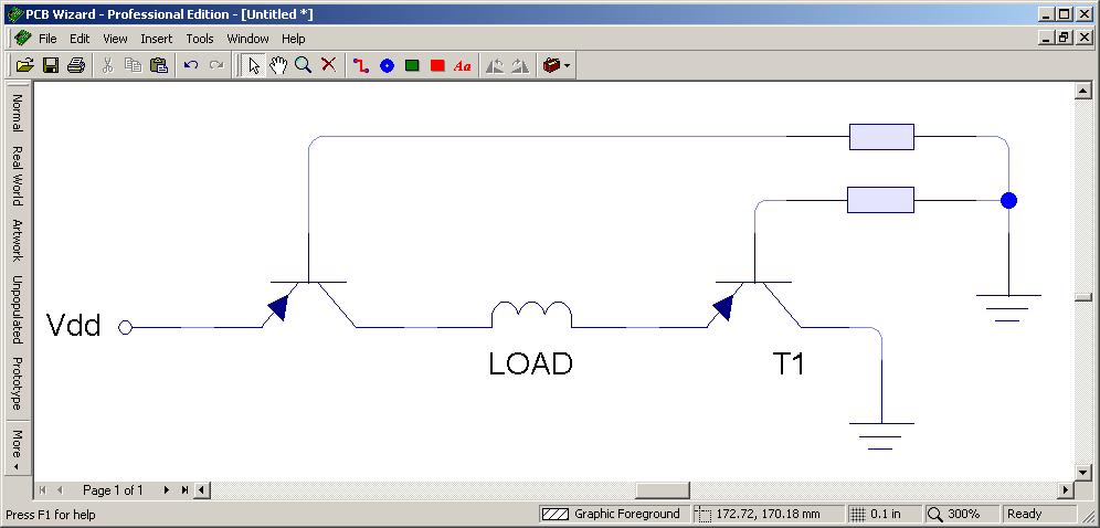

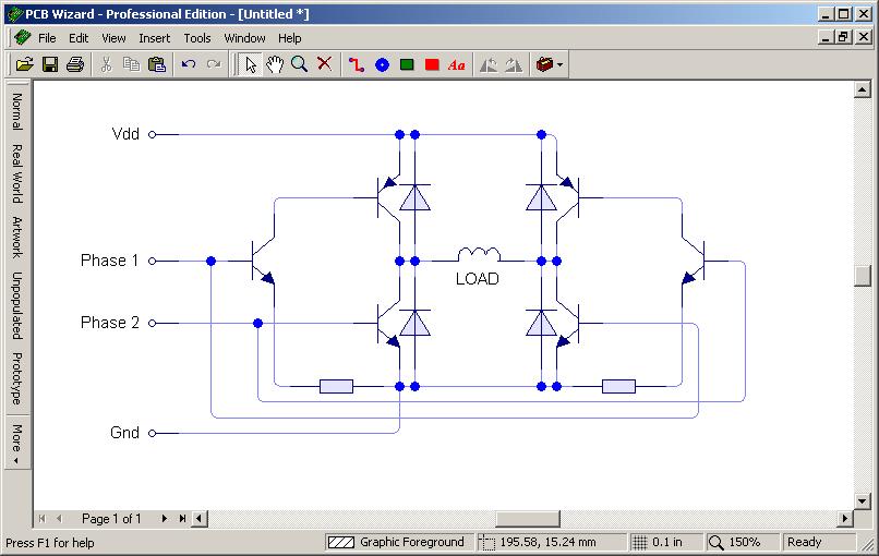

I am currently researching H-Bridges to drive bipolar stepper motor using a PIC (PIC18F2550 to be precise). Since this is in the context of a CNC machine/milling machine conversion, the drive system has to be quite (very) powerful (60V maximum, at variable currents - 12A maximum).
I have done and prototyped most of the parts of this, however, there is one thing I do not quite understand. As far as I understand, a normal H-Bridge is as in the 'Normal H Bridge.jpg' attachment, however, especially in applications involving MOSFETs, I have increasingly encountered H Bridges where the transistors (or MOSFETs) are all the same polarity (the 'Abnormal H Bridge.pdf' attachment exemplifies one such application). That is by no means an isolated example, as the same is found in RC car electronic speed controls.
More specifically, I do not understand how the transistor/MOSFET to the emitter/source of which the load is connected can switch on/off: surely if the vast majority of the voltage drop occurs on the load, then the potential difference between the emitter/source and the base/drain disappears, thus stopping the transistor/MOSFET from opening? (the simplified version is demonstrated in Simplified.jpg).
I am specifically interested in how H Bridges which all use the same polarity work, as my chosen MOSFET source OnSemi has N Channel MOSFETs with a minimal internal resistance of 9.5 mΩ, but P Channel of 80 mΩ, hence, using an N Channel MOSFET is not only cheaper, but also reduces heating during operation. The data sheet of the specific MOSFET I have in mind is also attached.

You can use an N-channel if you can supply the gate with 70V.
By the way are you using BJTs or MOSFETs because according to your schematics you're using BJTs?
Yes, I realize now, I should have used MOSFETs in my schematics to save confusion. They're supposed to be MOSFETs, sorry.
In terms of 70v, can the MOSFET handle that, in light of the fact that the datasheet states that the gate can have ±30v maximum?
Also, to open the MOSFET needs there to be a lower voltage at the gate than at the source, in simpler terms, a current needs to flow in the same direction as the arrow?
Applying 70v to the gate would mean the voltage is higher at the gate than that at the source, hence the MOSFET wouldn't open?

Are you talking about N-Channel or P-Channel? When using all N-Channel fets, you need a VGS that is greater than the supply voltage in order to turn the upper fets on. The IR21844 ICs that I used in that high power hbridge have a built in boost converter to generate enough voltage above the supply to turn on the upper fets.

In my schematic there, all you have to do is connect the PWM output of the PIC to R18.
My circuit will always be applying current to the motor. (When at 50% duty cycle, it will drive the motor forward 50% of the time and backward 50%.)
I only ran mine up to 45V, but it only depends on what the fets are rated for.
To open (turn off) a MOSFET you normally put the gate at a voltage near the source voltage. The only current that needs to flow it that required to discharge the gate capacitance (which can be rather large for high current MOSFETs). Thus to rapdily turn a MOSFET on and off (which is usually desired in a switching application to minimize transistor dissipation) you need a gate driver that can rapidly charge and discharge the gate capacitance.
Both gate and drain voltage maximums are referenced to the source terminal. Thus you can apply more voltage to the drain-source then the the gate-source. But this is not usually a problem.
For example, if an N-channel MOSFET is in the top of the bridge, you may be applying 80V (to ground) to the gate but, since the transistor is on at that point, the transistor source is near 70V, so the gate-source voltage is only 10V, well below it's gate-source limit.

According to my understanding of the circuit, the voltage output to the gates of the MOSFETs is no greater than the supply voltage (and less a diode drop for the bootstrapped high side). Thus you would need MOSFETs that carry the required current at a 4V or so if you operate it from the 5V PIC supply voltage. Those may not be readily available for your 12A, 60V application. So you may still need an additional power supply to power the bridge (they show 12V in the data sheet).
That HIP4082 looks like it would work and its not too expensive either. My H-bridge project got expensive pretty quick once I started blowing fets and those IR21844's.
Looks like this chip is able to handle a 5V inputs for any VDD. (See VIH and VIL on pg 4: The chip sees any input greater than 2.5V as a logic high and anything below 1.0V as a logic low).
Even if the chip couldnt handle 5v inputs, you could just use a single 12V supply and use a 7805 VReg to make the 5V for the PIC. The PWM output of the pic would have to drive an open collector transistor to get the pwm signal to +12V.
Oh yeah, I'd strongly recommend adding overcurrent protection. I added it to mine after nearly catching my breadboard on fire. I had just got it working and was paying attention to the motor when it stopped. I look over and see a big cloud of smoke coming from the breadboard. Turns out it was a mosfet failure and it shorted my 45V bus. Heres a pic:
