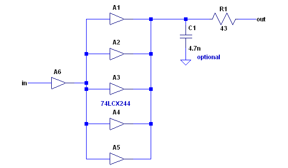

Here is the simplest circuit I could come up with. The capacitor slows the transition times to reduce ringing at the end of an unterminated 50 ohm coax. You should test it with the load on the end of a 50 ohm coaxial cable. To drive 3.3V logic, you will have to leave out the 50 ohm resistive termination on the end of the cable. I would add a 50pF dummy load for the test.

We did a test today and using a series resistor of 67ohms on each output of the LCX244 driver but no load capacitor and the signal was so much better than the LCX760. There was a small amount of ringing on each transition which was only obvious when using the oscilloscope in 100meg bandwidth mode and X10 probe. When limiting the bandwidth to 20Meg or using a X1 probe there was no ringing at all. There were no other spikes or other undesirable pulses which we were previously getting. I did not try any pull down capacitor but would expect it to filter out any remaining ringing on the signal.

Why 67 ohms? Did you parallel outputs? And did you test the output at the end of a sizeable length of coax?
Why have you used 43Ω instead of 51Ω?
I used a 67 ohm resistor as it was the closest size to what I wanted that was available at work. Based on the maximum current drive capability of the LCX244 if I put a 50R resistor between the output and GND the current will be greater than the spec from the data sheet with a 3.3V output.
