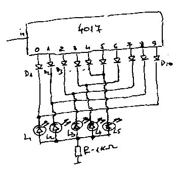

Bellow is what was meant by 5x2 selector switch. Actually you would need
10x2 to swap all 10 outputs.

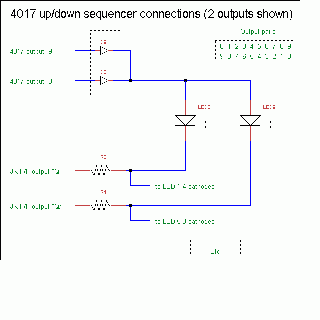

You can achieve a similar effect using a flip-flop in place of the second 4017. As others have pointed out, the 4017 can only count in one direction.
Simulating a bi-directional count on the 4017 (using all 10 outputs) requires an additional "state" bit. In the partial schematic shown below, a negative-edge triggered JK flip-flop is clocked using the Cout pin from the 4017. The JK should be wired as a toggle flip-flop (both J & K inputs high). The flip-flops' "Q" output is low during counts 0-1-2-3-4, then high for counts 5-6-7-8-9-0-1-2-3-4, then low for counts 5-6-7-8-9-0-1-2-3-4, etc...
The 4017's output pins are wired in pairs as shown, (0,9), (1,8 ), (2,7) etc. The diodes shown in the dotted lines can be replaced by 2-input OR gates, either steering diodes or gates are needed to prevent output contention. Since only one output is on at a time, only two current-limiting resistors are needed
One thing to point out, the LEDs on the end (0 & 9) stay on twice as long as the other LEDs. If you want all of the LEDs to be on for the same amount of time, add an 11th LED (LED10) and connect output pairs (1,9), (2,8 ), (3,7) etc. together. In this case, output 5 drives the same LED in both directions, saving a diode/OR gate. The diodes on outputs "0" and "5" aren't logically needed, but are left in for matching LED light levels. You could also use four 2-input OR gates (74HC32) in place of the diodes.
A few more notes: The CD4017 outputs don't have much drive capability, you may want to use the 74HC4017 instead (Be aware the 'HC parts have a maximum Vcc of 6 Volts). Either way, it would help to use high-efficiency LED's (2mA drive). The JK flip-flop should be a negative-edge triggered version, like the 74HC112. If using a positive-edge version like the CD4027 or 74HC109, Cout from the 4017 needs to be inverted. Remember to tie reset pins to their inactive states, and clock enable pins to their active state.
I haven't tried the circuit out, so it may have some problems. Good luck!

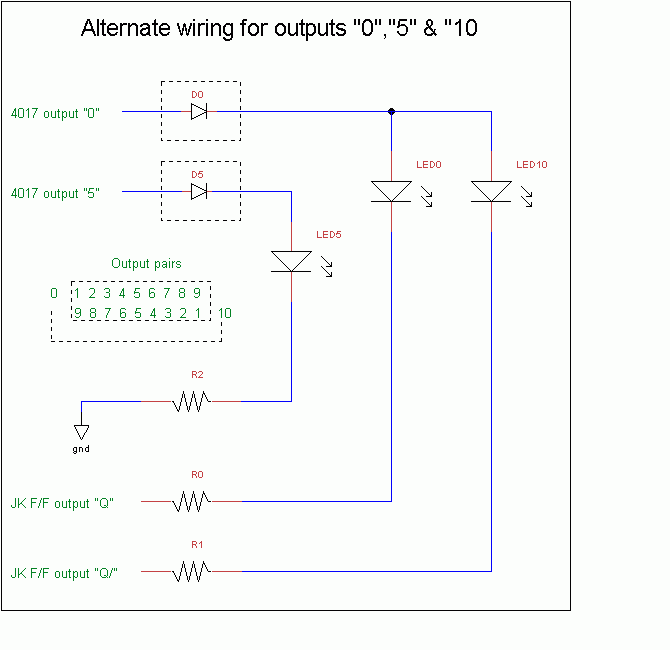

Edit: I just noticed the comments in the attached schematics show doubled output pair connections. The output pairs for driving 10 LEDs are (0,9), (1,8 ), (2,7), (3,6) and (4,5).
The output pairs for driving 11 LEDs are (1,9), (2,8 ), (3,7), and (4,6).

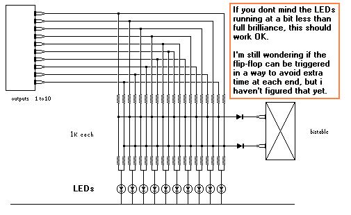

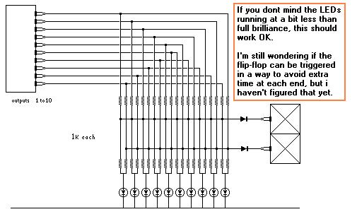

Ive drawn up a skeleton diagram,
i hope its method is clear.
In this arrangement the bi-stable doesn't necessarily
need to be a flip flop, the instruction to change
state could come from different places.
I am still thinking about each end of the 'scan' and
wondering if triggering the bistable could be arranged
to avoid the extra time at each end of the 'scan'.
Maybe it wont notice ...
Regards, John :)

Error,
excuse me, ive drawn the bistable incorrectly.
i did not mean to show it as two bistables.
rather than edit out my error, i am posting a correction.
Sorry about that.
John :oops:

Edited version of my previous submission. I have had second thoughts.
The circuit submitted by Laroche73 will not work properly. It will flash each LED twice per cycle. For example, LED 0 will light at states 0 and 9.
The circuit submitted by john1 won't work either. But it could be made to work with some changes. But you would need to use transistors as drivers since the current source capability of the 4017 may not be adequate.
A simpler solution would be to use a 10 pole change over switch or its electronic equivalent.
However, triggering the bistable is not a problem.
If the Bistable is a negative edge trigger, connect its Ck to output 9 of the 4017.
If it is a positive edge trigger, connect its Ck to output 0 of the 4017.
Len

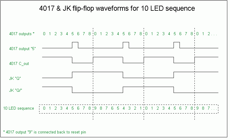

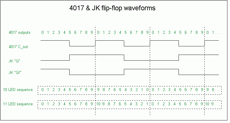

ljcox, take another look at the partial schematics I posted. The key to the circuits' operation is the extra "state bit" provided by the JK flip-flop, and when it's clocked. Although the output pairs from the 4017 are wired-OR, the return path alternates between the JK flip-flops' Q and Q/ outputs. The flip-flop is clocked using "C_out" from the 4017, so the state bit changes on the rising edge of output "5" (Sometimes a picture is worth a 1000 words, so I've attached a timing diagram). You're right though, "C_out" doesn't need to be used as the clock source. For a rising-edge triggered flip-flop, using output "5" as the clock source will accomplish the same thing (also, for a negative-edge triggered flip-flop, using output "4" as the clock source would work identically to using "C_out", the only difference is the duty cycle). The flip-flop could also be a D-type, as long as both "Q" and "Q/" outputs are available ("Q/" would be wired back to the "D" input to make a toggle flip-flop).
Initially, the "Q" return path is active (low) for counts 0-1-2-3-4, then the "Q/" return path is active for counts 5-6-7-8-9-0-1-2-3-4, then the "Q" path is active for the following 10 counts and so on (It helps to think of the circuit as a state machine having 20 distinct states).
This means the LED sequence for the 10 LED version is 0-1-2-3-4-5-6-7-8-9-9-8-7-6-5-4-3-2-1-0-0-1-2...
the LED sequence for the 11 LED version (equal ON time for all LEDs) is 0-1-2-3-4-5-6-7-8-9-10-9-8-7-6-5-4-3-2-1-0-1-2-3...
With the 10 LED version, it's true that LED 0 will light at 4017 states 0 and 9, but only when the flip-flop "state" bit has the correct polarity. The "knight-rider" effect is achieved. During the first 0-9 count sequence, output "0" lights LED 0 because "Q" is low, then output "9" lights LED 9 because "Q/" is low. For the second 0-9 count sequence, output "0" lights LED 9 since "Q/" is still low, and output "9" lights LED 0 since "Q" is low at that time. As mentioned in the earlier post, LEDs 0 & 9 stay on twice as long as LEDs 1 - 8.
For the alternate setup with 11 LEDs, each LED is on for the same amount of time, and output "5" only needs to drive one LED. Output "0" drives LEDs 0 & 10.
twisted_iggy - it looks like the design can be done with the parts list you were given, plus some steering diodes or OR gates, which are needed to prevent output contention. You're right, it does seem a bit complicated for a high-school electronics class. I'd ask to see your teachers' solution first :wink: .

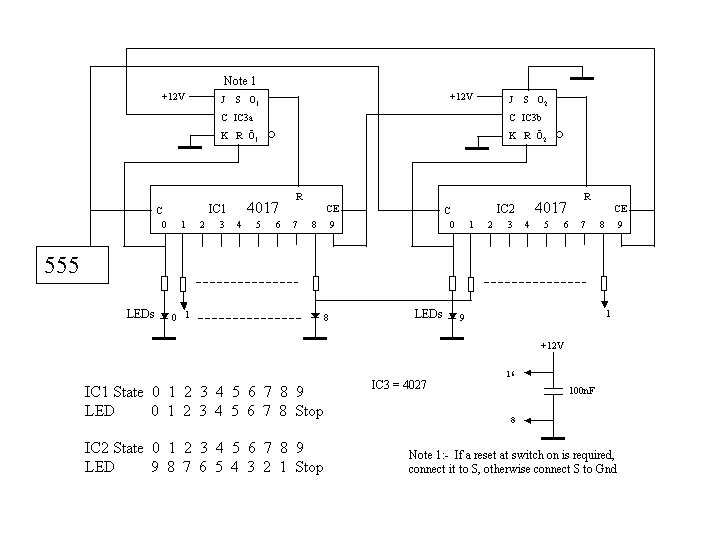

4017 connections revisited
My apologies, laroche73, I had missed the point about the FF clocking at 5. However, it does not meet one of the teacher's criteria. ie. that the count sequence be 0,1 ,2 ... 9, 8, 7 ...1, 0, ...
Incidentally, I don't know what the "knight rider" effect is.
I have attached an alternative that I believe meets the teacher's criteria.
Len

You are correct, LEDs 0 & 9 stay on for an extra cycle in the 10 LED circuit, that's why I included the 11 LED circuit. Technically, the circuit doesn't meet the class requirement, but it does show the back and forth effect can be done for 10 or 11 LEDs using a single 4017 and one flip-flop.
Edit: After giving it a little more thought, it's pretty easy to modify the 11 LED circuit to use 10 LEDs and have the desired sequence. All that's needed is to make the state machine have 18 states instead of 20. Tying output "9" back to the 4017's reset pin does this. A revised timing diagram is attached. Output "0" drives LEDs 0 and 9, and the output pin pairing is (1,8 ), (2,7), (3,6) and (4,5). The first nine states drive LEDs 0 - 8 in the forward direction, the next nine states drive LEDs 9 - 1 in the reverse direction, and so on. The same idea works for fewer LEDs as well. To drive 8 LEDs the state machine should have 14 states, so output "7" would be tied back to the reset pin.
Incidentally, the circuit you posted looks fine logically, but may have some trouble driving the LEDs. The 4017 has a low output drive capacity, and the current-limiting resistors between output pairs act as voltage dividers (ex, when IC2 output "1" is high and IC1 output "8" is low). As in all the circuits posted so far, the 4017 outputs need to be "ORed" together somehow, and it can be done through resistors, diodes or logic gates (OR gates, 2:1Mux, bus exchange switches). Using a logic gate has the least effect on LED brightness. Diodes add a small (~0.7V) voltage drop which can matter if using a 5V supply. Using resistors to do the ORing steals current from CMOS outputs that don't have much drive capacity to begin with, probably isn't the best approach.
As ljcox pointed out, using output "5" instead of "C_out" to clock the JK flip-flop allows a CD4027 to be used. That way the entire circuit can use CD4K parts and run off a 9 -12 V supply ('HC logic has better drive capability, but limits you to a 6 V supply).
