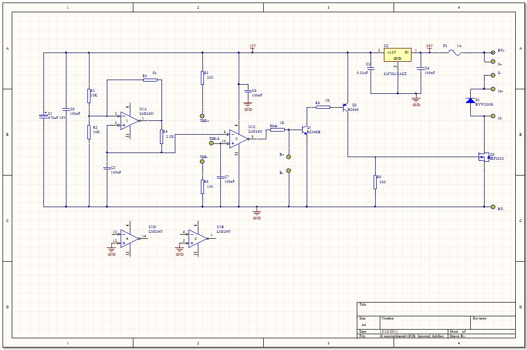

Need advice!!!
This is the schematic I made, I tried the previous schematic but it did not work, specially the drive circuit.
The mosfet was not switchign on properly n so was heating up. A friend of mine told me to put this circuit with the 2 BJTs. He did no know the theory behind it bt told me that i will work. And it did. I do not know how and why it works, nor do i know the calculations.
Could I please ask you to explain me a little how this circuit works and how the two BJTs work well for the Mosfet driving. By the way, the frequency I am operating is at 80Hz and the scooter is able to run well without the mosfet getting hot.
PS: R4 is 5K, not 2.5K
When the output of the PWM goes + Q1 turns on and its collector goes to ground, turning on Q2. When Q2 turns on its collector goes + turning on the FET. I think I would add a 10K from Q2 base to emitter to help it turn off faster.
For Q1, did you mean the Emitter goes to ground?
When you say adding a 10K resistor from Q2 base to emitter, do you mean adding it between the 12V supply and emitter? Sorry, I am a little confused
From the schematic Q1 emmitter is attached to ground. So when the transistor is turned on the collector is also at ground or 0 volts.
Add the resistor from base to emitter. One end to the base the other end to the emitter.
