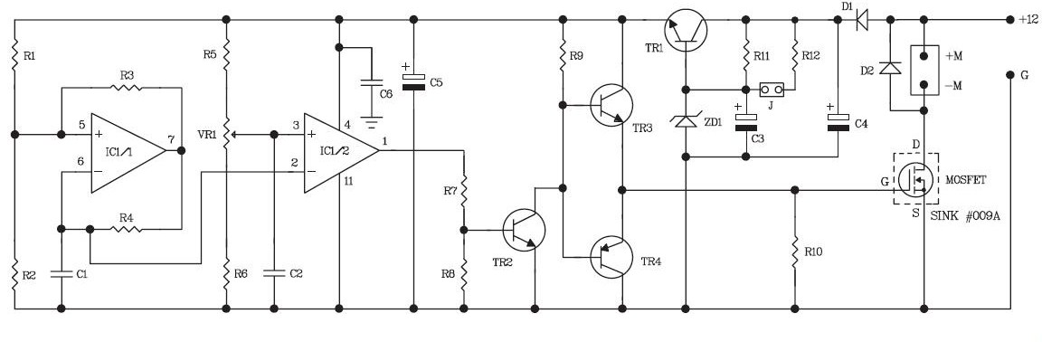

Hi everyone
This following schematic is of a 24V DC motor speed control circuit that can handle a little bit over 10A.
Could anyone help me in the basic understanding of this circuit, how it works and what do the main components do.
It'll be a big help.
If you need anything else please let me know.
PS: In the schematic, getting rid of the jumper makes it 24V. IC = lm324, TR2 & TR3 = 9013, TR4 = 9012, TR1 = BC547, Zener = 10V, Mosfet = IRF3205

The first opamp is a triangle wave generator which feeds the second opamp setup as a comparator this part converts voltage from vr1 into a PWM signal (pulse widith modulation).
The three transistors following the second opamp form the driver to drive the gate of the mosfet.
The other transistors and diode(s) form a regulator and can be replaced by a common 3 terminal regulator chip such a the LM78xx series depending on the current demand of the motor.
I could have gotten greater in detail but the schematic is to small to see while I am typing in the comment box.
But that is basicaly it in a nutshell.
jer :)
That's a good explanation, geraldfryjr. I'll just add, in case the OP doesn't know, the purpose of the PWM or vairable duty-cycle produced by IC1 & IC2 is to effeciently provide variable drive for the motor. It's a common technique.
Its just a PWM circuit (common one) which drives a mosfet. IC1 produces a square wave at out put, here in circuit the triangular wave generated by the capacitor charging/discharging cycle is used for generating the triangular wave. the second op-amp will act as a comperator which will create the PWM output, for which the duty cycle is governed by the variable resistor. the TR2 act as a drover for the next push pull stage using TR3 and TR4. the amplified signal is given to the gate of the MOSFET which will correspondingly generate higher wattage PWM for the fan. the circuit using TR1 is a constant current source (i think) for the proper working of the IC.
TR1 is a voltage regulator whose voltage is set by the zener diode in the base.

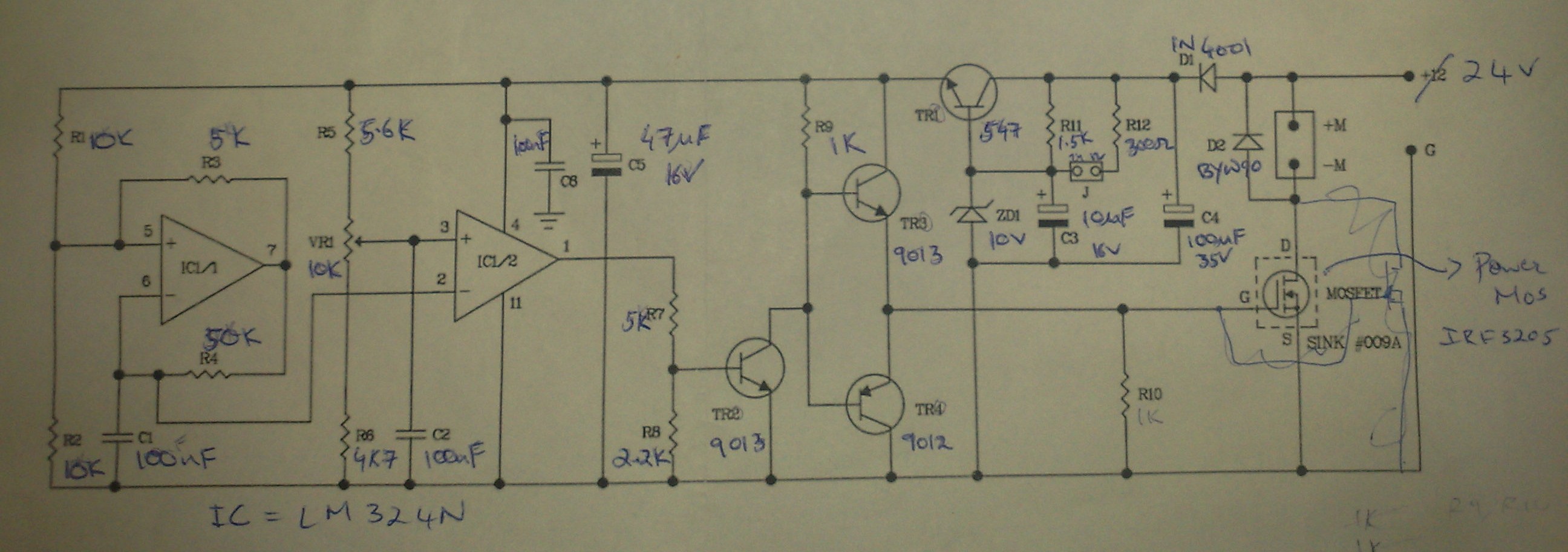

I am a second year electronic student and I am trying to build a motor speed control circuit for a 24V, 300W motor.
If it is not too much to ask for, as you guys have already provided me with such intense detail of the working of the circuit, I have the values of the components of the schematic, attached to this thread.
It is actually a schematic of a motor speed control for 12/24V motor with max current handling ability of upto 15A. Could you be able to guide me how to approach for calculating eg: the resistor values, what kind of output am I looking for out of IC1 and IC2. And biasing the transistors and mosfets, as these terms are still new to me.
I want to learn as much as I can about this schematic's working and its calculations for component values and component choice.

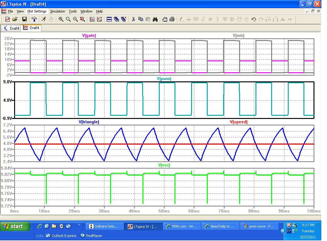

Pwm
Here is a simulation of your PWM. Slight difference in components, but same functionality. See what questions it raises.

lol thanks loads - geraldfryjr, i hope you do get your old circuit out :D... i am trying to build this circuit only, only problem is I cannot get the 9012 and 9013 transistors... or any other like those, would you be able to recommend any transistors specific to this or can i use any transistors?
by the way, i am trying to work out the frequency for the oscillator(IC/1), the frequency is set by the values of R4 and R2 someone told me... is that true? and if it is, what is the formula to set the frequency, if u know?!
I used common BJT's for the tranistors.
2N3904 and 2N3906 types that I got 15 in a pack at radio shack for $2.
Their numbers or not critical as they are just used for hard switching.
The formula for the frequency is " 1/(2RC) " as this is called an opamp relaxation oscillator.
https://www.electro-tech-online.com/custompdfs/2011/09/Exp_9_OP_Amps_v08.pdf
With the values shown in your diagram the frequency will be quite low,50k ohms and 100uf.
A .1uf capacitor with a 50k ohm resistor would give you a frequency of about 100Hz just to give you an idea.

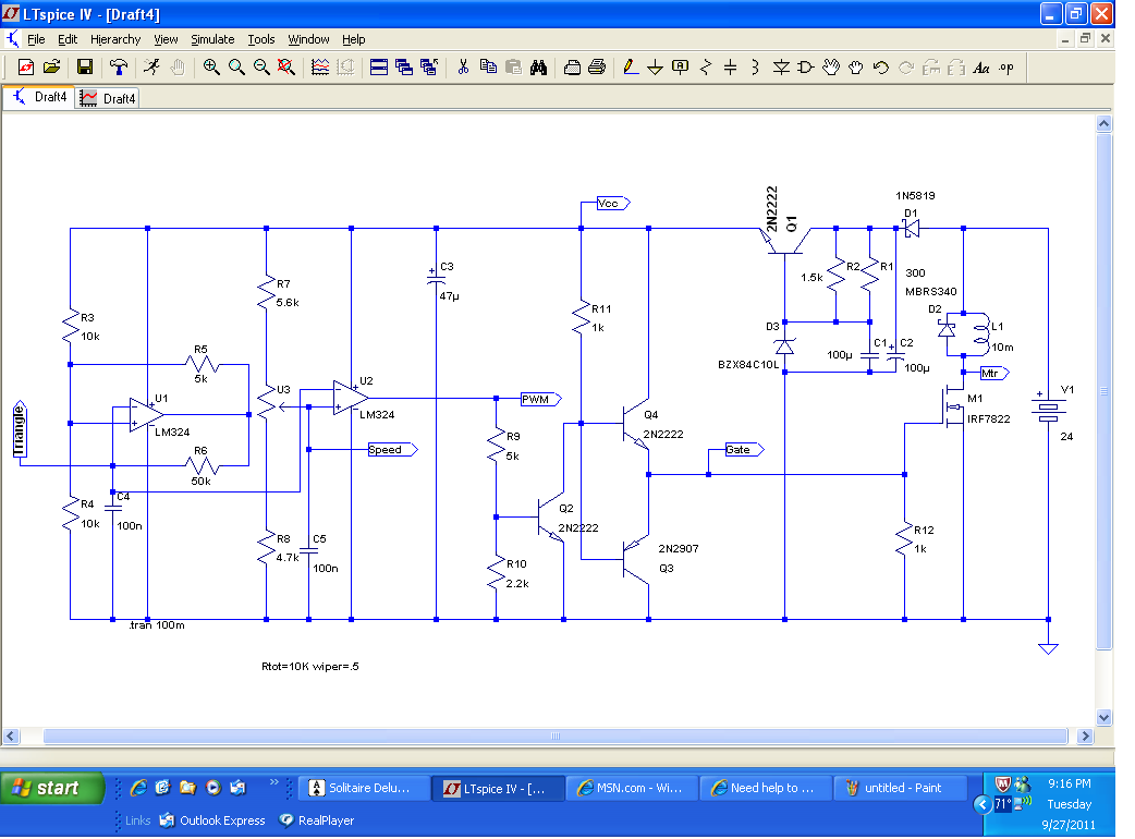

ronv, is it possible if you can load the LTSpice schematic file? I am having some problem putting some components in the schematic.
Pwm
Here is the asc file for the PWM. The only problems you might have are with the 324 or the pot. They are the only imports that weren't in the original spice library. If you don't want to mess with trying to get the models you can replace the pot with 2 resistors and almost any op amp will work.
On the FET issue:
The FET is capable of switching much faster if you want it to, however the LM324 is not very fast so if you want to move the frequency up to say 20KHZ you should change it with a comparator as mentioned earlier. As to switching frequency Jer's answer is almost right. During the turn on and turn off time of the FET there will be a point of maximum power dissipated in the FET (If the load were resistive this would be the half way point). This power, which can be quite high, needs to be added to the steady state power when calculating the total power dissipation in the FET. Since this only occurs during switching the time is usually very short (nanoseconds) so it doesn't make much difference if the switching rate is low, but it can become important if the switching frequency gets high since it happens more often.

this is the schematic i made but i think i got the equivalent pot wrong.
