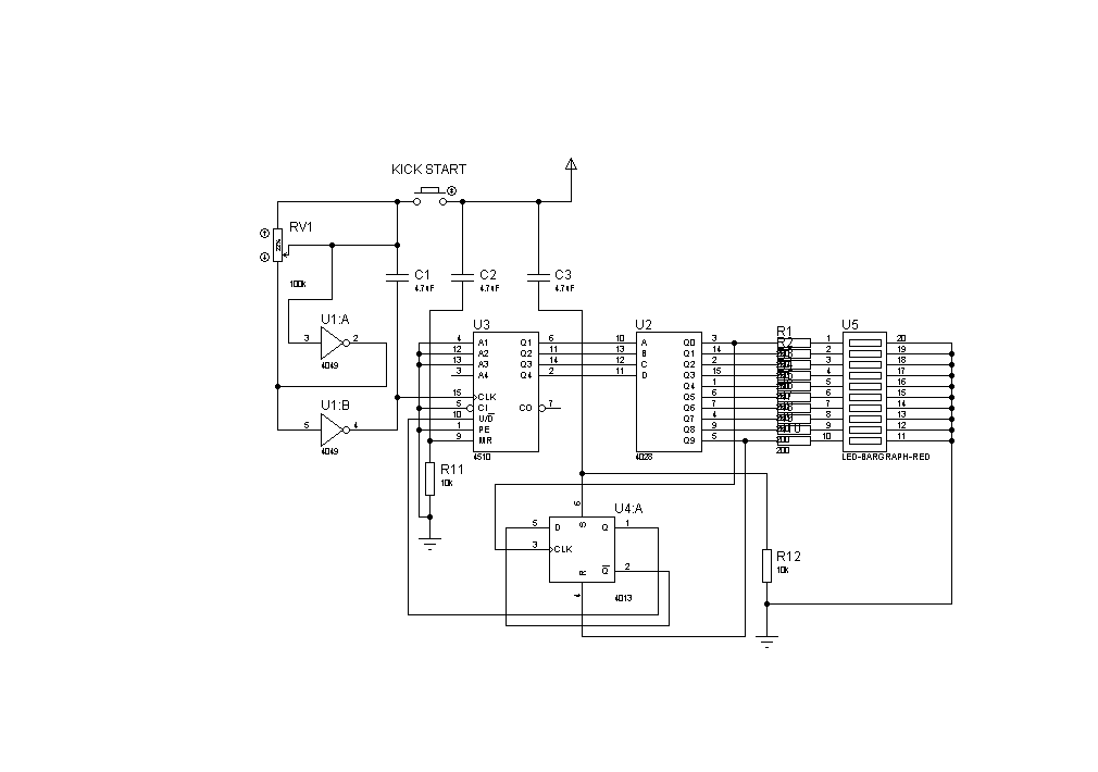

Like I said... in ISIS when the pot is one extreme the leds sweep fast and then when its at the other it sweeps slow. to make it go back and forth you need to hook the flip flop to the up/down input of the counter....However! i put 200ohm resistors on the led pack and ....You're right that's what the flip flop is for..
Back and forth the pot slows it down then speeds it up
Ian - that is terrific. It is good to know the schematic is (mostly) correct. Could you explain exactly how I need to alter the circuit to make it work how I want? Or better yet, can you provide a screenshot of the schematic you created in ISIS?
Again, this is all new to me, so I need detailed info :)

Sorry Kyle...I'd gone to bed when you last posted, 11:30 here the sims at home. So I;'ll try and draw it again here at work.
Right here we go... The kick start is just for ISIS ( simulations have no dynamics )
Oh and the bar graph in ISIS is ten led's not 8 so adjust to original design

Thank you Ian. I am running to the store today to get some 200 ohm resistors and then I will set my breadboard up just as you've laid it out. Hopefully I will get the same result you did!

well, everything works perfectly except the LEDs still only light in one direction, not back and forth. I checked the voltage at Pin 1 of 4013 and it was a constant 9v.
The voltage at pin 10 of 4510 bounced all over the place, from near 0 to around 6v.
Any suggestions?
