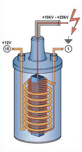

Ignition coils have three connections only. The primary and secondary windings use common ground.

May be they're made different in the USA and Canada. This is the setup of a European ignition coil.
Please not that primary and secondary windings are connected internally for ground. The cases of those ignition coils are not connected anywhere.

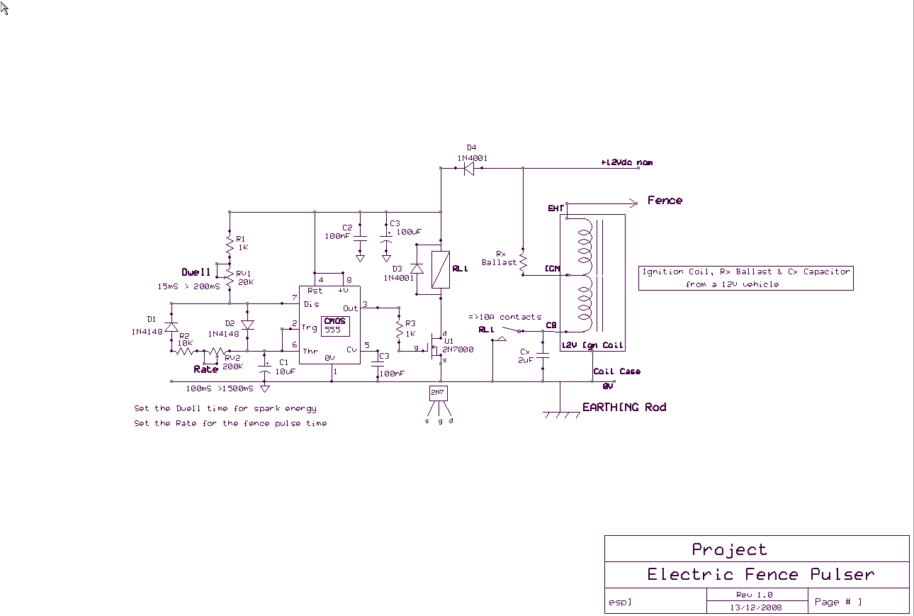

This fence works OK, uses an old 12V vehicle ignition coil and ballast resistor.

There is also a More Powerful Fencer:
But Depending on How Long your fence is, Neither of these may work for you.
Really Long Fences are a Problem, When using Car Coils.
E
Relays are not very good for driving car coils.
The Relay contacts get Pitted very easily over time.
A Direct Mosfet Drive is Better.
Also there should be an Off Time (DEAD TIME) between Pulses on Electric Fences to prevent a person or animal from getting STUCK to the wire.
