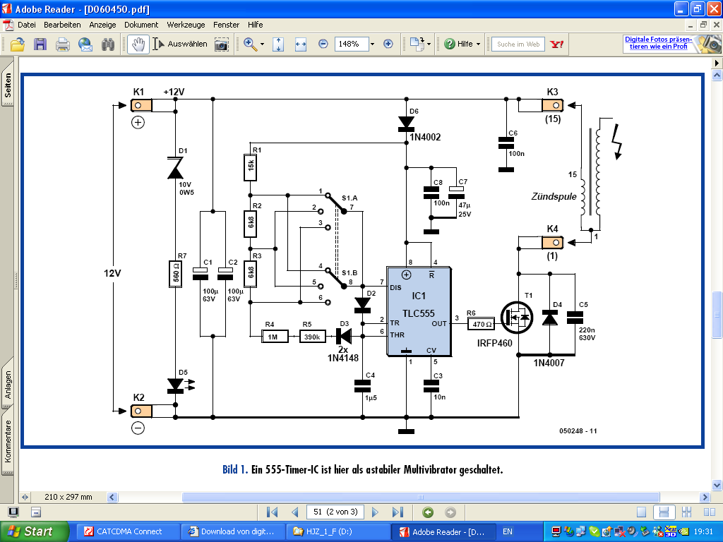

Hi Hrishilkesh,
I read all the posts and the danger involved using an electric fence. If you just want to keep animals out of the fenced in area I assume that they are able to climb the fence. To electrify the top the fence won't hurt birds. They have to touch the HV-wire and earth simultaneously which is kind of impossible with their short legs.
Here is a circuit which is also used for cow fencing in Germany.
It consists basically of a timer circuit activating an ordinary ignition coil at regular intervals. The shock power can be set to three different levels starting at 250mJ up to 450mJ.
The circuit uses a CMOS-version of the NE555 timer, because of the relatively high capacitance an NE555 would have to have for the same timing.
The ignition coil should ideally be one used for electronic ignition circuits with a resistance of 0.7Ω.
To ensure proper function at all times the circuit uses a dual switch to select pulse timing. If the circuit fails and the timer output stays high the switching transistor and/or the ignition coil will fry. Therefor the fuse is mandatory.
If the circuit is made properly it should put out pulses of 20 to 25KV, high enough to keep the animals off the fence.
Hans

Pondering the schematic posted by Hans, I realize (I think) that this circuit uses the ignition coil in flyback mode, as it is traditionally used in an auto, not as a transformer of an input pulse. That is, prior to the pulse, the primary circuit is completed from the 12V bus through the primary to ground via the MOSFET, thus magnetizing the core. The HV pulse is then generated when the primary current is interrupted by the MOSFET turning off. The significance of this is that the energy of the pulse cannot be controlled by varying the size of the capacitor feeding the primary, since the energy is fixed by the degree of magnetization of the core at the instant the "points" open, not in the capacitor feeding the primary. Pulse energy level can, however, be controlled by varying the voltage (and, therefore, the steady-state current) in the primary prior to opening of the primary circuit.
I think there are efficiency losses in this type of circuit because the primary current will flow longer than is actually required to magnetize the core while waiting for the opening of the "points." Perhaps one of the newer SMPS ICs that detect primary current as it builds up to an adjustable value could be beneficially used here. Hmmmm. Pulse repetition rate could be controlled by supply voltage and energy level controlled by current sense.
Not actually claiming intimate knowledge of ignition or SMPS circuits.
awright
