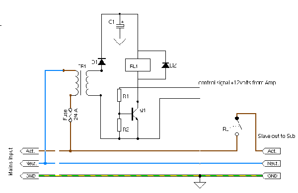

I got a Rotel RSX 1055 AV receiver with a couple of 12V trigger outputs. I would like to use one of them to switch on my sub's amp. The sub has a Hypex 200 amp build in which delivers 100 W into 8 ohms. AC current where I live is 220 Volts.
Although the amp has a sensor input that detects bass signals, it reacts too slow or sometimes doesn't come on at all. There's a three way power switch on the amp I-on; 0-off; II-Standby=sensor enabled.
Unfortunately, Rotel's manual doesn't say what the 12V trigger output does when switching on the receiver. So I need to know how to build a relay that can replace my sub's power switch and uses the receiver's trigger signal. Can anyone give me some pointers? Thanks a million!

I've simplified the circuit for you, this should do for what you require......
Obviously the relay will need to have a 12v coil and suitably rated contacts for the sub woofer full load current, the transformer isnt critical, the secondary needs to provide sufficient current and voltage to energise the relay, 9v ac should be ok, make sure the primary suits your local supply. Make R1 around 10k and R2 somewhere around 1-2k.....Play around with the values such that the circuit switches as you add/remove the control signal.
the diodes are 1N400 series and the capacitor around 470mfd with a rating of around 16-25v dc......

:roll: Wow.....I'm speechless.......Thank you very much! That's very helpfull of you.
May I ask why manufacturers use an opto couplers instead of a transformer? It was mentioned in the article you showed me and also, Rotel mentions this as a device they use in their sensing circuits on their amplifiers. Should I use an opto coupler? I'm very finicky about my equipment and prefer the best solution without going overboard :) Like to hear from you.
Thanks again!
The opto-coupler will provide galvanic isolation between the eqpt and the switching unit.......
The led side is illuminated using the control signal, you will need to calculate the resistor value to determine the appropriate current for the led. connect the transistor side to the base circuit of the transistor in the switching unit.....again you may need to play around with r values.....
Best of luck! :lol:

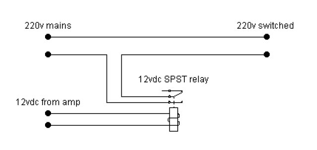

Sounds like you need a switched 220 line for your booster amp. If I understand you, the 12vdc is a switched output - possibly switched from a remote control. So, when you want it - you get 12vdc. How 'bout this?

Gene: I think Chippie has the correct solution because he uses a circuit that employs the 12V signal as a trigger signal. (Which it is) I'm not a big electronics buff, but from what I understand about trigger signals is that they're usually too low in current to supply continuos power to operate a relay.
Chippie: From what I can read from your schematic, it uses a transformer to supply the power to the relay and a circuit with a transistor that uses the incoming trigger signal to activate the relay. Am I correct?

When you contact the manufacturer you might want to discuss the 12 volt output. It could be anywhere from enough to 'trigger' a 12 volt screen motor to a few milliamps. I would have expected the output rating to be labeled on the amp jack.
Thanks again guys!
Yes, The transformer is there to provide power for the relay etc....
