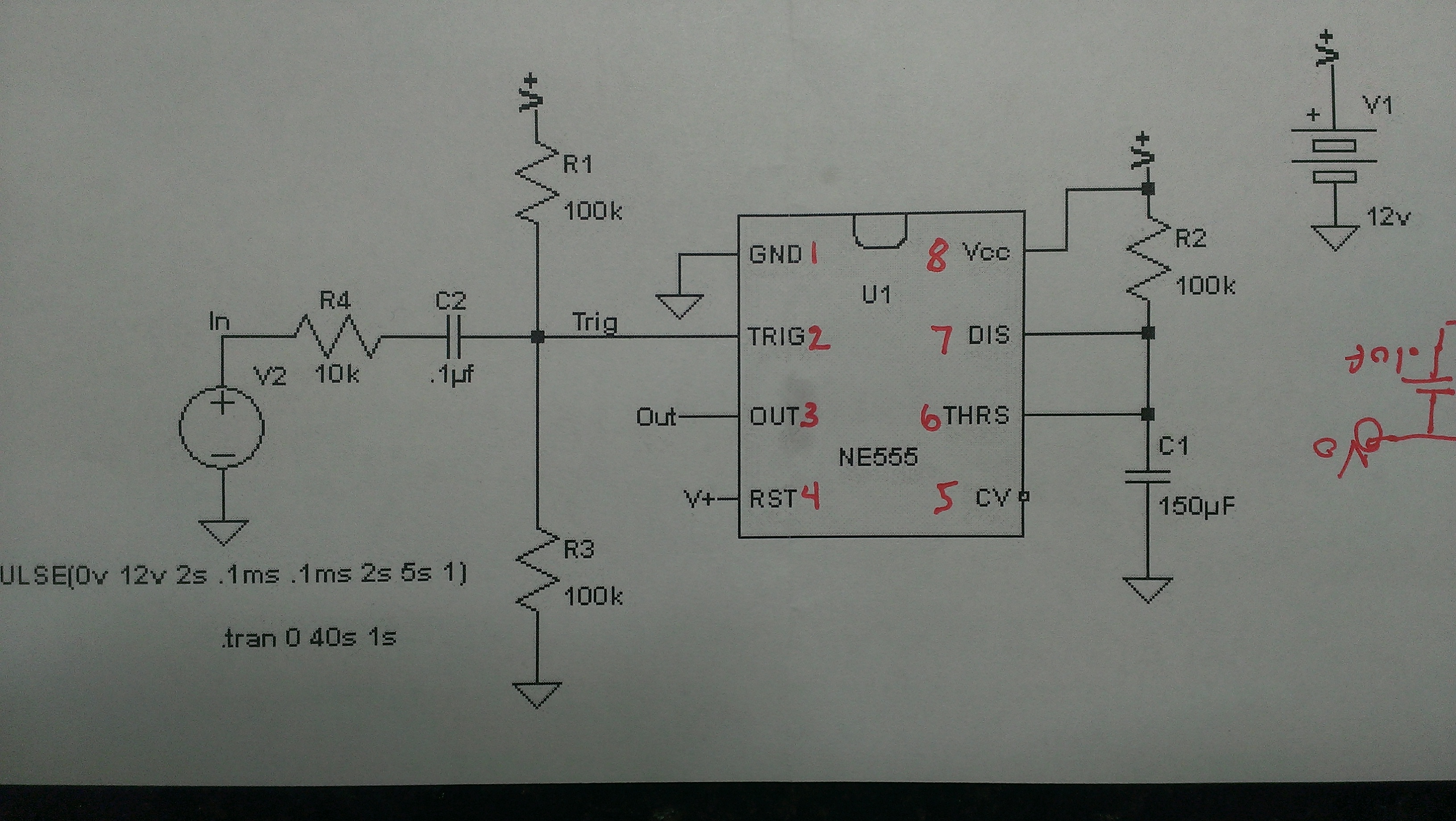

Hi everyone, I have a timer circuit that is going to power my arduino micro and a relay. I am going to run the 555 output to a 7805, or 7806 reg. The nominal relay current is 120ma, and the Arduino is 22ma running code. Do I need to need to run a transistor between the 555 and the 7805, Or will the 555 output be sufficient for the voltage regulator. I have some TIP32AJP PNP power transistors 3A TO_220, but in my case, the smaller footprint is better. Not sacrificing reliability, but not over kill either. Here is the circuit, I'm sure someone will recognize it. Thank you

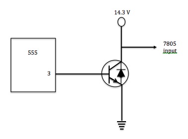

I guess the TIP is a little over kill. Now that you mention it, I have a couple dozen 2n4401's that spec real similar to the 2n2222. Is this what you had in mind? Thanks
No. As you have it shown the transistor will act as a dead short across the power supply, which will kill either the transistor or shut down the power supply.
For an emitter follower, the supply connects to the collector, and the load (your 7805) will connect to the emitter.

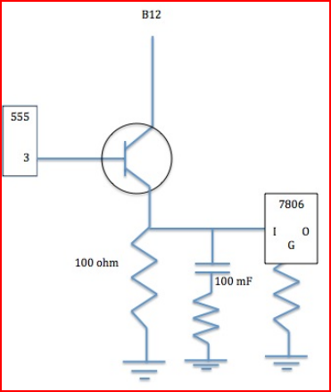

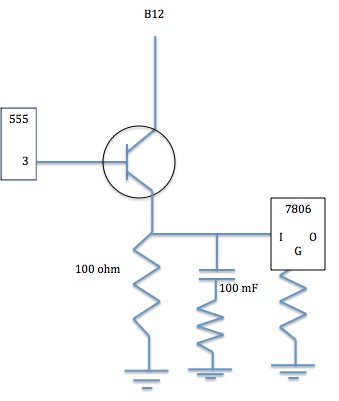

The power off circuit will be directly connected to the battery, and the 555 switched by the ignition. There are 2 relays, but only one will be powered at time of power off delay. I had the circuit wrong, this is what I meant to do.

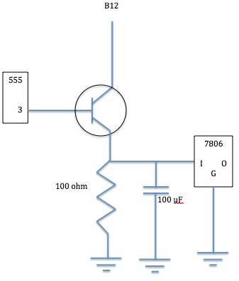

The purpose of the transistor is to provide a voltage source with enough current to drive the 7806 with out pushing the limits of the 555 output. I will be around 140ma running at 14.3 volts. The 555 will synch or source 200ma at 15 volts, I just want some headroom, and I've been told it will provide impedance matching. The 100 µf cap is just a filter. I was too lazy to use the correct sign, but I can see that could cause problems in electronics.
I didn't mean to put resistor looking squiggleys on that cap and the 7805. I got in a hurry.

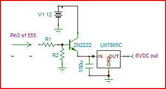

Try this instead:
R1 and R2 will need to be adjusted to accommodate the output level of the 555.
Why is R2 needed? The 12V from the 555 ouput is fine driving the NPN. Also, don't you need some protection so the 100uF cap doesn't destroy the transistor?
EDIT: With almost 12V at the emitter, will the transistor even turn on at all? Don't you need to drop some voltage at the collector with several diodes to make it work?
I honestly don't know why either resistor is needed at the base. The 100 uf cap should be a .33uf. It's just to level off transients. I have a couple circuits on my board, and I just can seem to keep this thread straight. A diode could be added to prevent damage on turn off, but I don't think thats what you were thinking.

Yes, a diode does need to be added to protect the transistor on shutoff. But the diode drops I was referring to at the collector are for something else.
An NPN can only turn on if the base is at a higher voltage than the emitter. Higher by the amount of B-E voltage drop (about 0.7V). This is why NPN's are used for low-side switching, not high-side switching like being done here. If the NPN is "full on" then the emitter voltage is only slightly below the collector voltage. So almost 12V. This means the base has to be at least 12.7V, which won't happen in your setup. And definitely won't happen with R1 and R2 creating a voltage divider.
So my thinking was to drop some voltage at the collector with diodes so that the emitter is low enough for the base to work.
